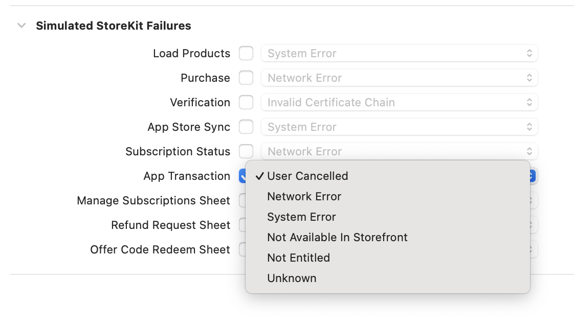

From the StoreKit configuration file:
These seem like generic errors to me, not particularly relevant to AppTransaction.
I can't find any documentation on them, or their applicability.

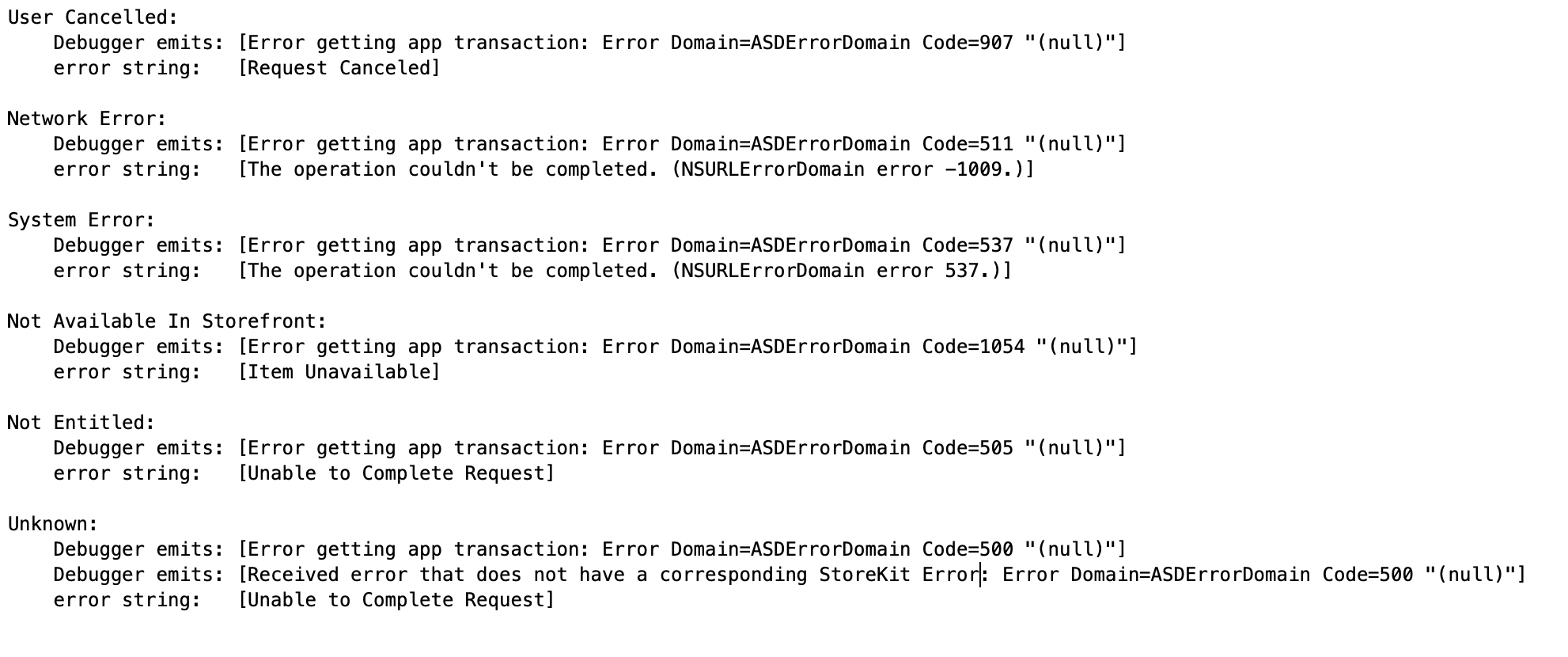

Here's what I found empirically. Importantly, ALL of them throw. Nothing returns a result, unverified or otherwise.
What are we to make of this (ignoring the inconsistency in the error number for Network Error)?
It's not possible to deduce much from the error strings, so do we force users to refresh() their store status for any of these error conditions?
