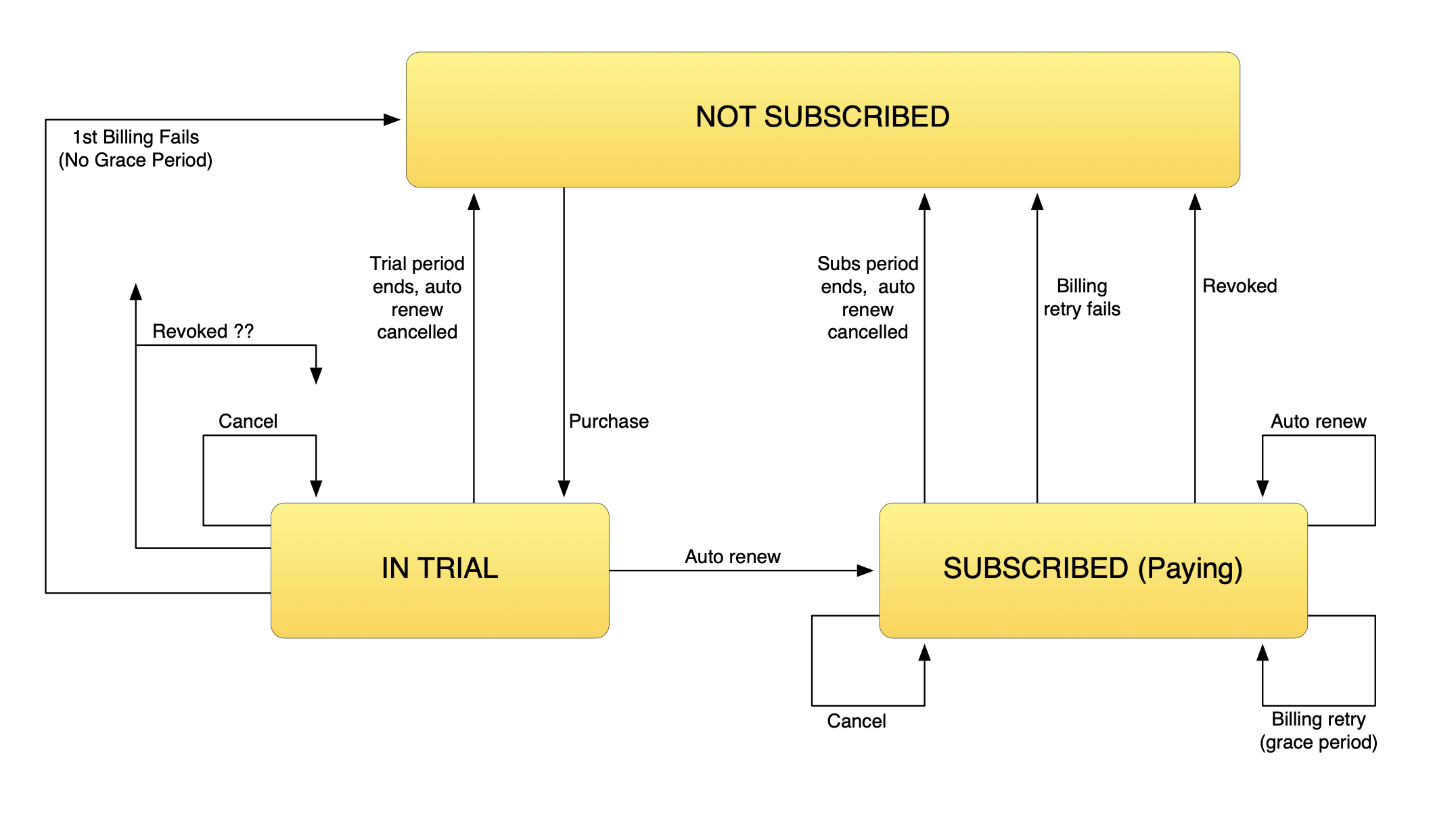

I've distilled the purchase/subscription situation into the diagram below. The boxes are a simplified notion of "state", and the arrows connecting them are in effect state transitions, caused by the labelled "events". Some of the content is empirical, gleaned from experimenting.
I want to be able to receive timely notifications in my app, of each event occurrence, so I can write rigorous (reactive) code to capture my business logic.

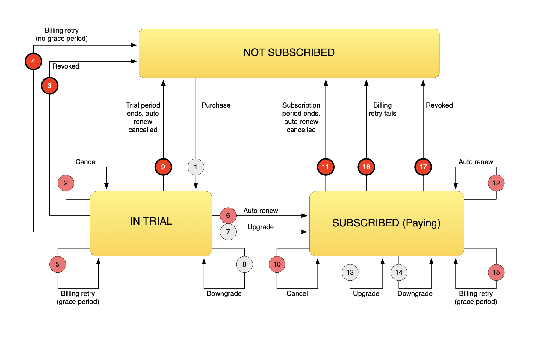

I've done some more rigorous testing and improved my state diagram. The diagram is more representative of what actuallly happens, but there are a few awkward edge cases to do with billing retry that aren't represented.
For each "event" I set up the testing conditions and monitored what happened. The red numbered circles are the events where I didn't receive any automatic notification, but could get the listeners to fire by manually restoring the subscription or restarting the app.
The dark red circles are the business critical ones. If I don't detect these, users will be able to continue using functionality they aren't entitled to.
Is there anyone out there with similar problems? :)
