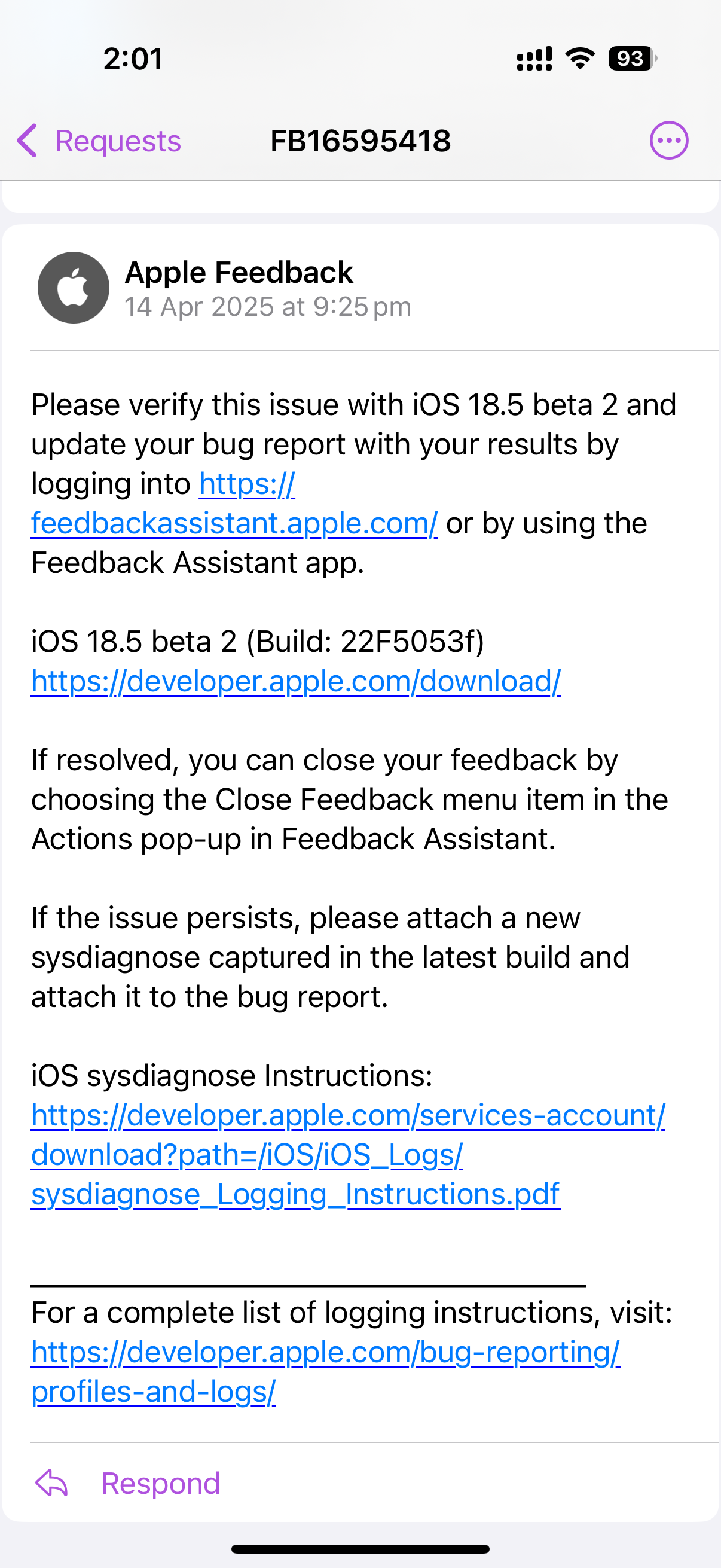

The release notes of iOS 18.4.1 only include the generic 'This update provides important bug fixes' but do not mention a fix for this. Does anyone know whether this got fixed or not?
Looks like it’s been fixed in iOS 18.5 beta 2
It's good to see that notification went out on time and, yes, the bug fix was specifically included in iOS 18.5b2.
