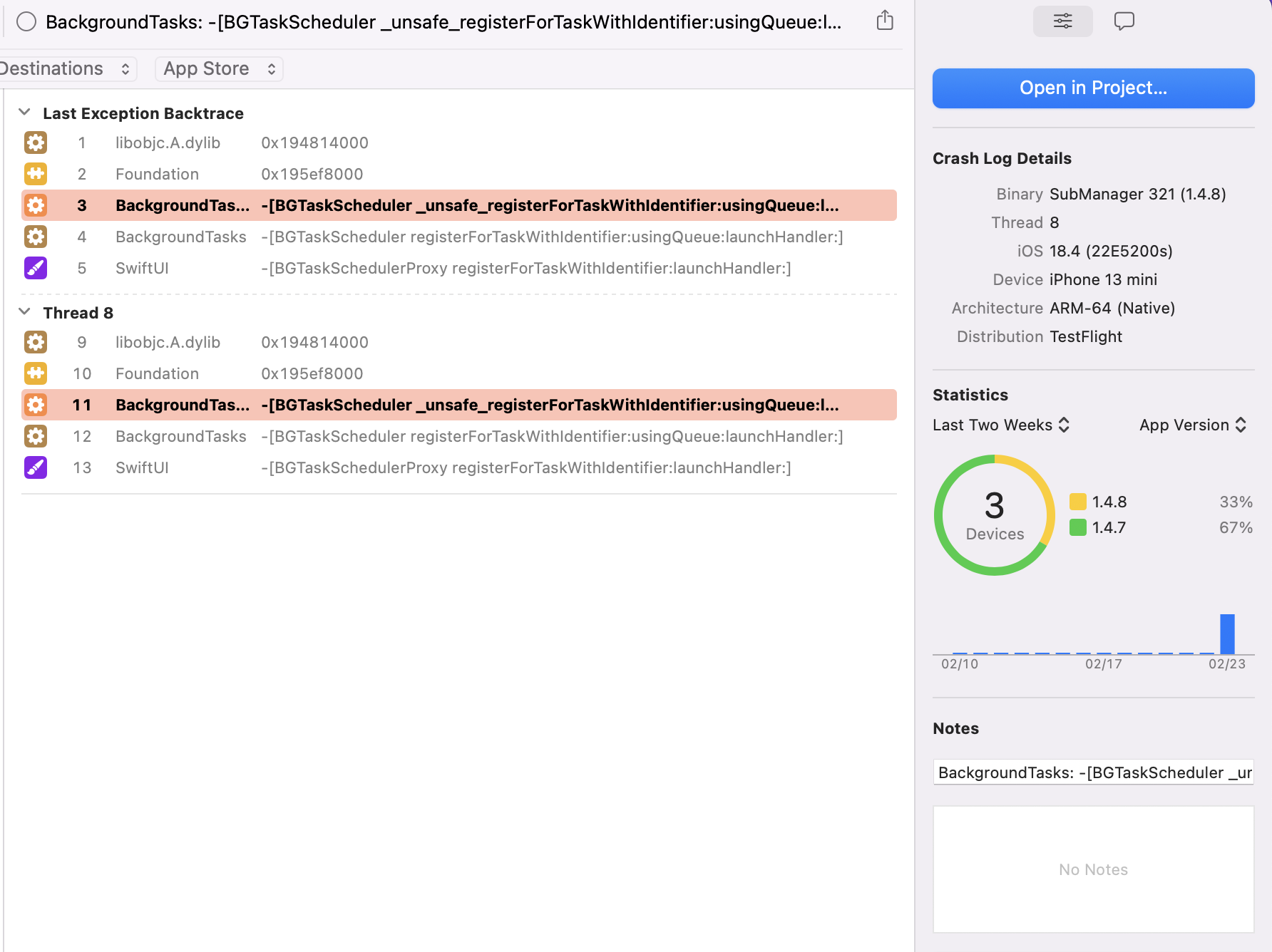

I've been seeing a high number of BGTaskScheduler related crashes, all of them coming from iOS 18.4. I've encountered this myself once on launch upon installing my app, but haven't been able to reproduce it since, even after doing multiple relaunches and reinstalls. Crash report attached at the bottom of this post.

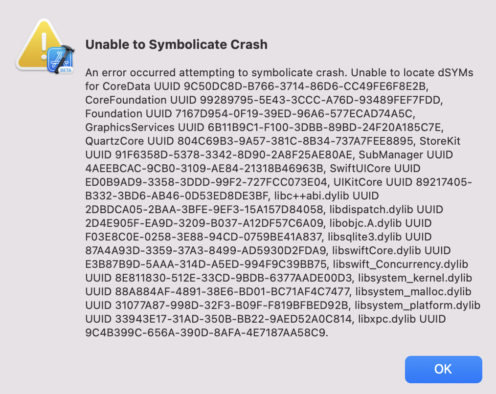

I am not even able to symbolicate the reports despite having the archive on my MacBook:
Does anyone know if this is an iOS 18.4 bug or am I doing something wrong when scheduling the task? Below is my code for scheduling the background task on the view that appears when my app launches:

I have just managed to reproduce the crash after quitting and relaunching the app about 100 times. The bug report has been updated with the sysdiagnose and a copy of the crash report.

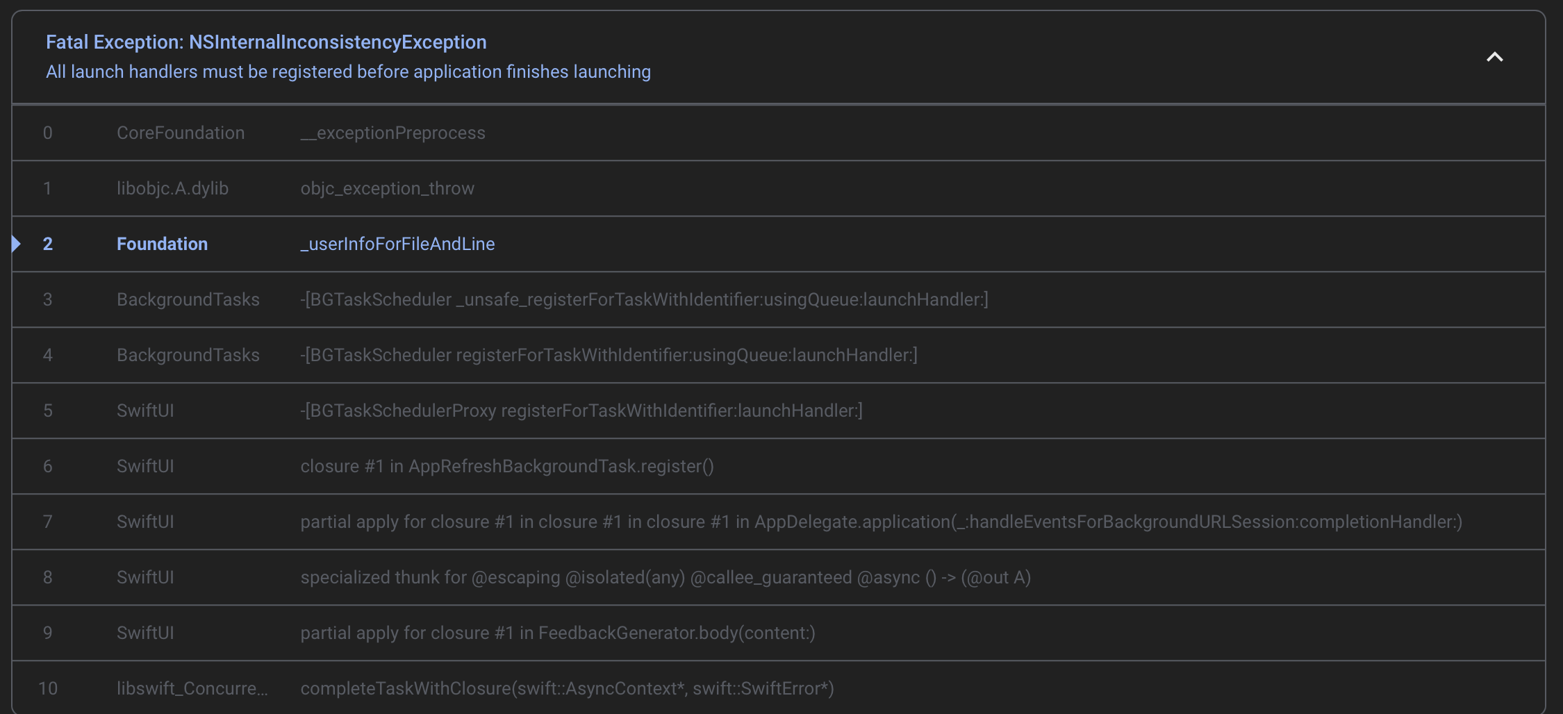

Failing to do so SHOULD crash your app with exactly this crash:
Fatal Exception: NSInternallnconsistencyException
All launch handlers must be registered before application finishes launching

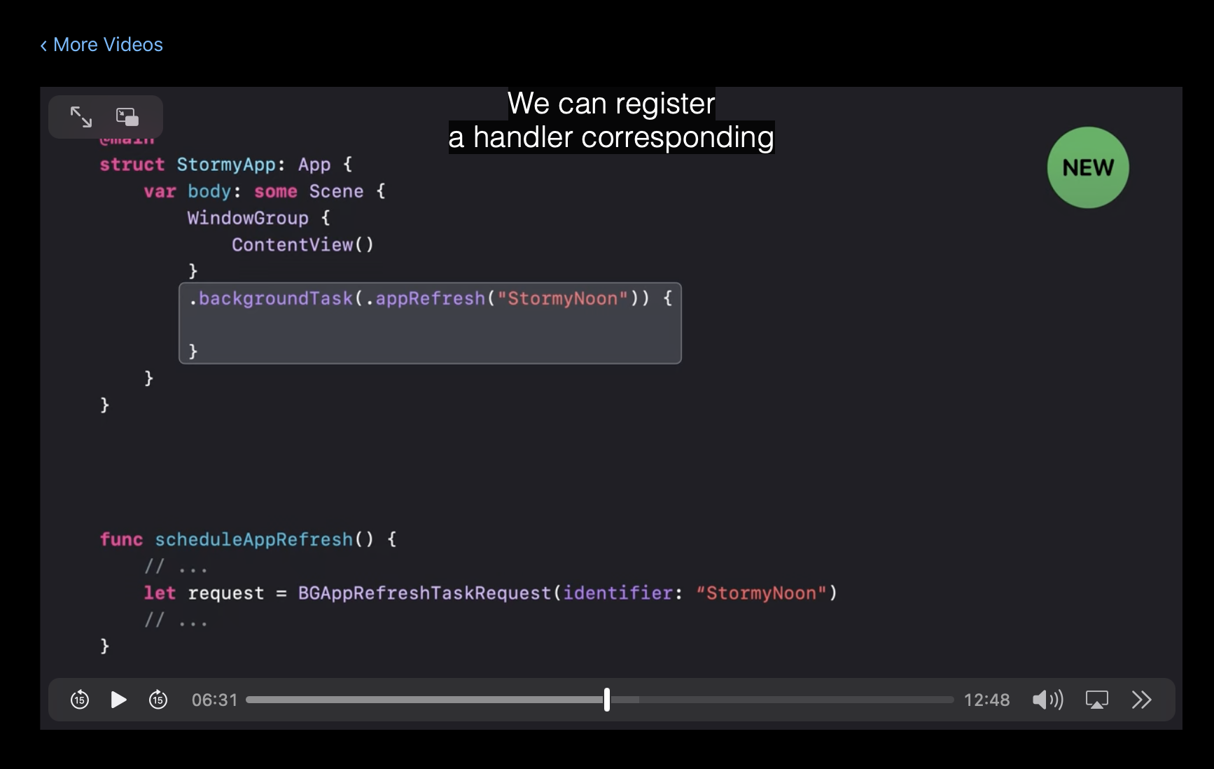

Thanks for the response. I am still a bit confused however. My understanding is that the .backgroundTask modifier is the replacement for BGTaskScheduler.register in SwiftUI. And the code that runs during the background task is part of that modifier. As per the WWDC22 video Efficiency awaits: Background tasks in SwiftUI, it is used to register the handler.
Also worth noting that the video uses a short ID similar to what I did.

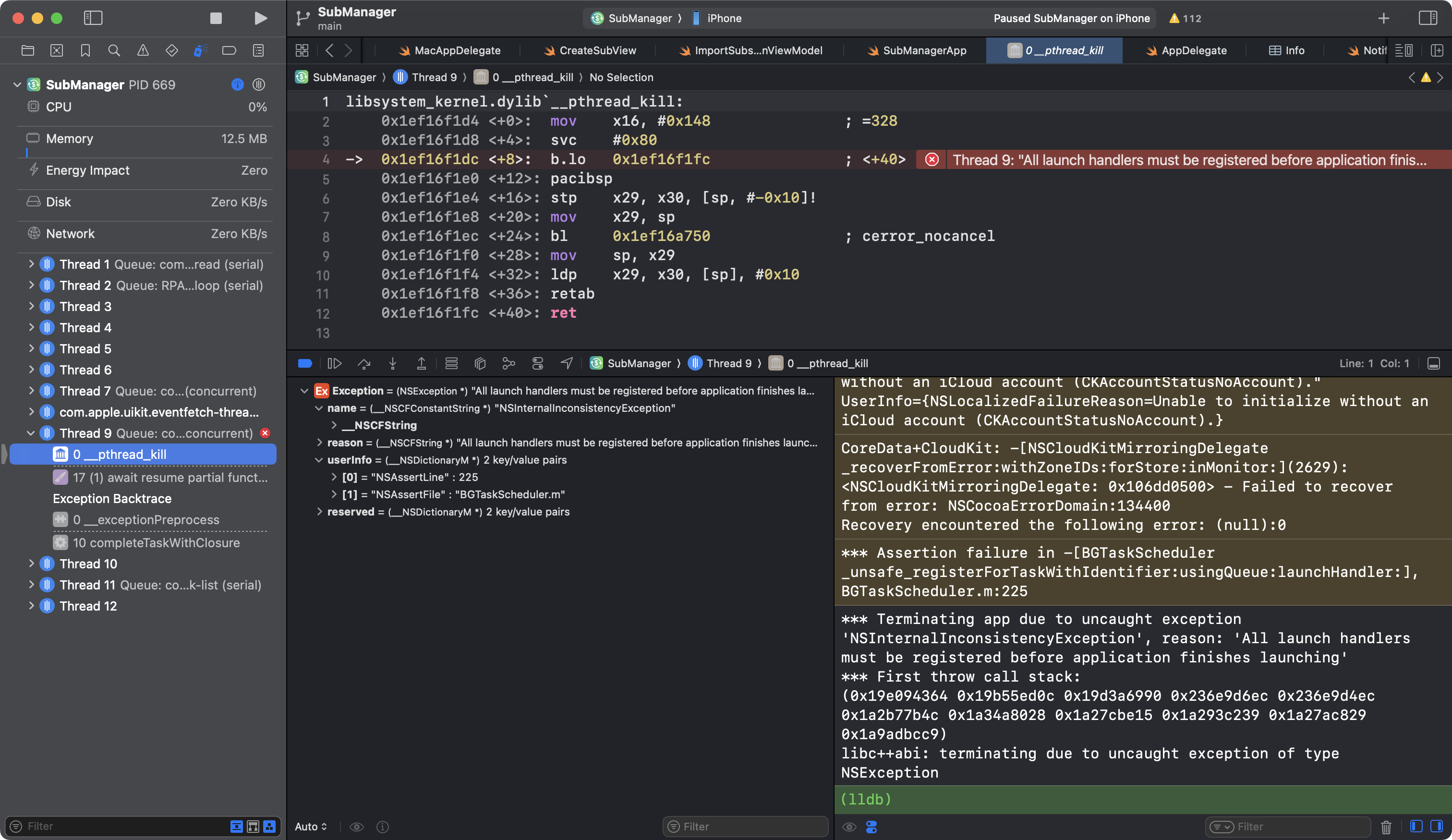

If I take out the modifier, the app crashes with this message:
*** Terminating app due to uncaught exception 'NSInternalInconsistencyException', reason: 'No launch handler registered for task with identifier notifications'
Which indicates that the modifier is indeed used for registering the handler.
There's no difference to this behaviour whether I use the short ID notifications or the reverse DNS com.ip18.SubManager.notifications. If the modifier is not there then the app crashes.
Interestingly when I simply killed and ran my app from Xcode multiple times, I eventually came across the All launch handlers must be registered before application finishes launching crash in one of those launches. Which is probably what the crash reports are about.
Attached a symbolicated crash report from one of those Xcode sessions to FB16595418. If I'm understanding this right, it looks like BGTaskScheduler registerForTaskWithIdentifier is already being called internally by the modifier.
Thread 2 Crashed:
0   libsystem_kernel.dylib        	       0x1ef16f1dc __pthread_kill + 8
1   libsystem_pthread.dylib       	       0x2281a3b40 pthread_kill + 268
2   libsystem_c.dylib             	       0x1a5f9c234 __abort + 132
3   libsystem_c.dylib             	       0x1a5f9c1b0 abort + 136
4   libc++abi.dylib               	       0x2280cd5a0 abort_message + 132
5   libc++abi.dylib               	       0x2280bbf10 demangling_terminate_handler() + 344
6   libobjc.A.dylib               	       0x19b560e48 _objc_terminate() + 156
7   libc++abi.dylib               	       0x2280cc8b4 std::__terminate(void (*)()) + 16
8   libc++abi.dylib               	       0x2280cfe1c __cxxabiv1::failed_throw(__cxxabiv1::__cxa_exception*) + 88
9   libc++abi.dylib               	       0x2280cfdc4 __cxa_throw + 92
10  libobjc.A.dylib               	       0x19b55ee74 objc_exception_throw + 448
11  Foundation                    	       0x19d3a6990 -[NSAssertionHandler handleFailureInMethod:object:file:lineNumber:description:] + 288
12  BackgroundTasks               	       0x236e9d6ec -[BGTaskScheduler _unsafe_registerForTaskWithIdentifier:usingQueue:launchHandler:] + 448
13  BackgroundTasks               	       0x236e9d4ec -[BGTaskScheduler registerForTaskWithIdentifier:usingQueue:launchHandler:] + 128
14  SwiftUI                       	       0x1a2b77b4c -[BGTaskSchedulerProxy registerForTaskWithIdentifier:launchHandler:] + 220
15  SwiftUI                       	       0x1a34a8028 closure #1 in AppRefreshBackgroundTask.register() + 344
16  SwiftUI                       	       0x1a27cbe15 <deduplicated_symbol> + 1
17  SwiftUI                       	       0x1a293c239 <deduplicated_symbol> + 1
18  SwiftUI                       	       0x1a27ac829 <deduplicated_symbol> + 1
19  libswift_Concurrency.dylib    	       0x1a9adbcc9 completeTaskWithClosure(swift::AsyncContext*, swift::SwiftError*) + 1

Yes. More specifically, "_unsafe_registerForTaskWithIdentifier" does two different checks when it runs:
  1. It checks how far the app is into the launch process and, if it's to late in that process, it crashes with "All launch handlers must be registered before application finishes launching".
  2. It checks if the ID has already been registered and, if it has, it crashes with "Launch handler for task with identifier <identifier> has already been registered".
...and you're obviously crashing on #1. Moving to here:
Based on the evidence at hand, I suspect the issue is that SwiftUI is sometimes registering the crash later than it should, triggering #1. That leads to the most direct solution (assuming you won't want to wait for a bug fix), which would be to stop using ".backgroundTask" and directly use BGTaskScheduler.register.
Also, as a quick clarification here:
Thinking of it as a replacement is somewhat misleading. SwiftUI's architecture is actually trying to provide a unified entry point across multiple frameworks for use cases that are particularly relevant to the interface. It does support BGAppRefreshTask, but it does NOT support the other task types (BGProcessingTask and BGHealthResearchTaskRequest) and, more to the point, all of other task types are totally unrelated to the BackgroundTask framework.
The reason for this is that it isn't actually trying to provide a true replacement. It support BGAppRefreshTask because the primary use case for BGAppRefreshTask is to update the user interface so that it remains current. That's the same reason it DOESN'T support BGProcessingTask. BGProcessingTask is intended to be used for work which requires extended runtime ("several minutes"), which is exactly the kind of work that wouldn't/shouldn't be directly tied to the user interface. Similarly, if your app refresh work is primarily tied to the "backend" of your app, it can be better to use the original register(forTaskWithIdentifier:using:launchHandler:) API instead of artificially creating a connection in SwiftUI that you wouldn't otherwise need.
