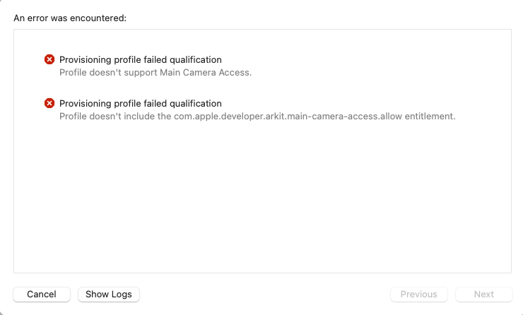

Can you help me how to upload it to TestFlight setting and distribution.
I have try it but got this error.
I have setting profile for camera access to but it still like this.

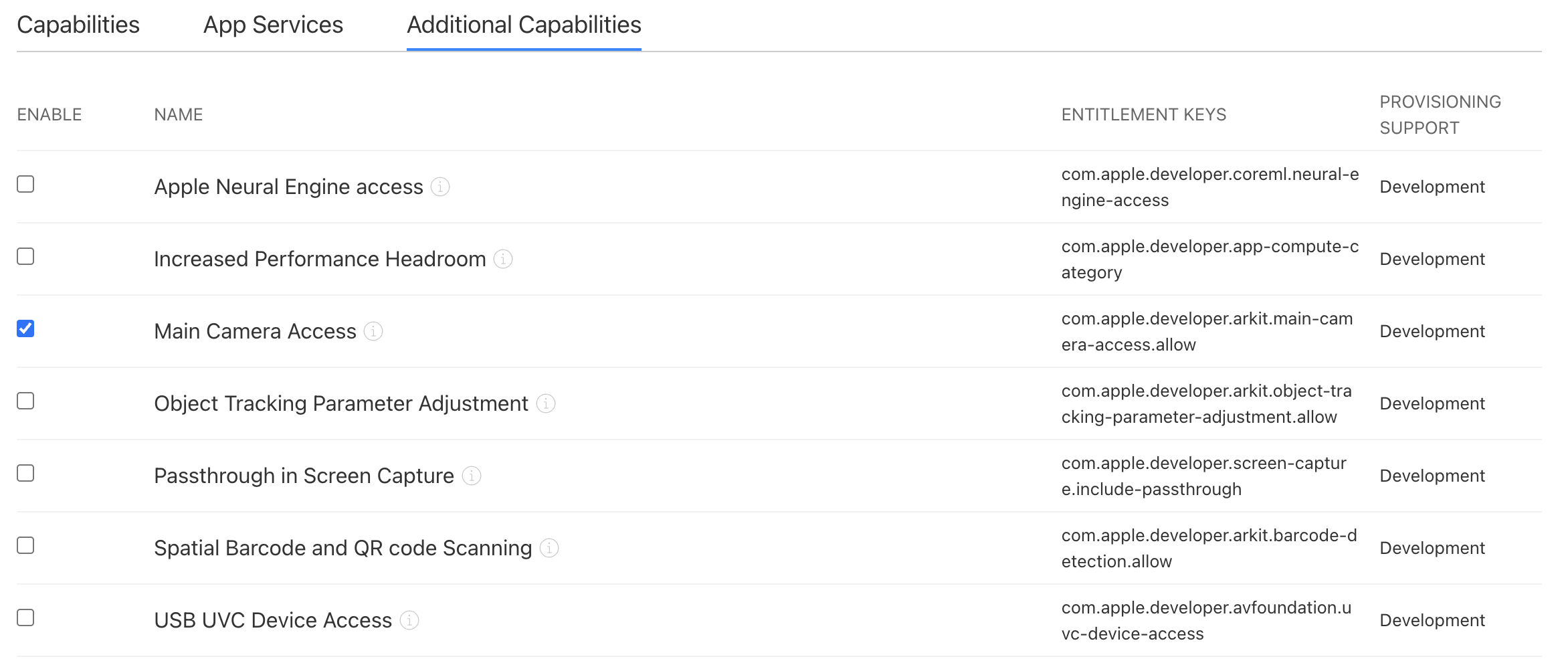

Are you sure that you were granted the Main Camera Access additional capability for distribution? I don’t know much about this specific capability specifically, but it’s really common for additional capabilities to be granted for development only, and then you have to apply again for distribution.
You can check this on the Developer website. See Finding a Capability’s Distribution Restrictions. For TestFlight distribution, you’ll need App Store.

No i have only development access, can i apply for the distribution for the deploy to testflight..?, i have tried it but still no reply for it.
OK. Well at least that explains why you’re having this problem.
You can certainly apply (-:
I have tried it but still no reply for it.
I’m not involved in the approval process for this capability, so I don’t have any insight into how long it will take.
