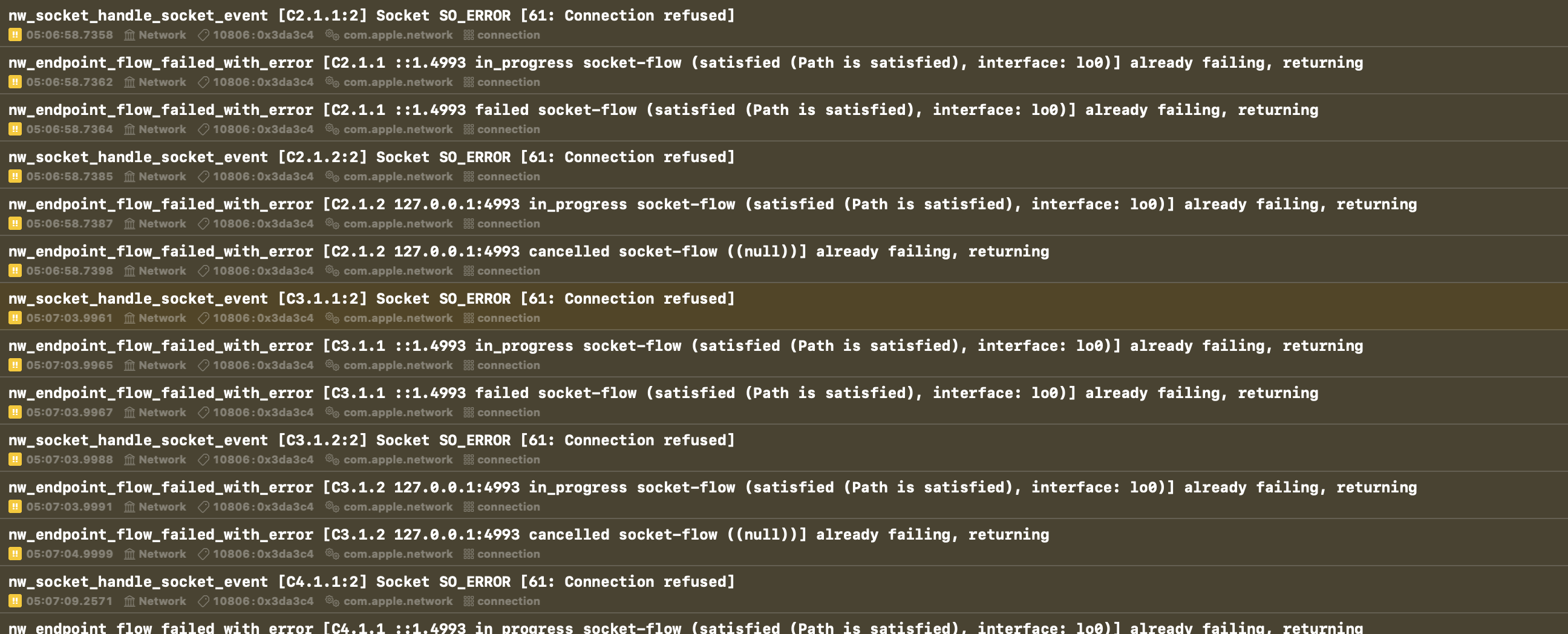

I'm establishing a connection with NWListener and NWConnection which is working great. However, if the listener disappears, a lot of logs are appearing:
Is there a way to hide these logs?

I don’t think there’s a way to attain your specific goal. While the system log gives you control over what gets logged — I have a lot of info about that in Your Friend the System Log — Xcode has its own mechanism for catching system log entries. This sees the entries before they make it to the system log, which means the decision as to what shows up in Xcode in entirely under its control. It has a default policy and then applies whatever filter you set up.

To me, it feels like the Network framework should provide an option to enable debug logging or not. In fact, it turns out I could do that for some of those logs:
let privacyContext = NWParameters.PrivacyContext(description: "Logging Disabled")
privacyContext.disableLogging() // Disable system logging for this context
However, there are still quite some logs emitted.
