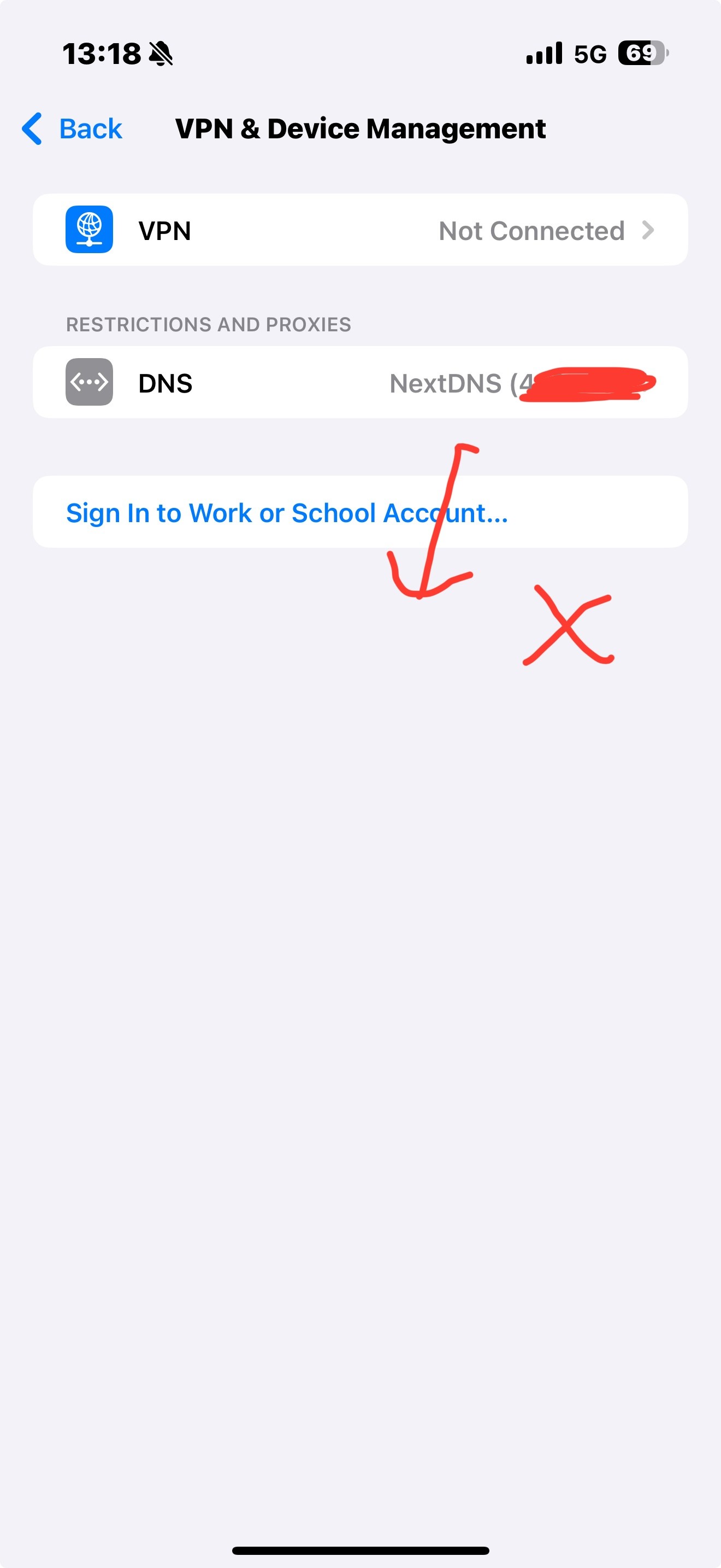

I've installed two different profiles and having no issues using them until iOS 17, 18.0 (certainly for 17, but not so sure for 18).
But after upgrading to 18.2 and even developer beta 18.3, installed profiles are not showing on the Setting / General / VPN & Device Management.
So I can't even uninstall, also I can't reinstall unless I factory reset by iPhone, iPad and not using iCloud backups.
First profile is DNS profile downloaded from website(NextDNS) and the second profile is made by my own, configuration for the cellular APN setting.
(DNS setting is shown on the setting but there's no profile showing, I did not uninstalled or removed it)

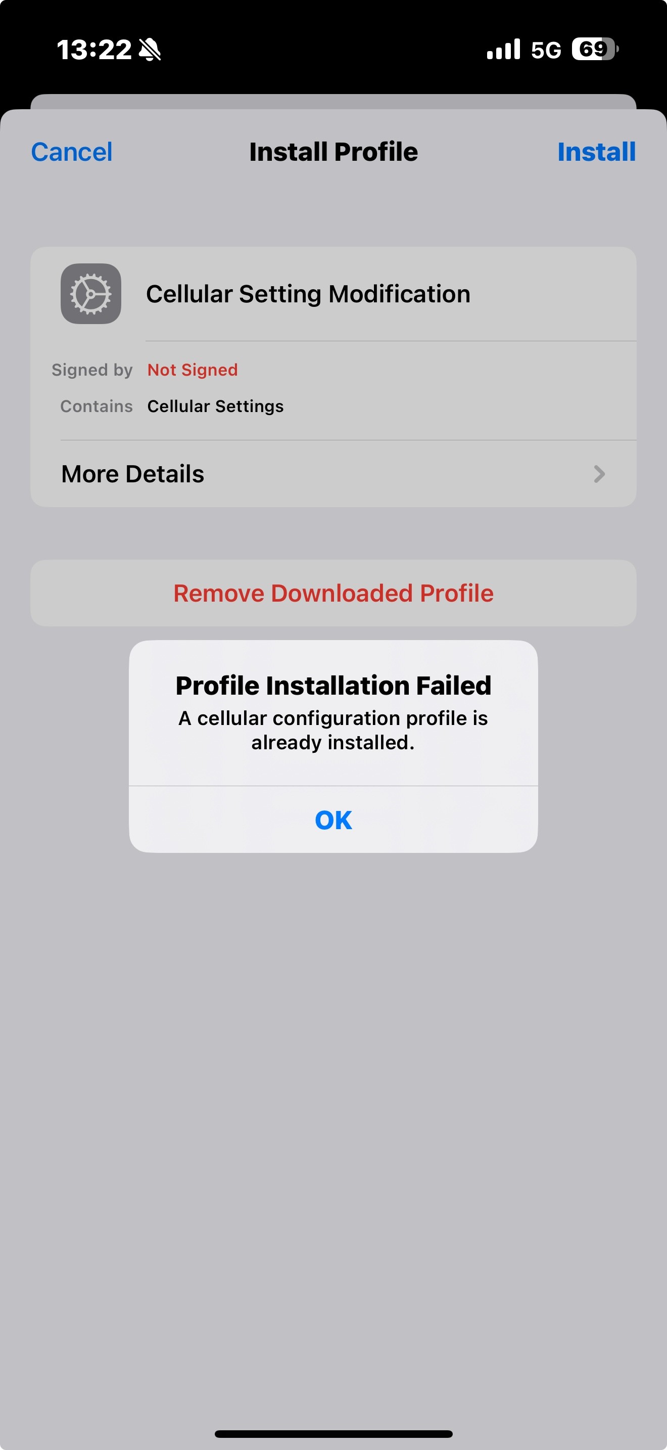

(Installing the custom celluar configuration profile failed, since it's already installed but just not showing as above)
All happens on my iPad pro M1 12.9, ipad mini 2021, iphone 12 mini(18.3, else are 18.2), and iphone 16 pro max.

For more information, those devices are not supervised nor logined with corporate & school accounts.
The developer forums aren't a good venue for investigating bug reports like this one. Please install the Managed Configuration logging profile, reproduce the issue, take a sysdiagnose, and a file feedback attaching the sysdiagnose and the profiles you're attempting to install. See this forum post for instructions.
Having the same problem here i tried factory reseting my phone but cause of back up they come back again , any solutions by any chance
