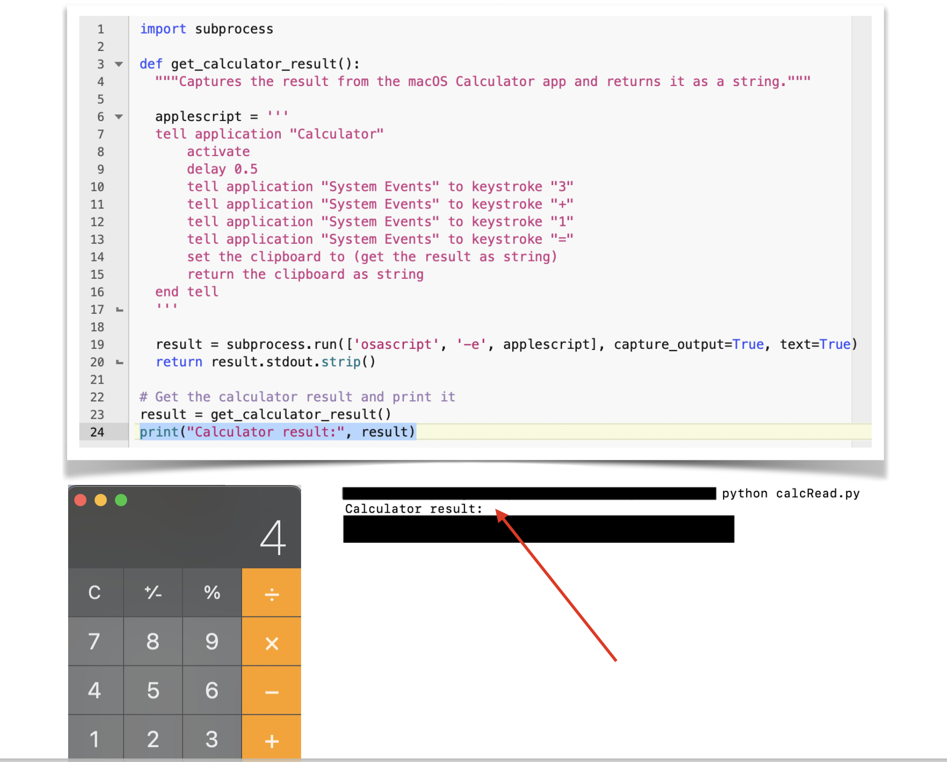

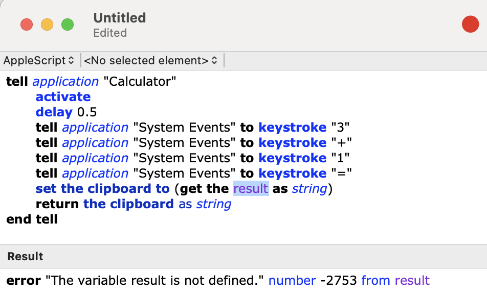

I am unable to get a result from a simple AppleScript calculator set of commands.
The calculator shows the right result, but I cannot capture the result to place in the clipboard and read it.
I also ran this in the script editor.

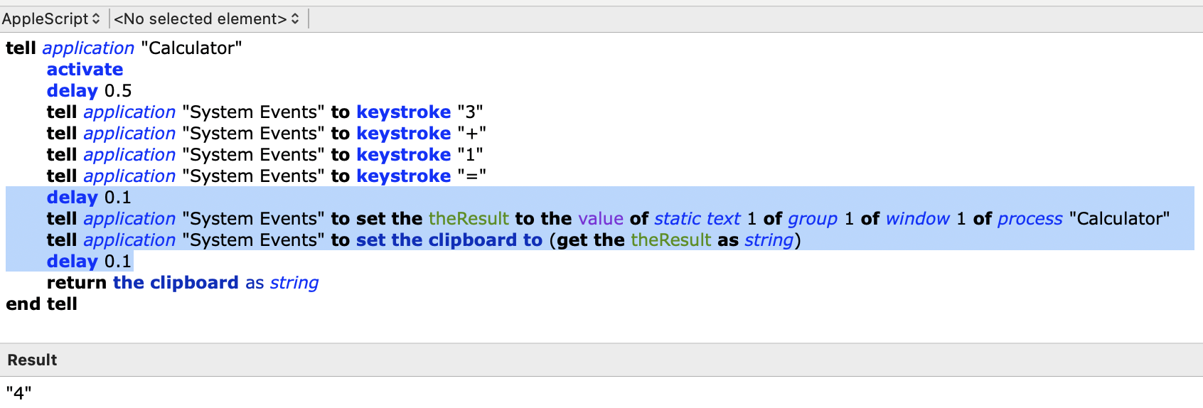

Answered by mrSFguy in 813927022
I got it to work.
The solution is to reference the item in the window and to stick a couple of small delays in at the end.
I got it to work.
