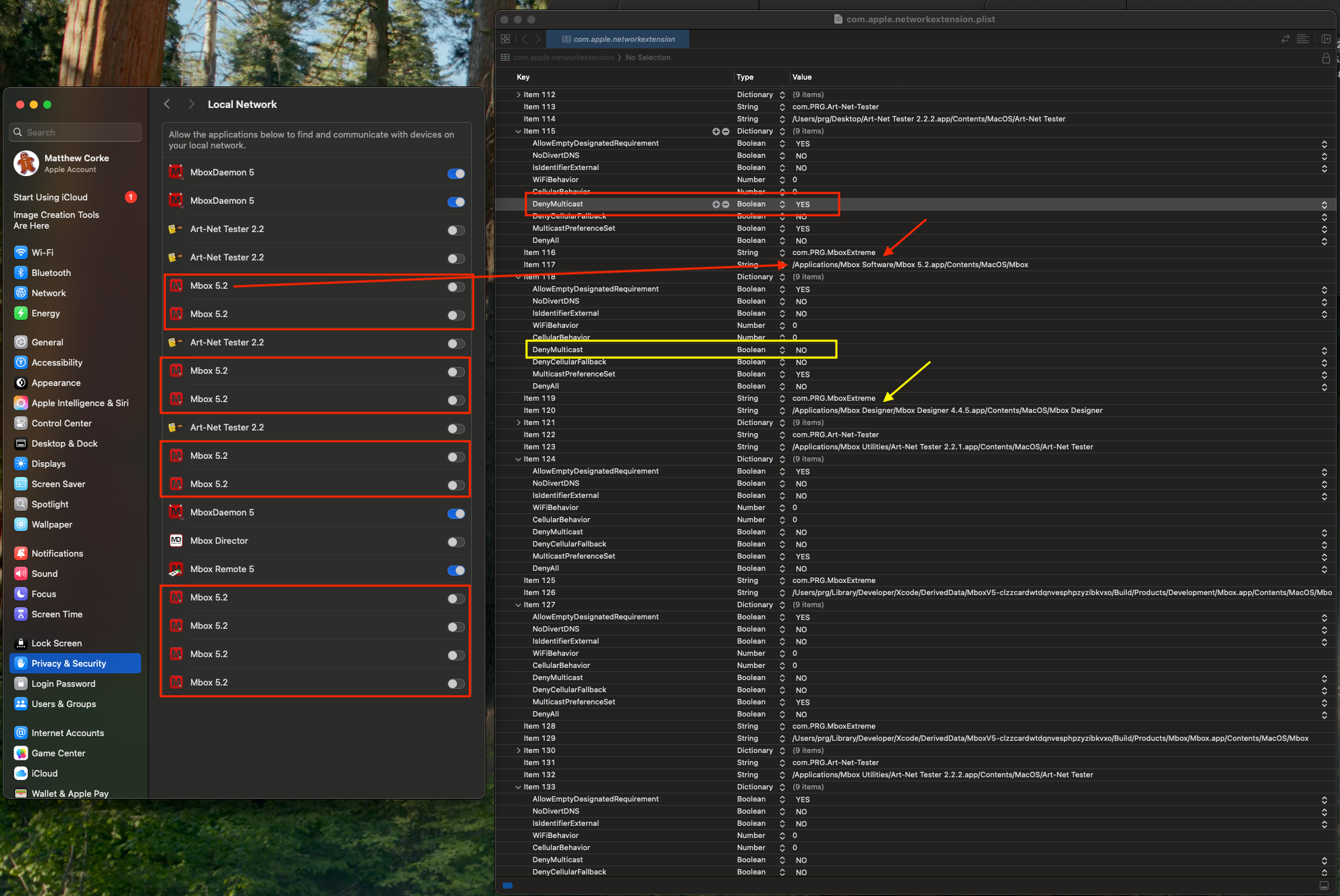

We have seen similar results to those seen by the OP and others. We have submitted a separate FB incident (FB16512666) with our information and observations. For the most part it follows what others have said, though we have more to add on the inconsistency between UI and the actual permission granted. There are two related screenshots for this, the first of which shows the UI when the Local Network permission is OFF for our application called "Mbox": In this image you can see 10 instances of an application called "Mbox 5.2", circled in red. To the right you can see the contents of the /Library/Preferences/com.Apple.networkextension.plist file that stores the data related to the permission granted via the UI. This plist holds entries for each of the 10 instances of the application in the UI, each showing the same BundleID (com.PRG.MboxExtreme in this case) and showing a unique file path. I have drawn a red arrow pointing to one instance that has the application name "Mbox 5.2" that matches the name shown in the UI, and the state of the "DenyMulticast" boolean for that instance is circled in red - it is set to YES, which represents the result of the toggle switch in the UI being OFF. In the same image I have drawn a yellow arrow pointing to a separate instance with a different file path (and application name), and circled that instance's DenyMulticast key:value pair, which is NO, opposite to that for the other instance.

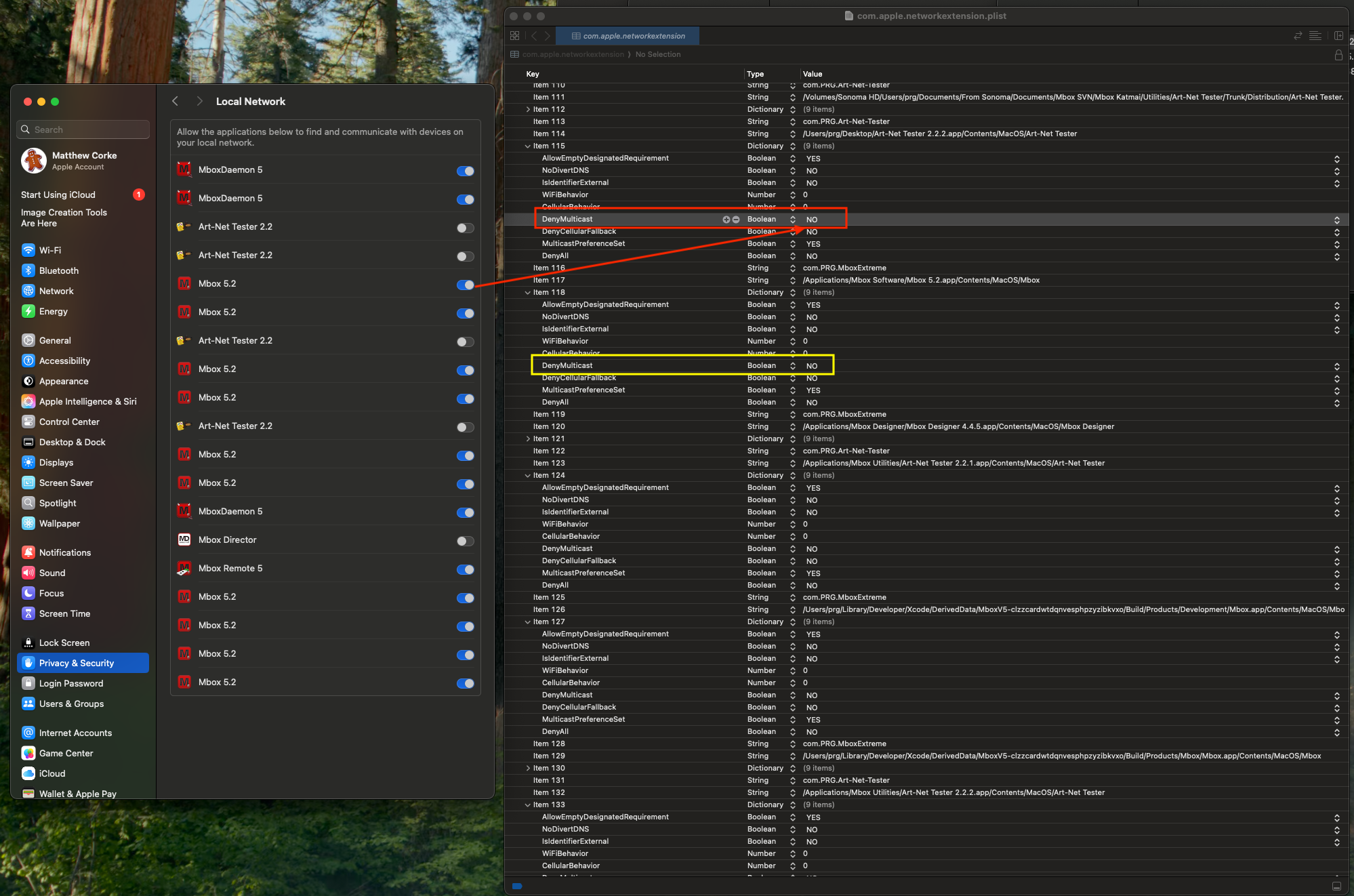

This next screenshot shows the result of toggling the UI to grant permission to the app. As noted by others, toggling any one instance of the application called "Mbox 5.2" causes the toggle for all instances to be in the same state. In the image you can see that the same instances are highlighted in the plist file, with the DenyMulticast value for the first instance now being set to NO:
In the first case outlined above, with permission turned off, the instance of our application called "Mbox 5.2" is NOT able to receive UDP multicast data, but ALL other instances are able to receive the same data. In the second case, with permission turned on, ALL instances of the application can receive UDP multicast.
Based on what we've seen, there's an obvious inconsistency between what's shown in the UI and what the actual permission state is. The UI seems to follow and only affect the first instance of the application. Either each instance of the application would have its own instance of the permission, or like other permissions there should be only one instance for each unique BundleID and the value affects all applications with that ID.
In addition to the inconsistency between the UI and actual operation, we have also seen in testing that even when granted permission for Local Network to an application, that after a reboot the application is unable to send/receive UDP multicast. To resolve this issue you can quit the affected app (or apps) then toggle their Local Network permission off then on again, and then relaunch the application. This state seems to hold until the next time the computer is rebooted. It is our suspicion that this issue is related to having multiple instances of the same application on the computer and the lack of consistency between UI and the plist. But we don't have any evidence of this yet.
