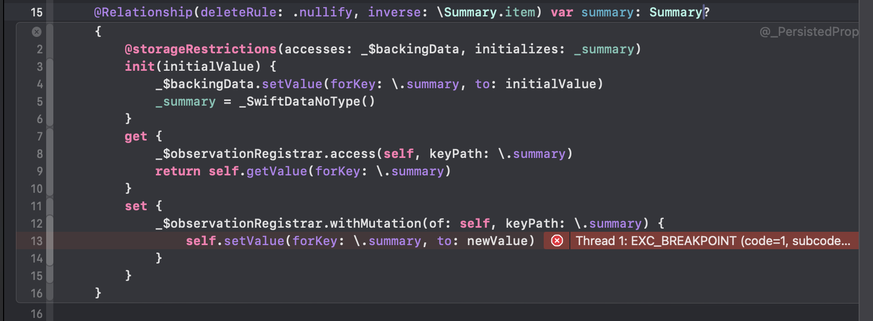

Is this Relationship correct? Does this cause a circular reference? This runs on 18 but crashes on 17 in the swift data internals.

Answered by DTS Engineer in 809396022
Adding @Relationship before a relationship is fine, unless you specify the inverse parameter on both side, which will then trigger an error.
The error shown in your screenshot doesn't seem to be related to the existence of @Relationship in Summary. It is more likely related to the way you set up the object graph, which may be similar to the following post:
If the above post doesn't help, I'd be interested in taking a closer look into your code that reproduces the issue, if you don't mind to share that.

I appreciate the reply. I saw it done both ways online and I left the @Relationship on Summary more as a reminder to me. But removing it gives me the same error.
I also removed the creation Summary from the Item initializer and created the Summary after init, but the same error remains so it's definitely something to do with the relationship.
And it still exists on 17.7.

I was able to create a sample project this time showing the error. However, I'm unable to attach a zip file here, looks like only .json files are selectable. How can I send this to you?
I also found a post that had the same error, but with no resolution: @Relationship crash on ios17.5 but not on ios18
