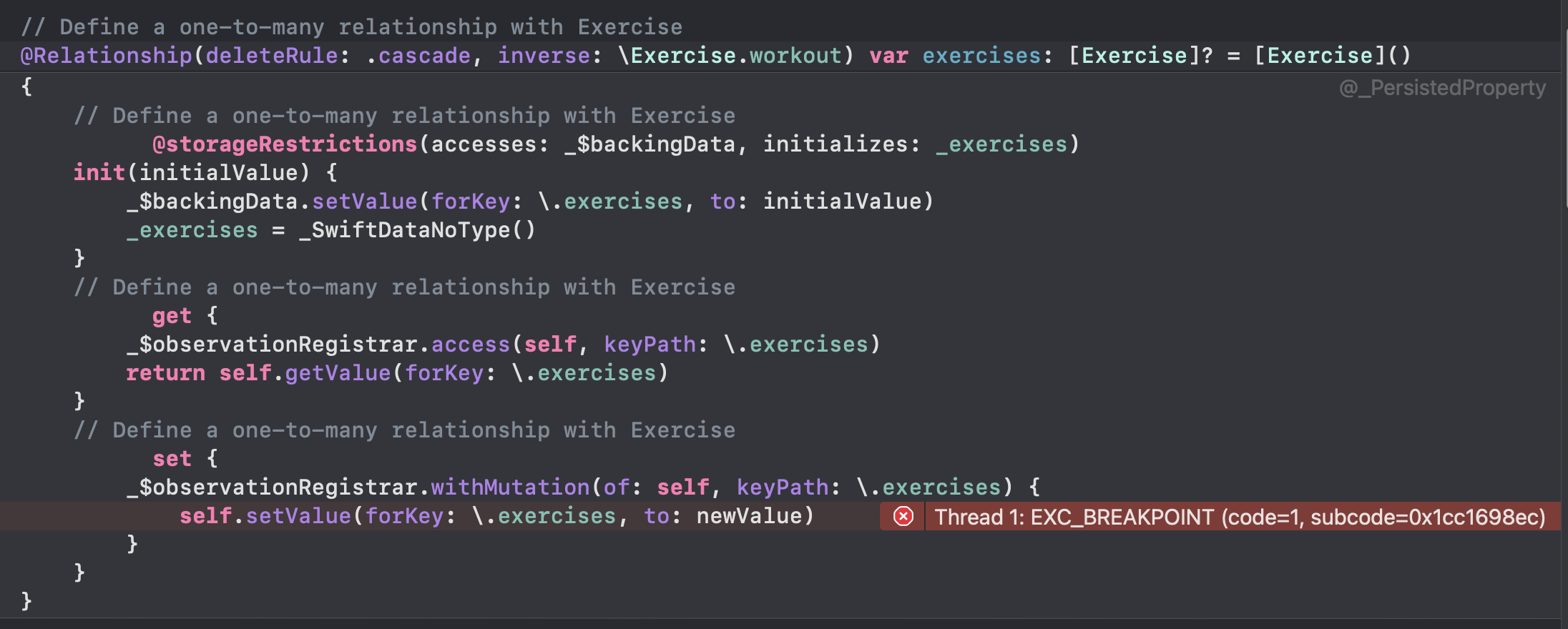

In my app, I worked with ios18 by default and I had no issue, everything was working fine. However, when I wanted to test it with an iOS 17.5 simulator or real device, it is unusable because it crash when object with a relationship are created.
on the first line you can see my relationship, and under it it is the extended relationship macro unmodifiable.
has someone already encountered this? any clue of a hide modification of relationship working behavior in ios18?

I defined a many-to-many relationship between a set of exercises and workouts that you can create (crash occurs when generating a workout)

the crash with the same error occurs at more than one place, but for example when I try to display pre-made workouts, called challenges, when I debug line by line, it load the first one but crash on the second one (there is 12 in total). on iOS 18, no problem tho. it crashes in this part of the code exactly, taking a static list of workout and a static list of exercises and linking them together:

The use of relationships, as shown in your code snippet, looks pretty normal. It is a surprise to me that the code triggers a crash on iOS 17. It can be a bug that occurs on iOS 17 and has been fixed on iOS 18, but if you target to support iOS 17 and need to get to the bottom, please start with filing feedback report with a minimal project that reproduces the issue and share your report ID, I'd take a closer look from there.
