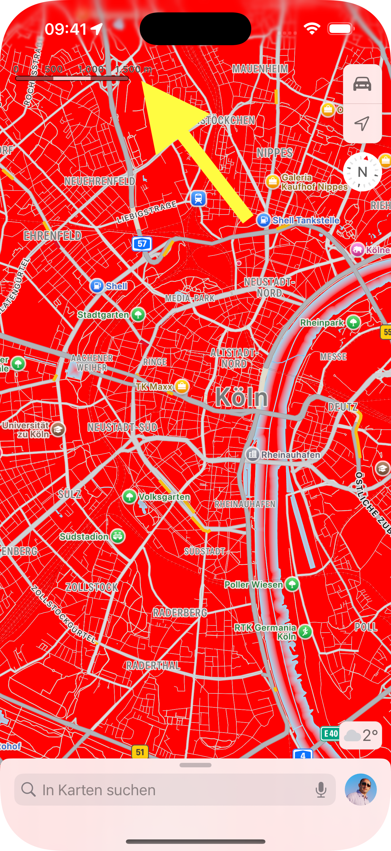

We are experiencing an issue where MKMapView appears red on the app builded with Xcode 16 and executed on iOS 18 simulator.
Only the ground is affected and buildings or POIs stay normal color.
Xcode 16.1 beta 3 shows same result.
Is there any similar case?

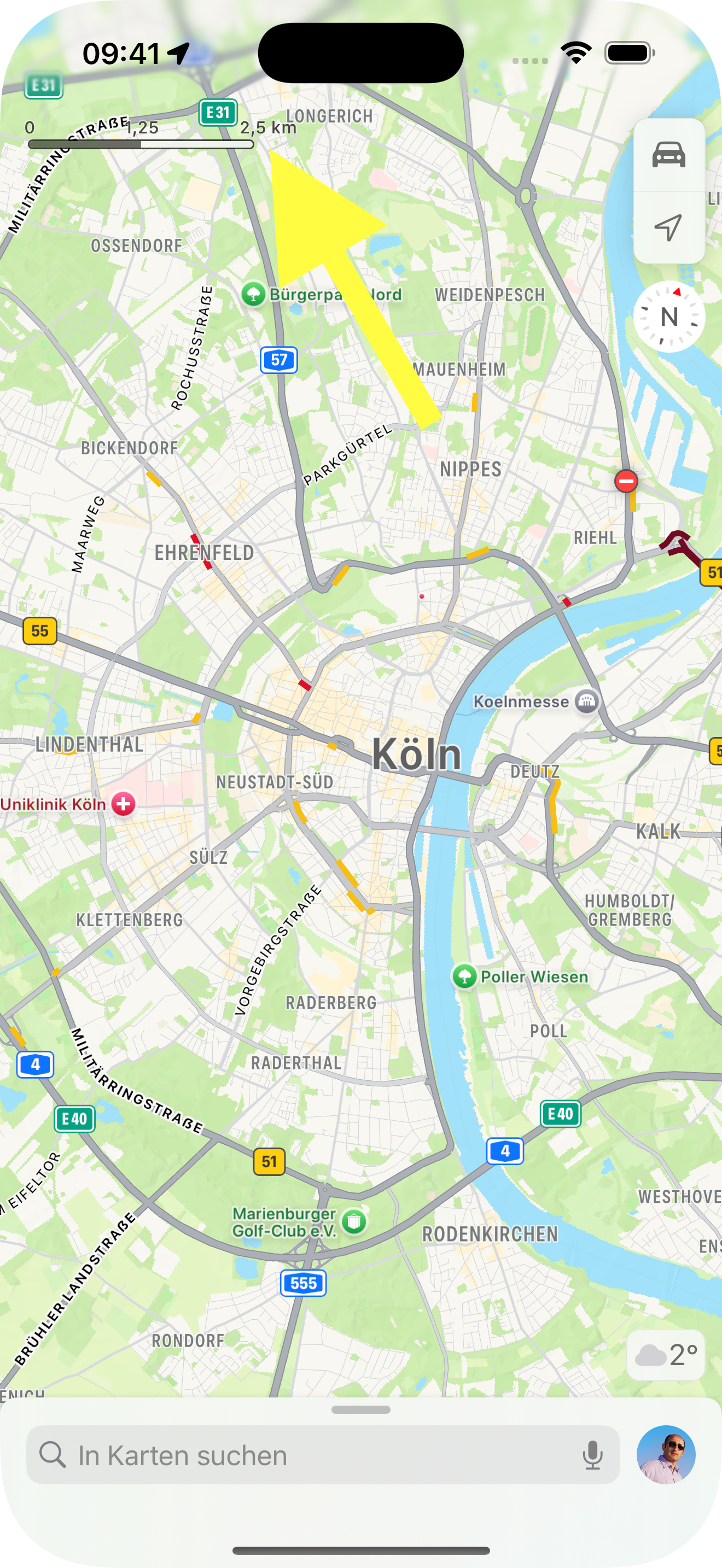

I've had the same problem for a while now. I am currently using Xcode version 16.2 (16C5032a). The problem is with the iOS 18.2 and iPhone 16 Pro Max simulator. Not with the iPhone 15 Pro Max Simulator and iOS 17.5. I can also zoom up to 24 meters and the colors remain the same. The problem starts at a zoom range of 1500 meters and not everywhere. Play around with the coordinates from the simulator. It works in Cupertino, San Francisco or other large cities, but not in rural areas. In Europe, the colors are red almost everywhere when zooming.
