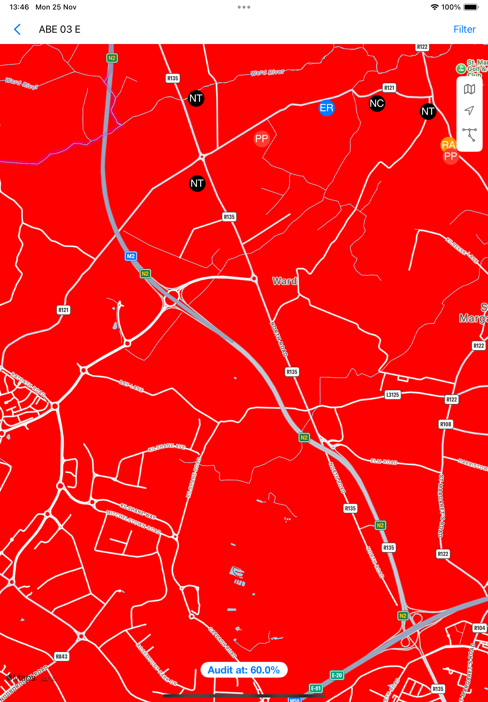

I just ran into this issue as well... weirdly, there are parts that do not get red, like London. But the majority looks like this:

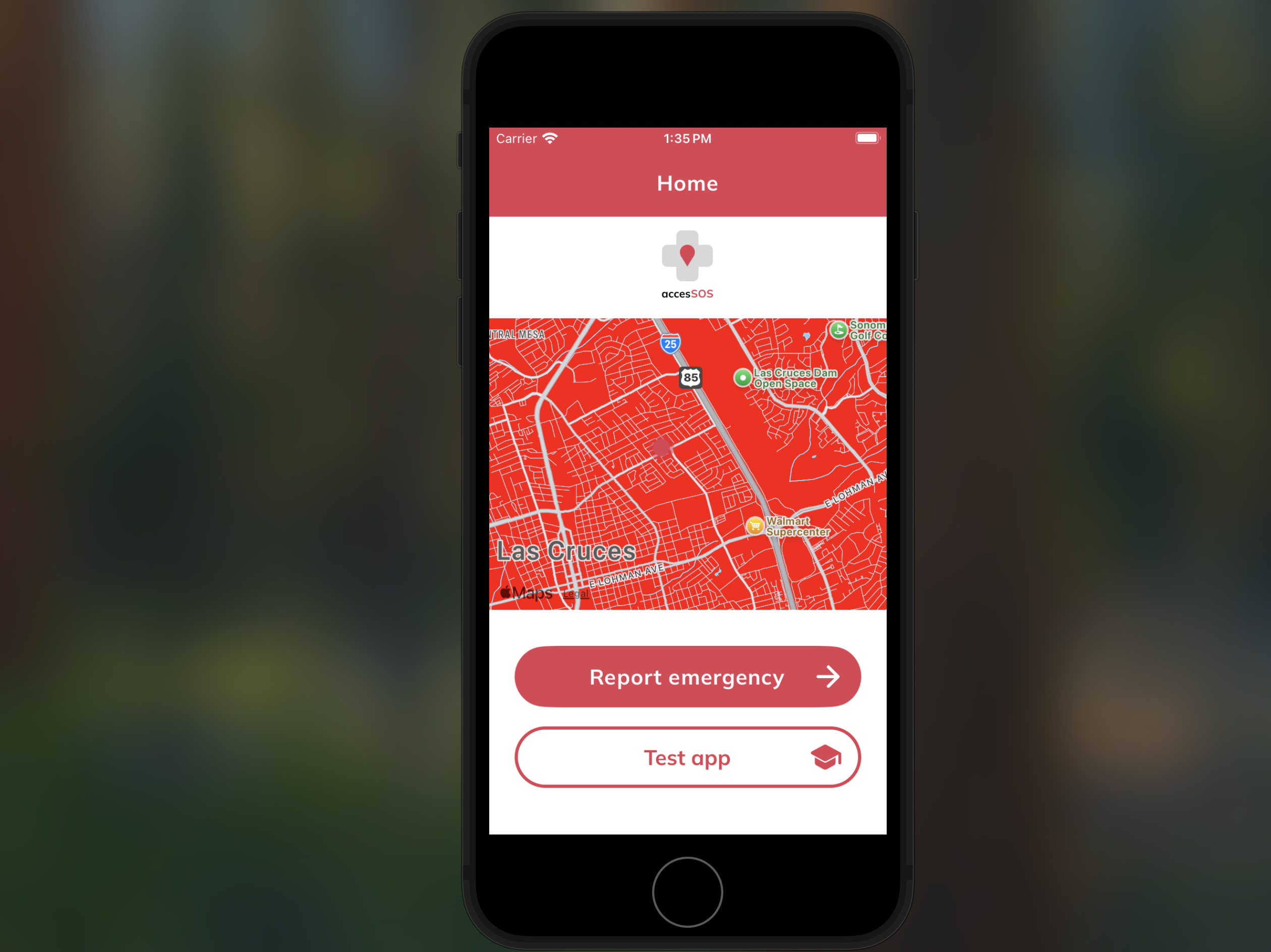

Oddly enough if I am in a different location it renders fine, but for some reason it's red for the entire New Mexico
