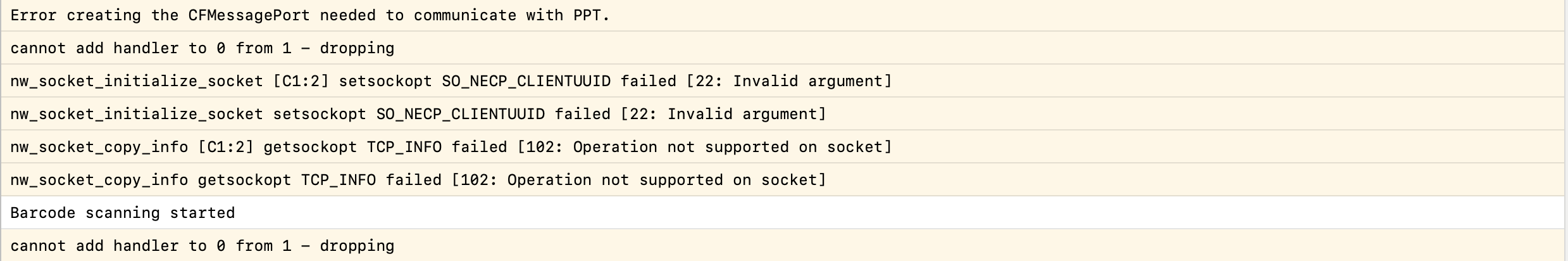

And here is the output from the log:
Unfortunately now barcode is detected neither qr, nor another.
