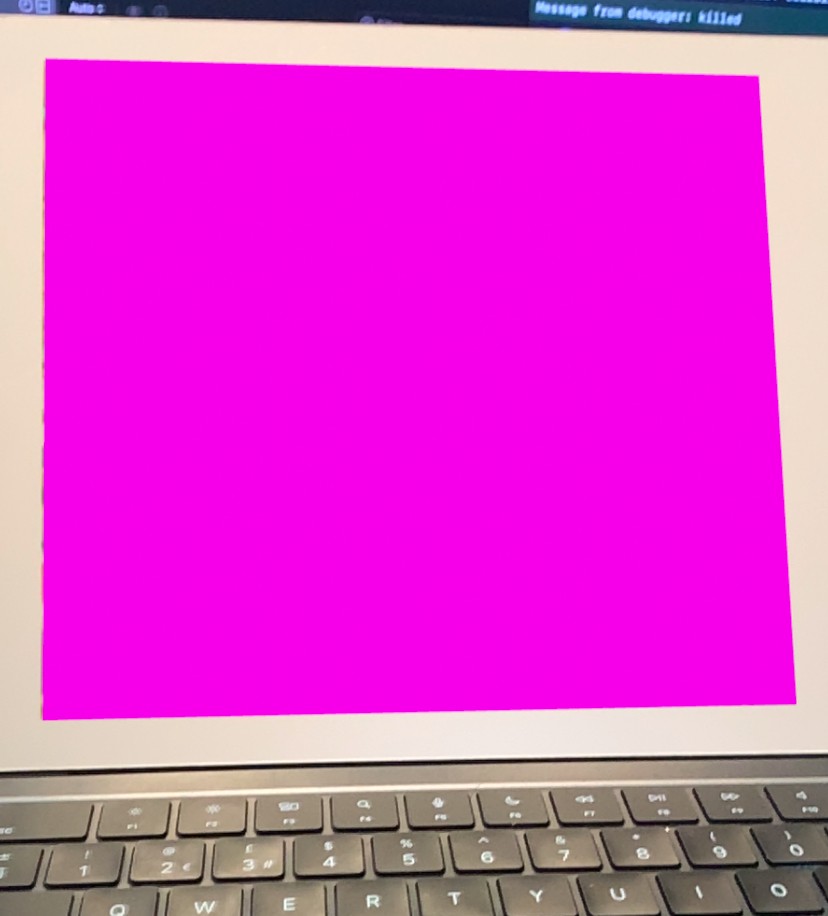

The following code works on iOS 17 and iPadOS 17.x but not on 18. The Video Plane simply appears pink instead of showing the video itself.
import RealityKit
import AVFoundation
struct ContentView : View {
        RealityView { content in
            // Create a cube model
            let model = Entity()
            let mesh = MeshResource.generateBox(size: 0.1, cornerRadius: 0.005)
            let material = SimpleMaterial(color: .gray, roughness: 0.15, isMetallic: true)
            model.components.set(ModelComponent(mesh: mesh, materials: [material]))
            model.position = [0, 0.05, 0]
            // Create horizontal plane anchor for the content
            let anchor = AnchorEntity()
            let player = AVPlayer(url: Bundle.main.url(forResource: "phone-video",
                                                           withExtension: "mp4")!)
            let videoMaterial = VideoMaterial(avPlayer: player)
            let modelEntity = ModelEntity(mesh: .generateBox(width: 2.0, height: 1.7, depth: 0.01), materials: [videoMaterial])
            player.play()
            modelEntity.position.z -= 2
            modelEntity.setParent(anchor)
            anchor.addChild(model)
            // Add the horizontal plane anchor to the scene
            content.add(anchor)
            content.camera = .spatialTracking
        .edgesIgnoringSafeArea(.all)
#Preview {
    ContentView()
Still not working on iOS 18.4 and 18.4.1. Anything we can do meanwhile?
