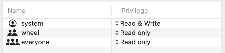

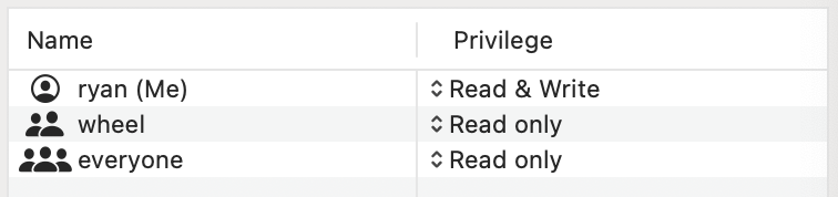

I have been experimenting with delivering theses formats in a sandboxed app. I was using the com.apple.security.temporary-exception.files.absolute-path.read-write entitlement to place a symlink in the system folder that points to my CLAP and VST3 plug-ins in the bundle. Everything was working very nicely until I realize that on my Mac I had changed the permissions on these folders from
to
The problem is that when the folder has the original system permissions, my attempt to place the symlink fails, even with the temporary exception entitlement.
