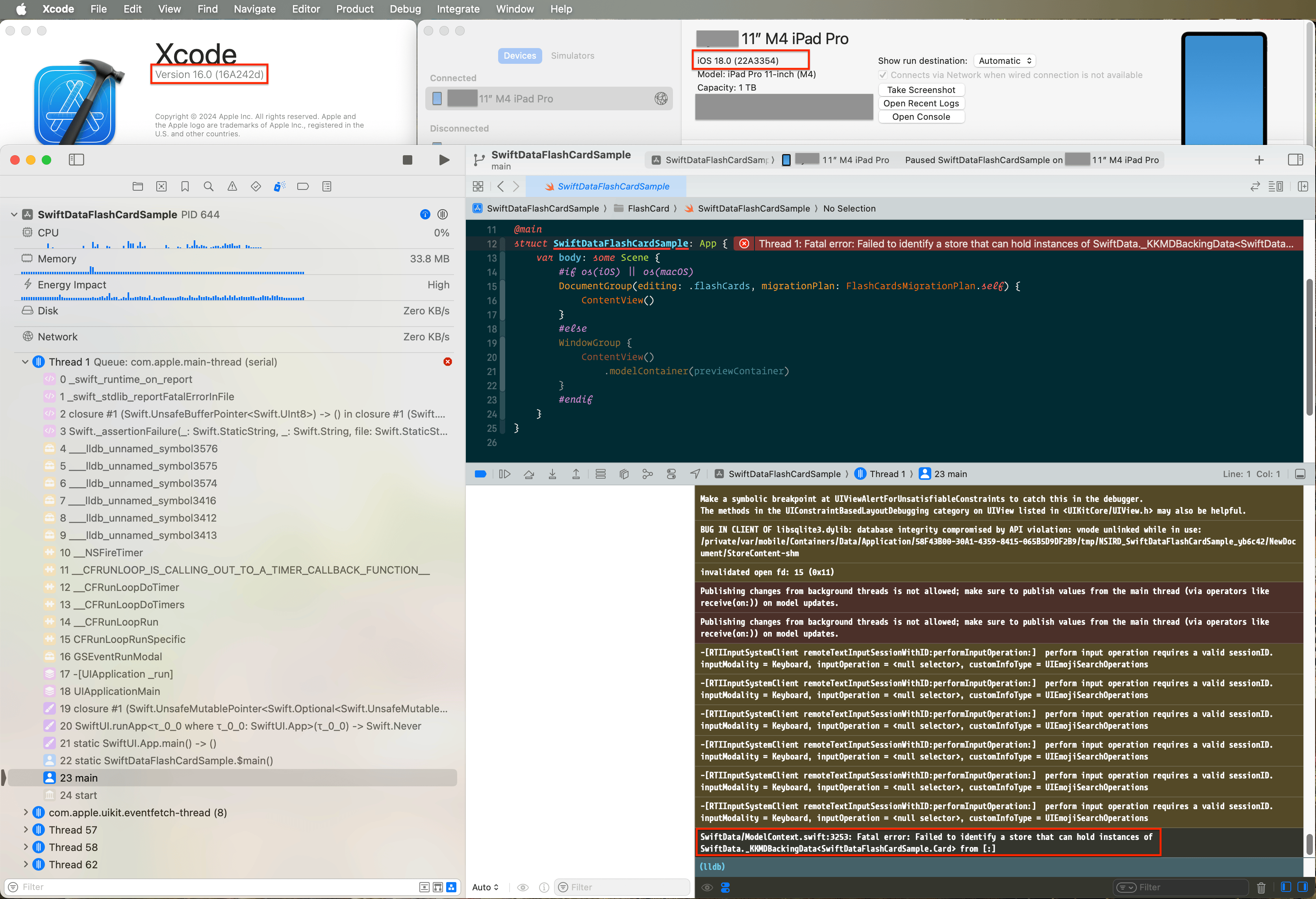

When trying to run my document-based iPad app using iPadOS 18 beta and Xcode 16 beta, I get an error like the following after opening a document:
Thread 1: Fatal error: Failed to identify a store that can hold instances of SwiftData._KKMDBackingData<MyProject.MyModel> from [:]

I am also able to easily reproduce this issue on an iPad running an unmodified version of the sample project, using the current release version of Xcode and iPadOS. It did not happen with the first document I created, but re-opening that document reveals that nothing saved. The second document did save changes, but it resulted in this error on close.
