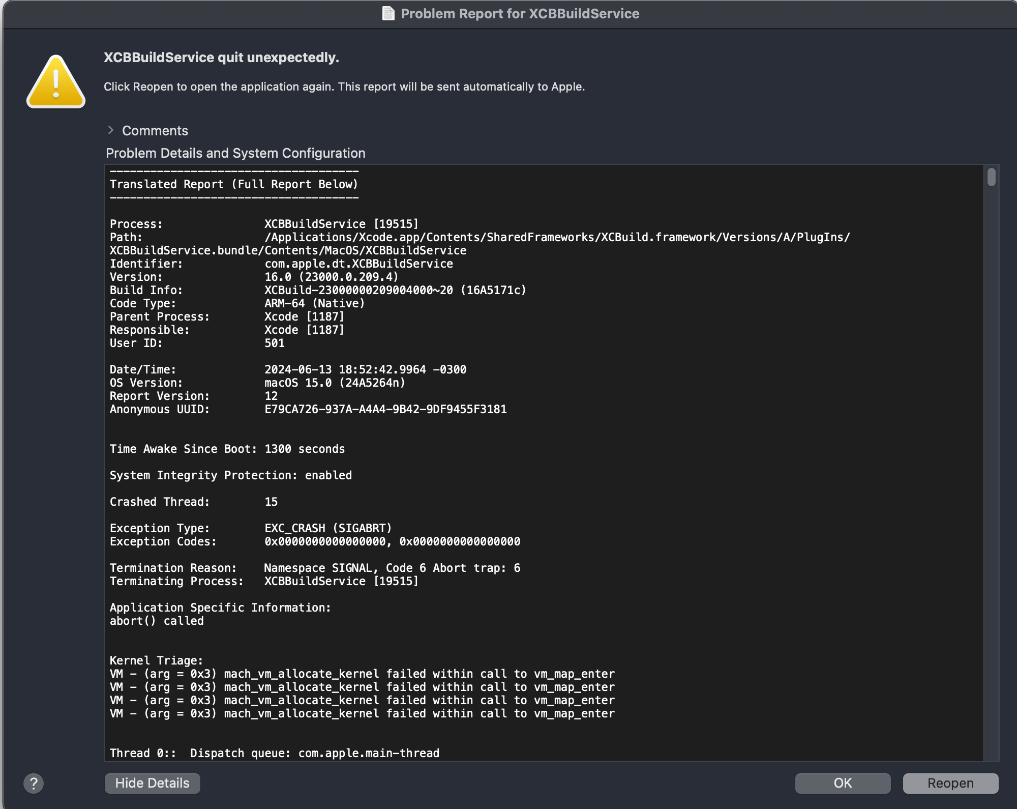

Most of my Xcode previews are crashing very often on Xcode 16 beta. I receive the following errors:
  • Fatal Error in UVJITAgent.swift: Failed linking pseudodylib <path> during initial JIT link. dlopen(<path>, 0x0002): Library not loaded: /System/Library/Frameworks/_ClockKit_SwiftUI.framework/_ClockKit_SwiftUI
  • LLVMError(description: "Duplicate definition of symbol ...")
  • AppCannotRunOnTargetDestination: This app cannot run on the selected target device.
I can get all previews to work by performing an incremental build and resuming the preview. Sometimes, I have to repeat this process multiple times. As soon as I switch to another view, the errors return.
I've submitted a feedback report and attached diagnostics for all errors (FB13865079).

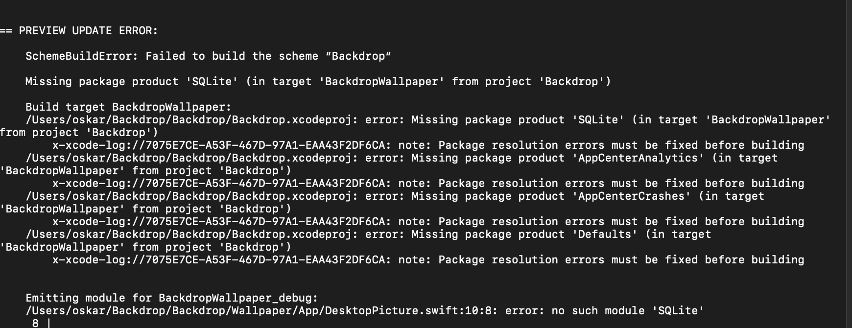

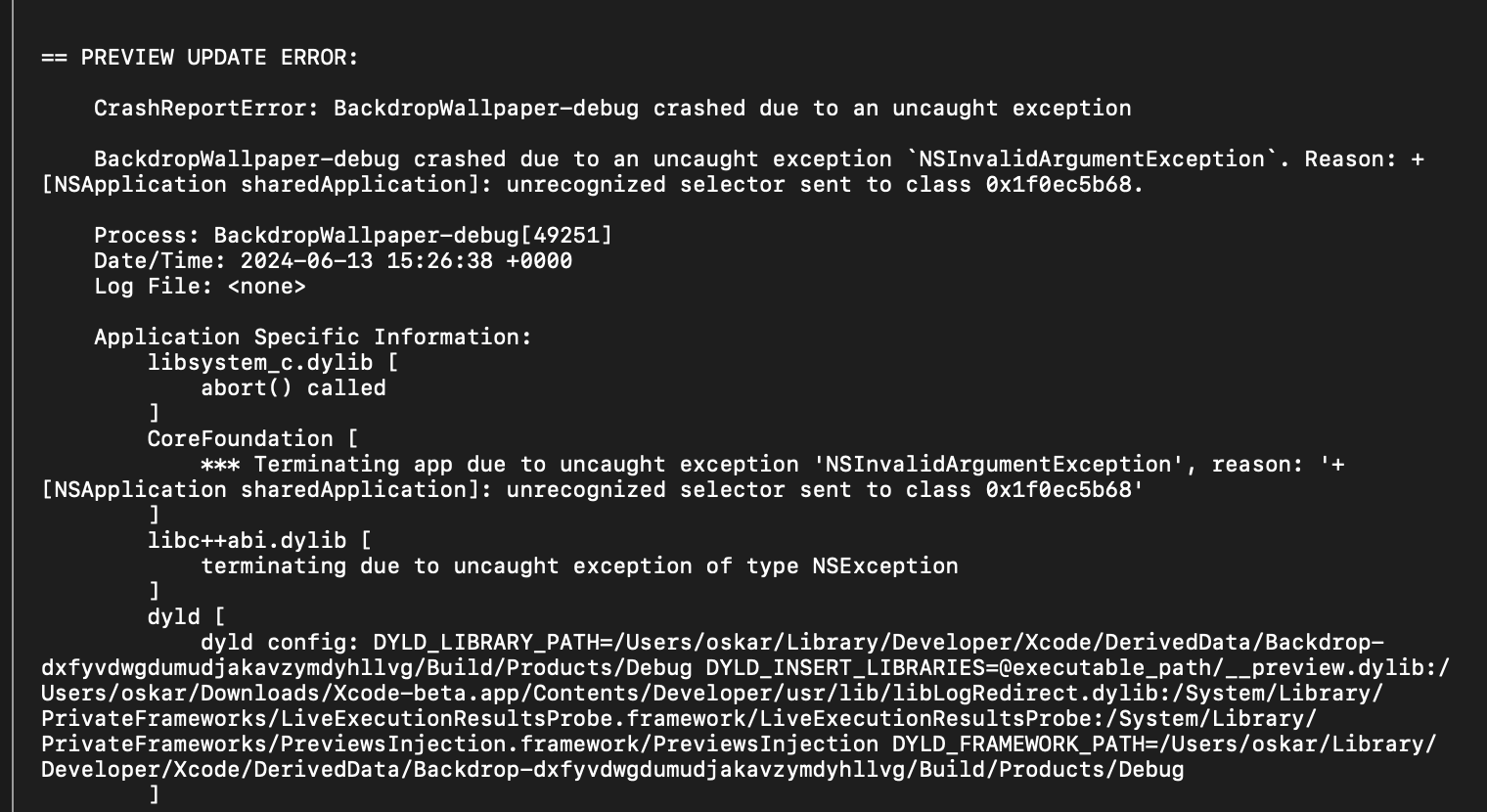

Also seeing this issue. I was getting these two errors in different projects:
Nothing in the project was calling NSApplication.shared, and building/running the app worked fine...

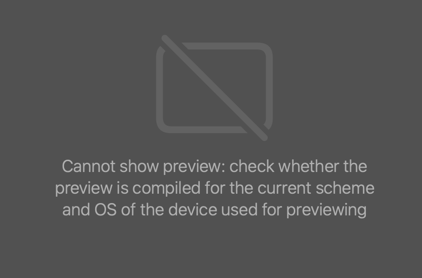

I started removing every single linked framework and source file except one, and made a simple Preview containing a Color.red, and now my Preview won't even load at all:
