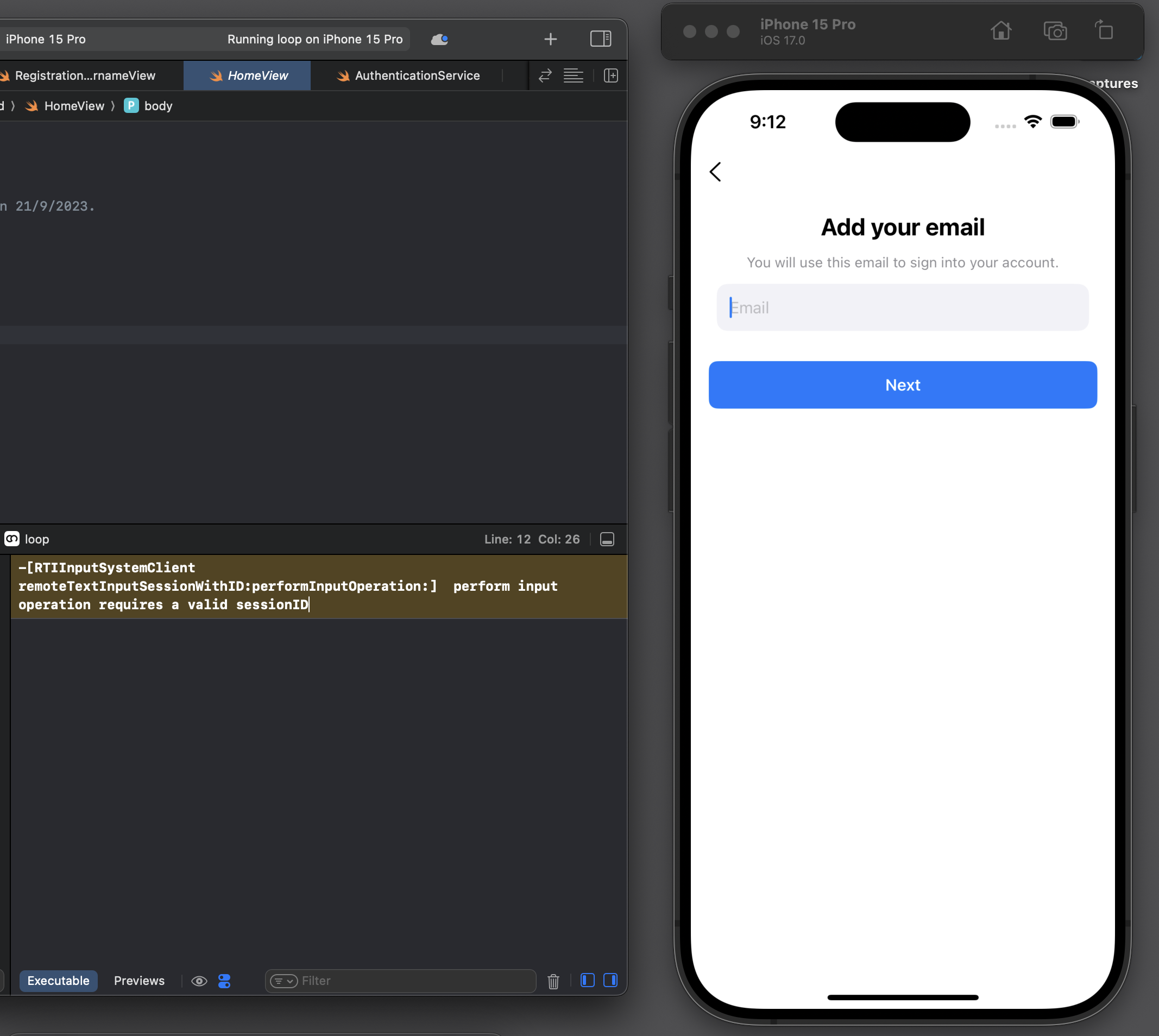

The warning seen in the console occurs the exacty mooment I click insite of the TextField that you can see in the Image on the right.
Typing in the text field continues to through addition warnings although different to the original.
