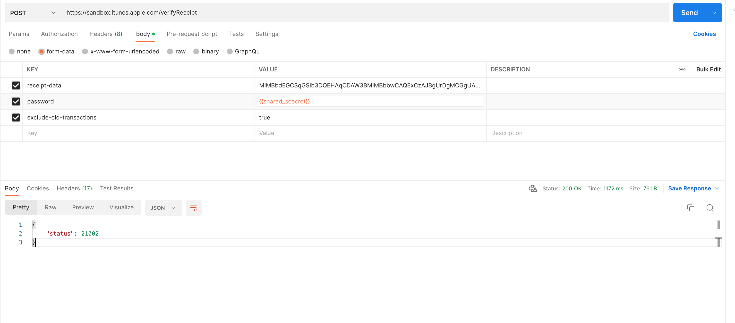

We started getting error code 21002 from the verifyReceipt endpoint today for any receipt passed to it:
    "status": 21002
I have created a new sandbox tester, and cleared and reinstalled the application before attempting the purchase. I'm seeing this response through RevenueCat's receipt validation tool (https://www.revenuecat.com/app-store-receipt-validation/) and from a direct cURL command:

Answered by DTS Engineer in 744422022
There was an outage with the App Store receipt verification that is now resolved. See the status page for details. File a Feedback report if the issue still occurs.

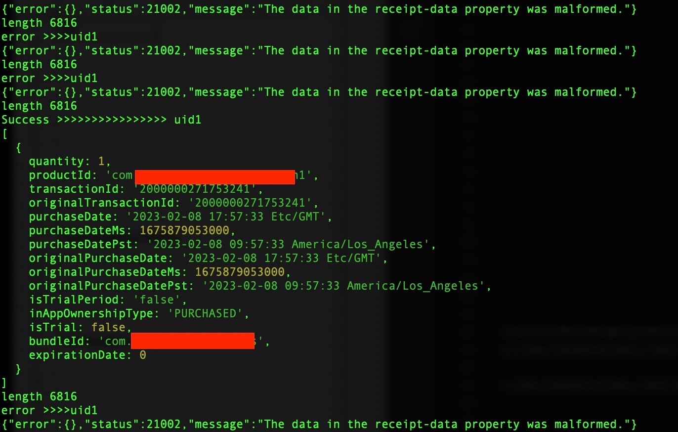

I tried 100 times with the same receipt. It stills shows 21002 (Sandbox) and normal back and forth. tried 100 times but only a few get responses. Any idea?
We're still experiencing this issue in Sandbox. We're POSTing to https://sandbox.itunes.apple.com/verifyReceipt and we consistently get 21002. Production seems okay.
Still getting 21002 even if the status shows the outage was solved. We dont have the app published cause we thought is an error on our side. Go figure. Should I have any hopes the sandbox will work tomorrow? or rather go publish the app and consider the validation is working and they they wil really work after its in production
We are also still seeing this in the sandbox and in testflight builds. However, roughly 10% of purchase+verification attempts are succeeding.
