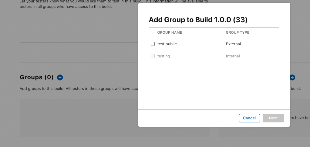

Somehow, I can't select it. When I go to the Internal Test Group, there is no (+)-Sign next to Builds. When I go to the external Test group, there is. And when I select the build and click on the (+)-Sign next to Groups, I can't select the internal test group.
I am seeing this also, no new builds are being added to any internal testing groups and I can't seem to add them manually?

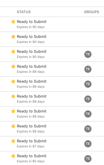

Same issue for us. Today, we cannot deploy the last version of our application on Testflight because our internal testers group hasn't been added to the list of Groups. And we are not able to add it manually. For your information, yesterday, we deployed a previous version of our application on TestFlight without issue.

I have the same problem, tried to remove group, remove users, add them again, increase build version, nothing helped. Now I have a build, but can't add any internal group to it as well as the internal group has zero build in Build section.
