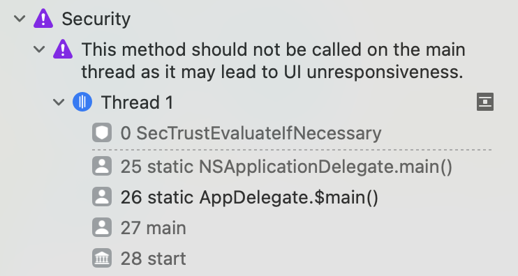

Xcode 14 & iOS 16 purple warnings starting with "[Security] This method should not .. "
Updated to Xcode 14.0 and built with iOS 16 device.
In purple it says "[Security] This method should not be called on the main thread as it may lead to UI unresponsiveness." A warning is displayed.
location is
@UIApplicationMain class AppDelegate: UIResponder, UIApplicationDelegate {...
There is a part where it is difficult to know exactly which function it is because a warning is displayed at the location.
I also replaced the admob library with the latest version, but I have the same problem.
Does anyone know the cause of this issue?
I need help.

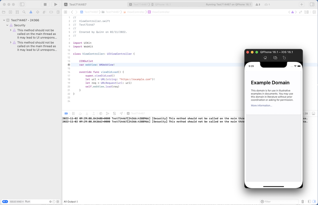

I want to make sure we’re all on the same page here, so I created a tiny test project with a WKWebView and reproduced the problem. Here’s what I see when using Xcode 14.1 running on macOS 13.0 with the iOS 16.1 simulator:
When I click the disclosure triangle associated with the issue, I see this backtrace:

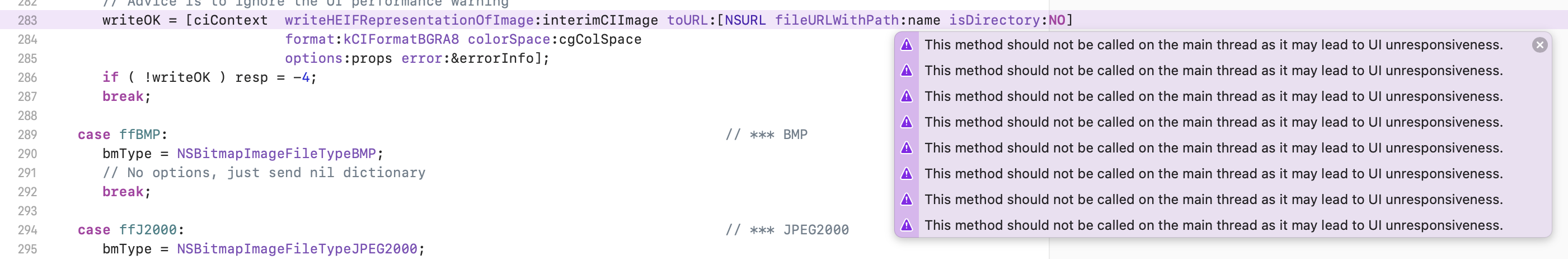

Here's another datum. I propose to follow the "it’s likely that this isn’t your problem and you should feel free to ignore the issue" advice but this is an occurrence not involving WKWebView.
I get no less that 8 occurrences of the warning from a use of UIContext. Though I may agree it would be better not to use it on the main thread, 8 warnings seems a little excessive. I did try obtaining the NSURL separately into a variable fed into this statement but (unsurprisingly) that made no difference.
Xcode 14.2, macOS Ventura 13.2, targeting macOS 10.14.

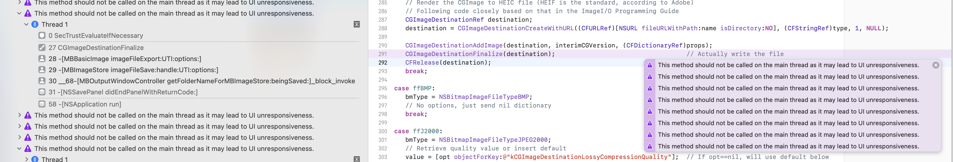

OK, I thought I had pressed the disclosure triangle to show the 8 identical errors but I've found it now (below). Note that I have changed my CIImage code and am now using CGImage but with the same issue. Xcode is 14.2, I have no earlier reference as it's new code. As you can probably see, the code is in a method run from a block invoked by a Save panel when the user clicked on 'Save'.
Since the backtrace does include my code, Perhaps I can't just ignore it; it seems to be CGImageDestinationFinalize causing the issue. Odd that I get 8 copies of the report though.

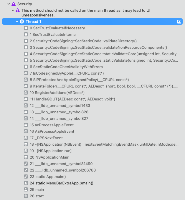

@eskimo - this also happens in a SwiftUI app that I've made responsive to AppleScript commands (using NSScriptCommand). Whenever I issue it an AppleScript command it will complain abut UI responsiveness (which isn't wrong per se - as AppleScript is running on the main thread, but is there any other option?)
