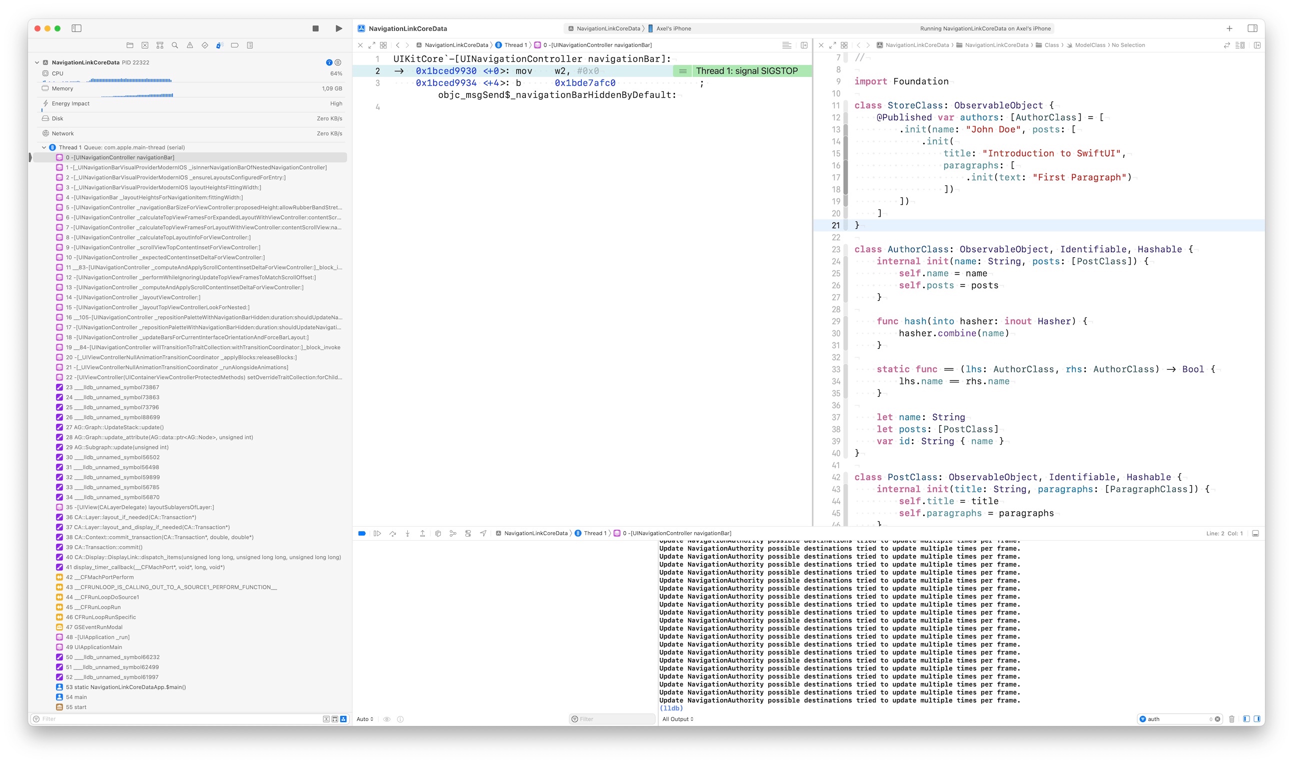

After updating to NavigationStack with nested navigation links (with navigation links in a navigation destination), I see a lot of warnings in Xcode 14 beta:
Update NavigationAuthority bound path tried to update multiple times per frame.
Update NavigationAuthority possible destinations tried to update multiple times per frame.
The app often freezes when navigated with a NavigationLink. Do others see these problems?

I'm seeing similarly on Beta 4, though I didn't seem to see this on the earlier betas. Same scenario as the folks above though with regard to using nested NavigationLinks within a NavigationStack and also Core Data. Seems to be doing what the warning says and calling that destination over and over, until the app freezes.
Same problem if I append a value to path (NavigationPath). Tested in Xcode 14 beta 5
I'm also seeing this or something similar starting with beta 5. I have a NavigationLink/navigationDestination with a NSManagedObject item in one view and another NavigationLink/navigationDestination combo in the destination view using another NSManagedObject item. When the outer NavigationLink is tapped, it just sits there and hangs with 100% CPU and running up memory like crazy. Putting a breakpoint in the upper navigationDestination reveals it getting called over and over so it's probably some kind of recursion in the SwiftUI framework.
