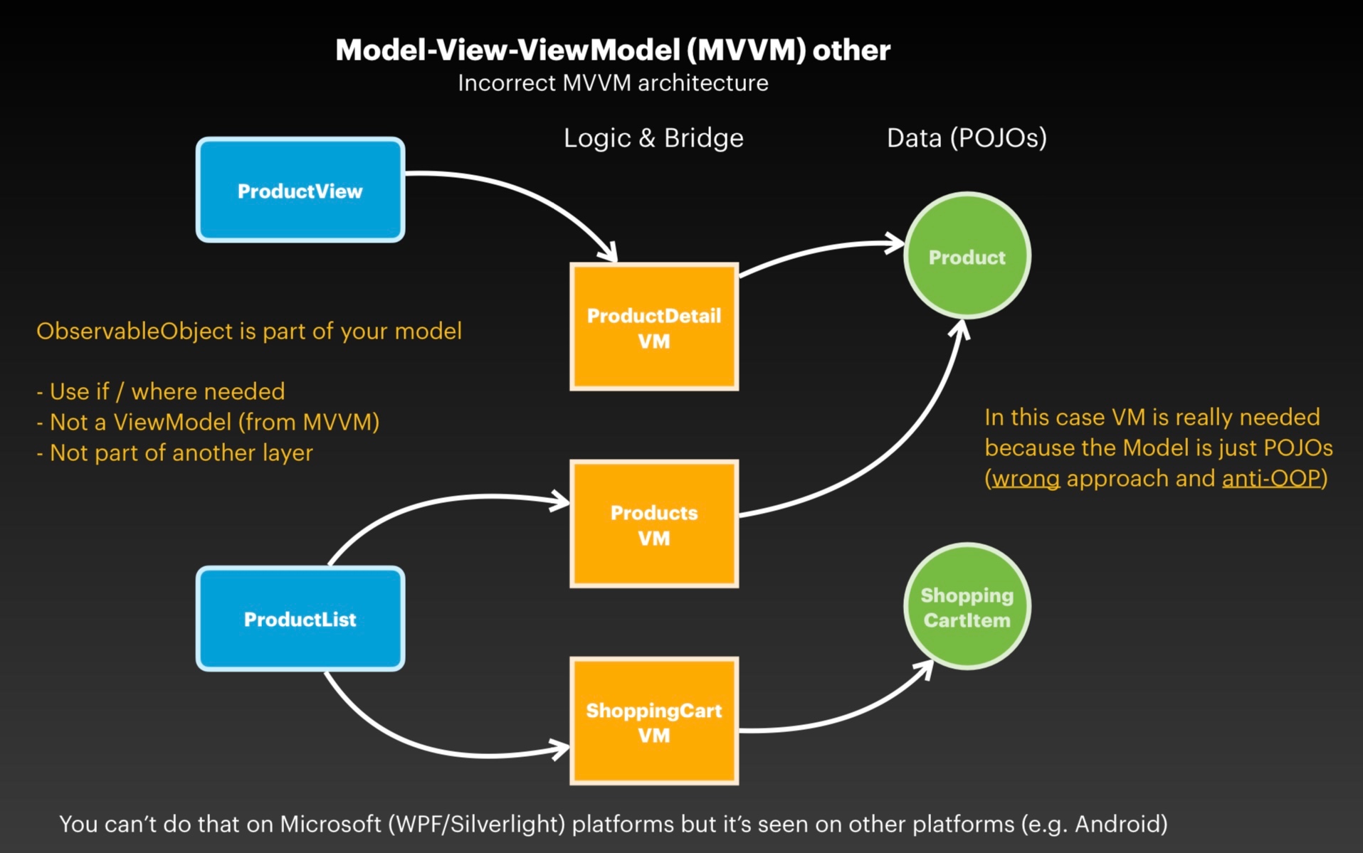

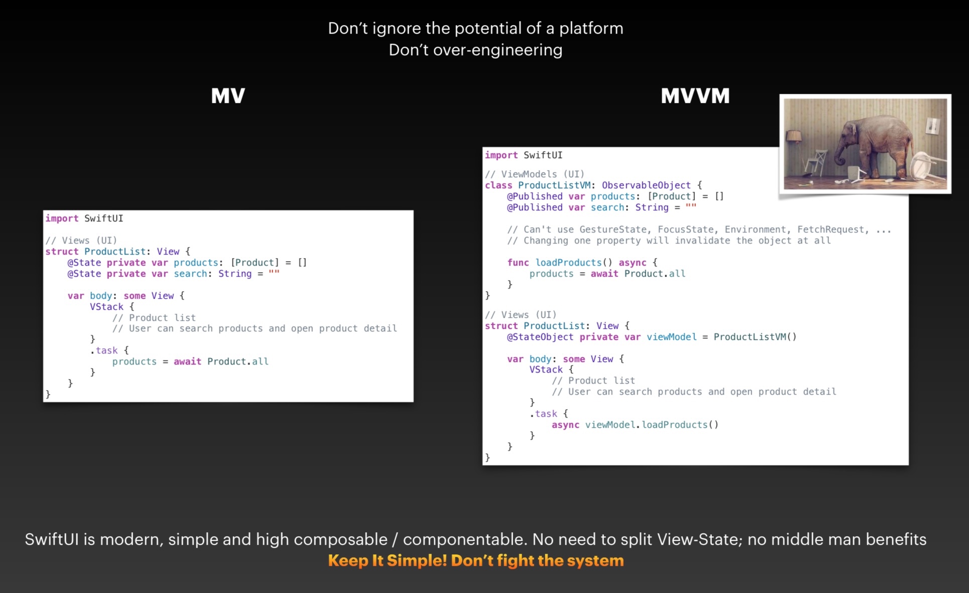

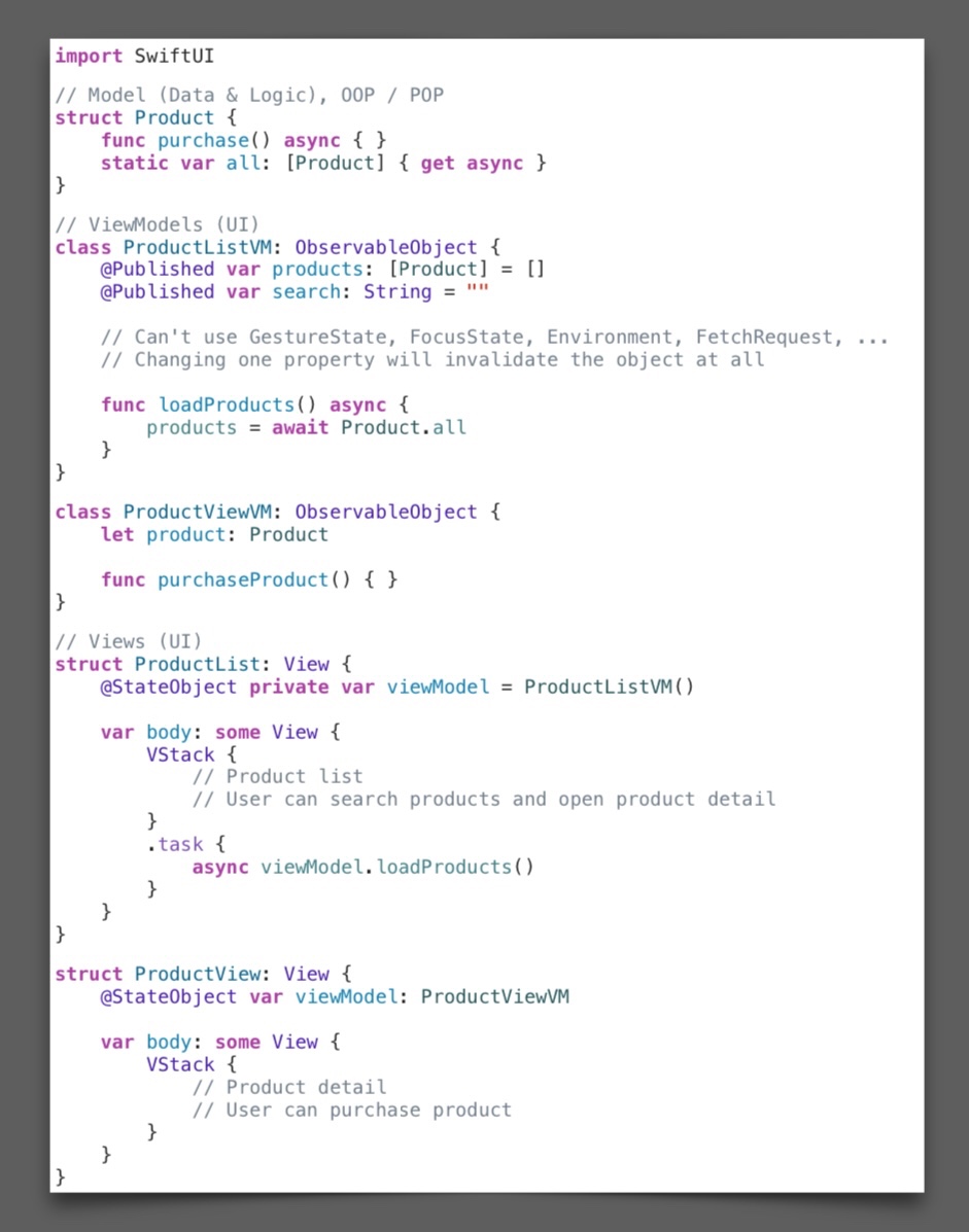

Stop using MVVM for SwiftUI

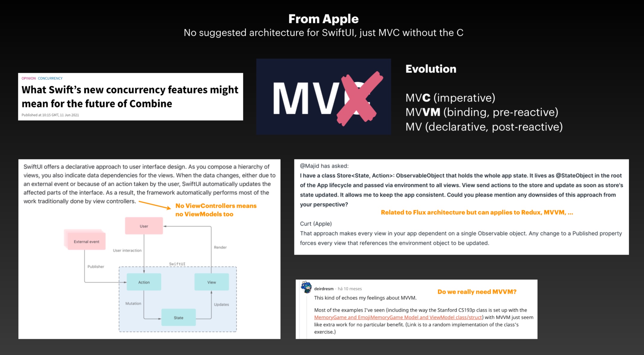

Don’t over-engineering! No suggested architecture for SwiftUI, just MVC without the C.
On SwiftUI you get extra (or wrong) work and complexity for no benefits. Don’t fight the system.

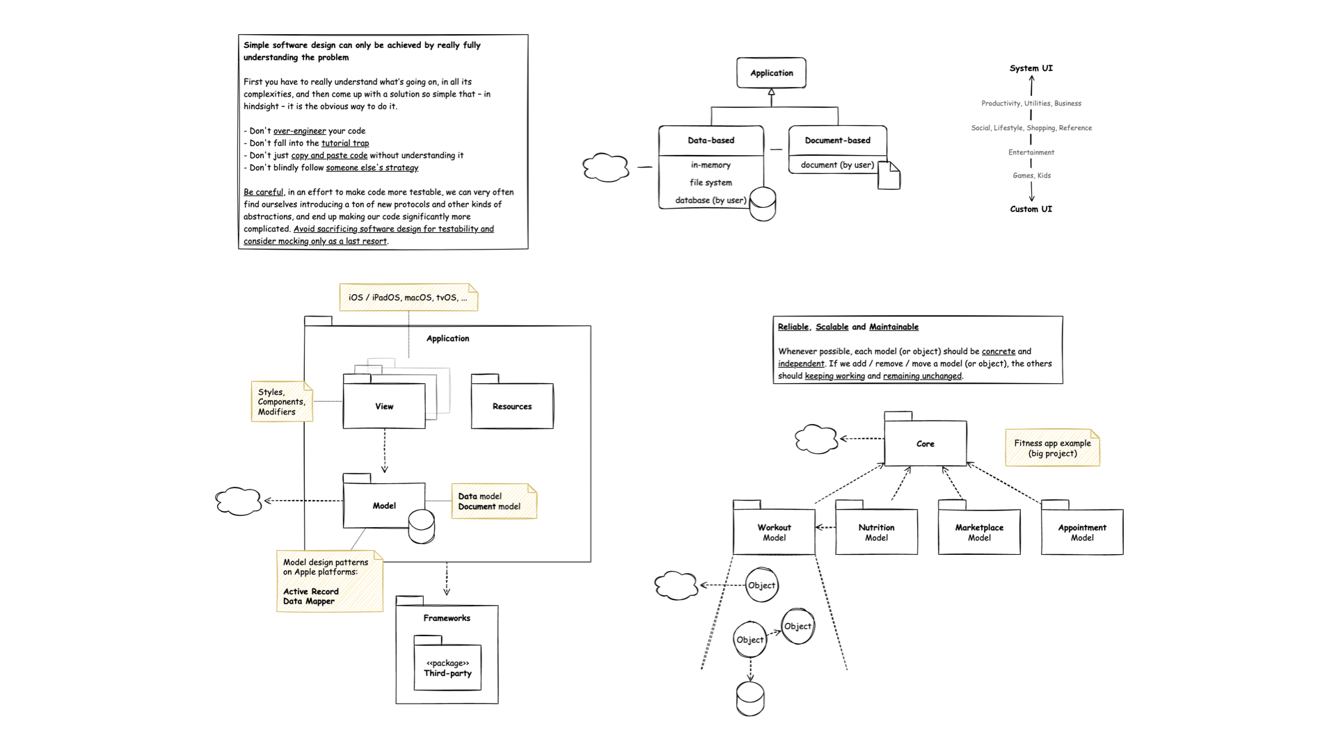

Simple software design can only be achieved by really fully understanding the problem First you have to really understand what’s going on, in all its complexities, and then come up with a solution so simple that – in hindsight – it is the obvious way to do it.
  • Don't over-engineer your code
  • Don't fall into the tutorial trap
  • Don't just copy and paste code without understanding it
  • Don't blindly follow someone else's strategy
  • Avoid sacrificing software design for testability
  • Consider mocking only as a last resort
Be careful, in an effort to make code more testable, we can very often find ourselves introducing a ton of new protocols and other kinds of abstractions, and end up making our code significantly more complicated.

  • Don’t fight the system
  • Don’t literally start with a protocol
  • Avoid unnecessary internal & external dependencies
  • Avoid too many layers of abstraction or complexity
  • Use nested type for supporting or to hide complexity

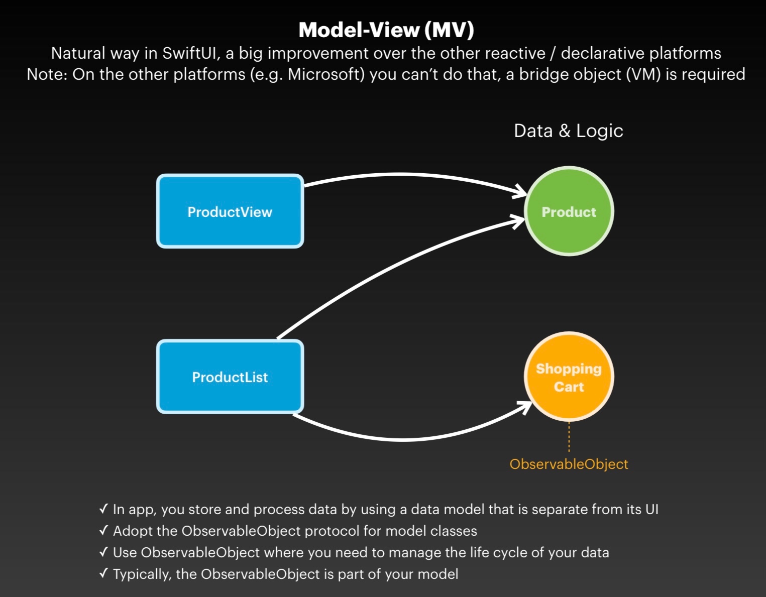

  • In app, you store and process data by using a data model that is separate from its UI
  • Adopt the ObservableObject protocol for model classes
  • Use ObservableObject where you need to manage the life cycle of your data
  • Typically, the ObservableObject is part of your model

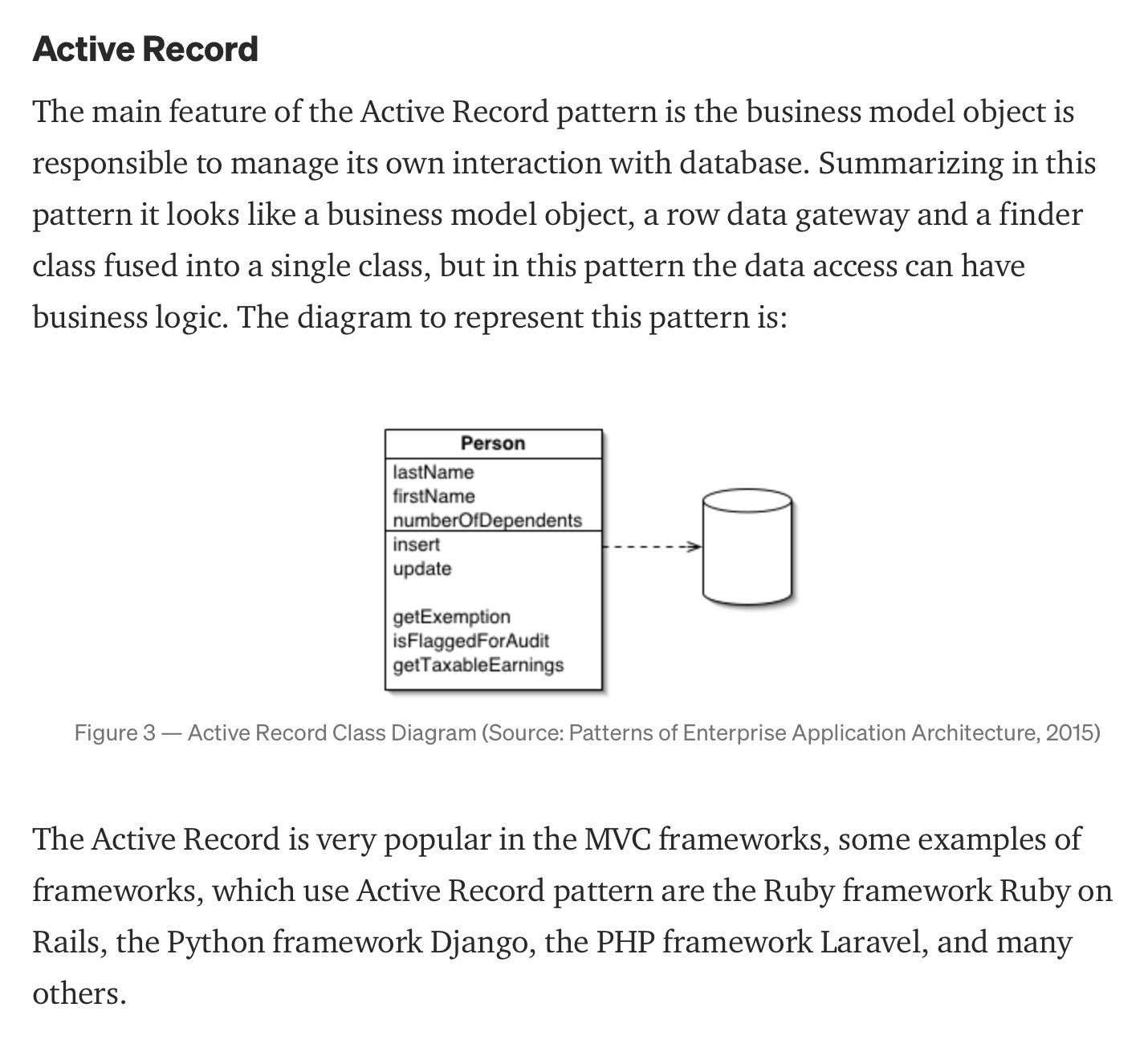

StoreKit 2 is a great example how to create your model using Active Record and Factory Method patterns.
StoreKit 2

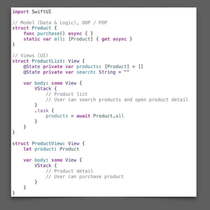

SwiftUI automatically performs most of the work traditionally done by view controllers (view models too).
Declarative UI does not require MVVM. We are now in an era where declarative UI is commonplace in iOS development.
The other things you can do with property wrappers, modifiers and custom views.
Everyday I see bad developers, normally coming from other platforms, ignoring the obvious.
In the field of React/Vue/Flutter, which also uses declarative UI, the architecture of MVVM is not adopted, and it seems strange to adopt MVVM only in SwiftUI.
While I generally see your point and it makes a lot of sense. I am not sure if I fully understand it.
For example how to test apps made with MV pattern?(I am assuming we will be simply testing the whole View, Not that I am particularly against it, simply not sure if this is the right approach)
Also what about creating massive Views? To avoid it you will probably use Observable objects in this case anyway so you will get MVVM?

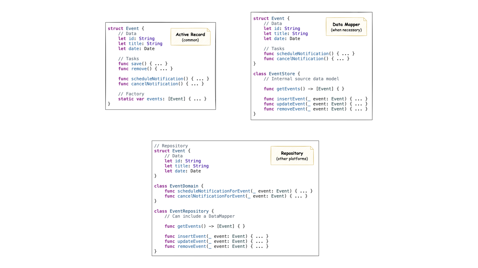

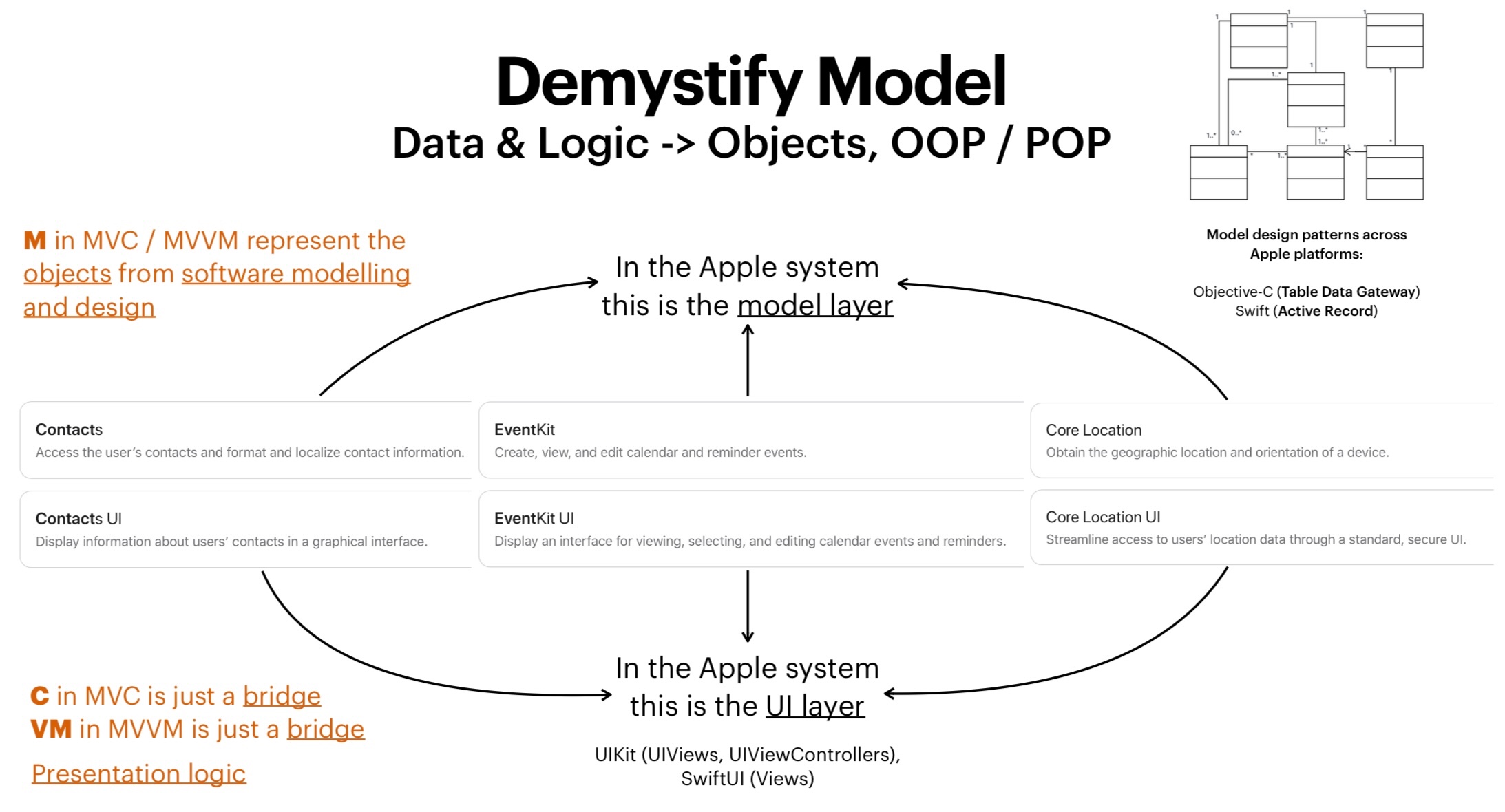

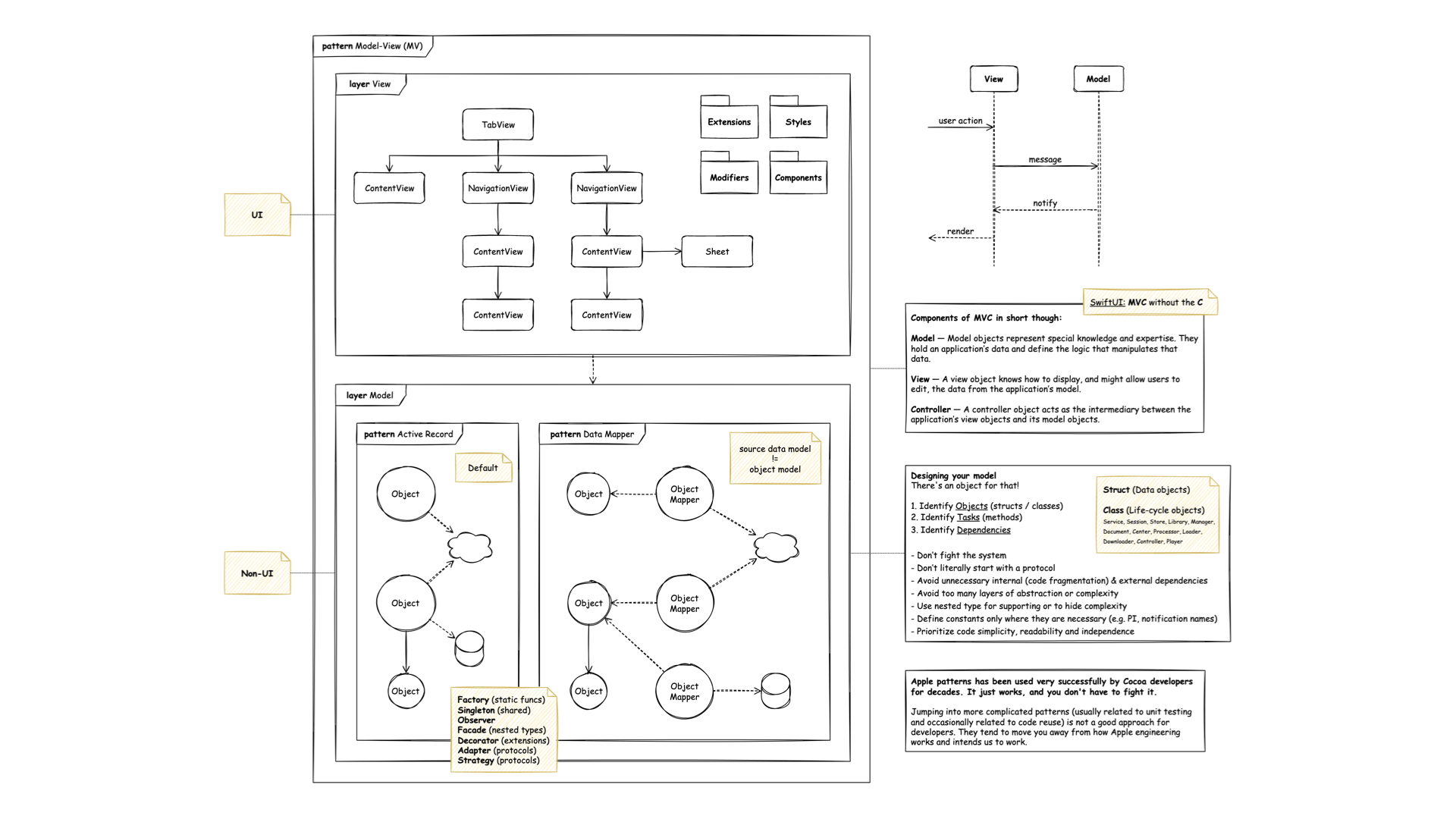

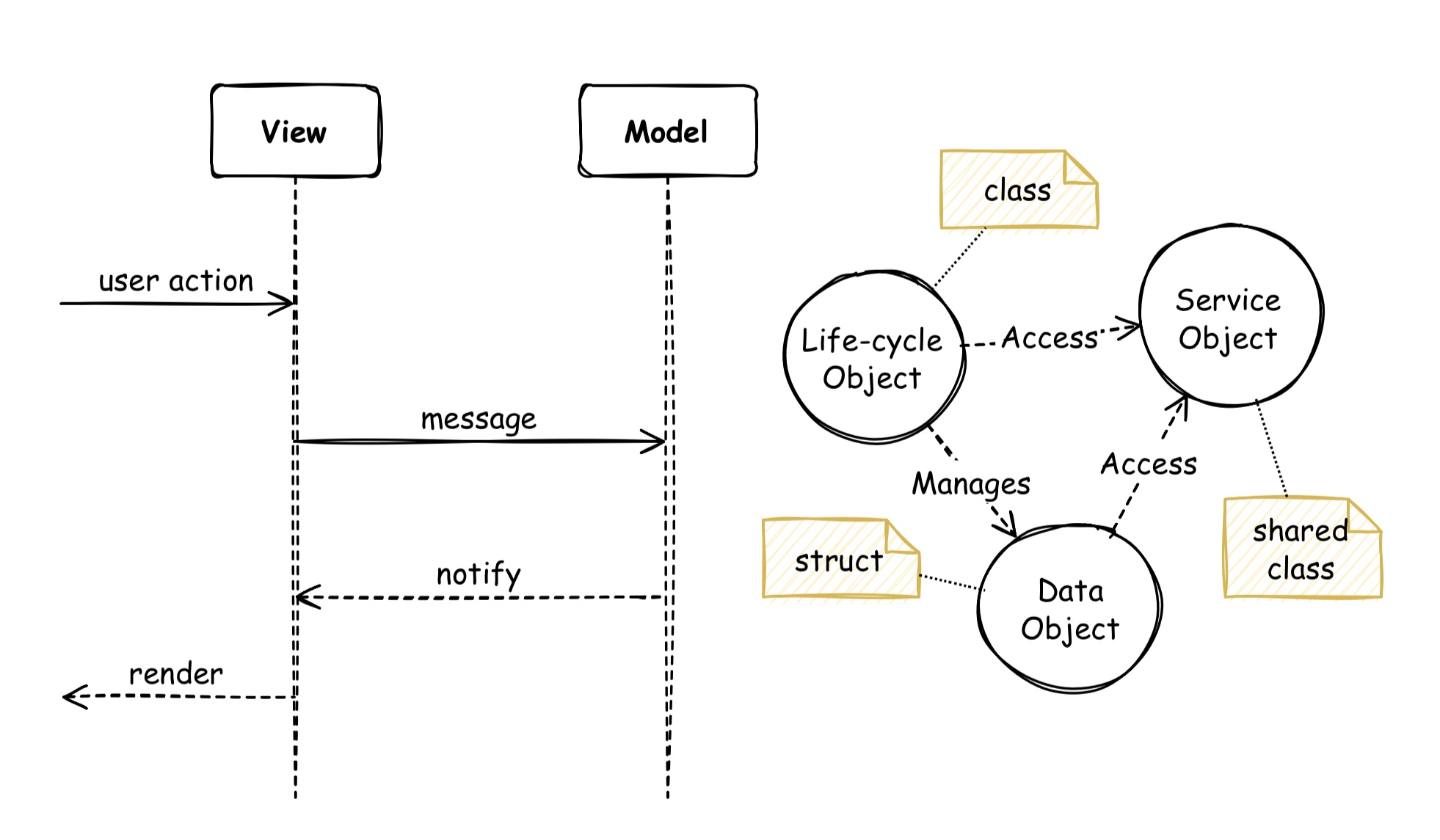

Model (Data / Networking / Algorithms) objects represent special knowledge and expertise. They hold an application’s data and define the logic that manipulates that data.
The model layer is not simple structs (POJOs). A model is a system of objects (structs / classes) with properties, methods and relationships. For simple apps we can define one model, for complex apps we can have many models as needed (and makes sense).
Popular Model design patterns: Active Record, Data Mapper and Factory Method are the key' to avoid massive ViewControllers / ViewModels (and unnecessary layers).
See “The Features of the Main Data Access Patterns Applied in Software Industry” by Marcelo Rodrigues de Jesus
Model is everything your app (or part / system) can do, in a pure OOP. View is just an interaction layer and handle presentation logic.

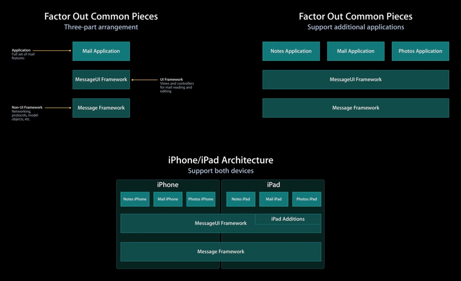

See WWDC2010 Session - MVC Essential Design Pattern for Flexible Software See StoreKit 2 documentation for an example of the model of In-App Purchases. See MusicKit documentation for an example of the model of Music Catalog.
Normally Apple split frameworks, but not exclusive, into (e.g.):
  • Contacts (non-UI, model layer)
  • ContactsUI (UI, view layer)

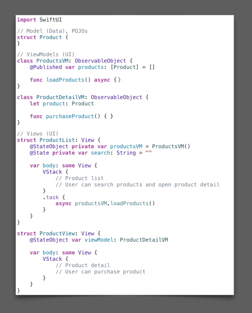

Part II

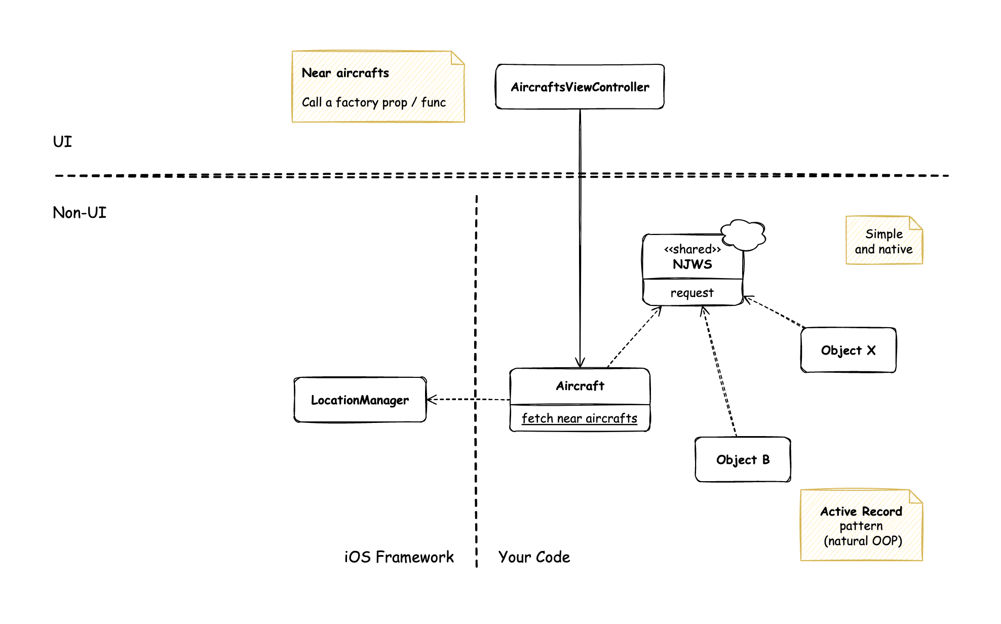

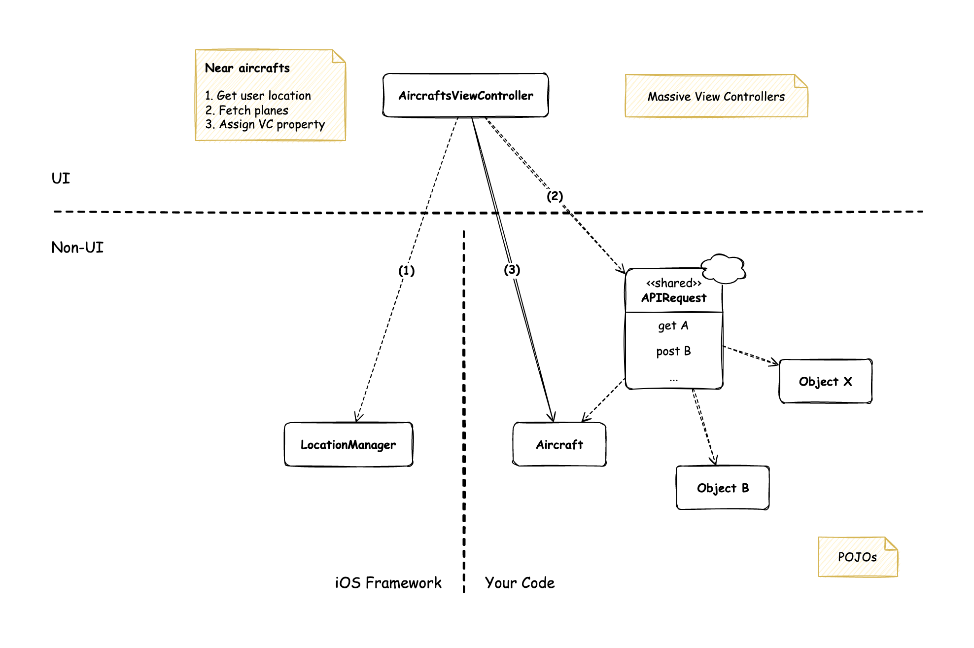

This is the reason for Massive View Controllers. When you define the model as POJOs (simple structs) you end with many logic inside the ViewControllers / ViewModels. VC and VM should only handle presentation logic. In many cases impossible to test non-ui. Also theres a bad dependencies on you non-ui code. To avoid this you end with unnecessary layers. And… you have to make change for multiplatform views.
But if you go OOP & software design patterns, everything will be perfect. Also, as you see, every object become independent because “Service Objects” just gives the access / door, don’t know what the other objects want. Whenever possible, each object should be concrete and independent. If we add / remove / move a object, the others should keeping working and remaining unchanged. Your model is ready for every platform views, terminal, tests, …
NOTE: Imagine the CLLocationManager using await / async, no delegates. And yes you can do an locations manager if need.
Hope new frameworks this WWDC from ground for Swift and Swift Concurrency.
CLLocation and CLLocationManager just become Location:
  • try await Location.current (gives current user location)
  • for await location in Location.updates (gives every locations changes, async sequence)

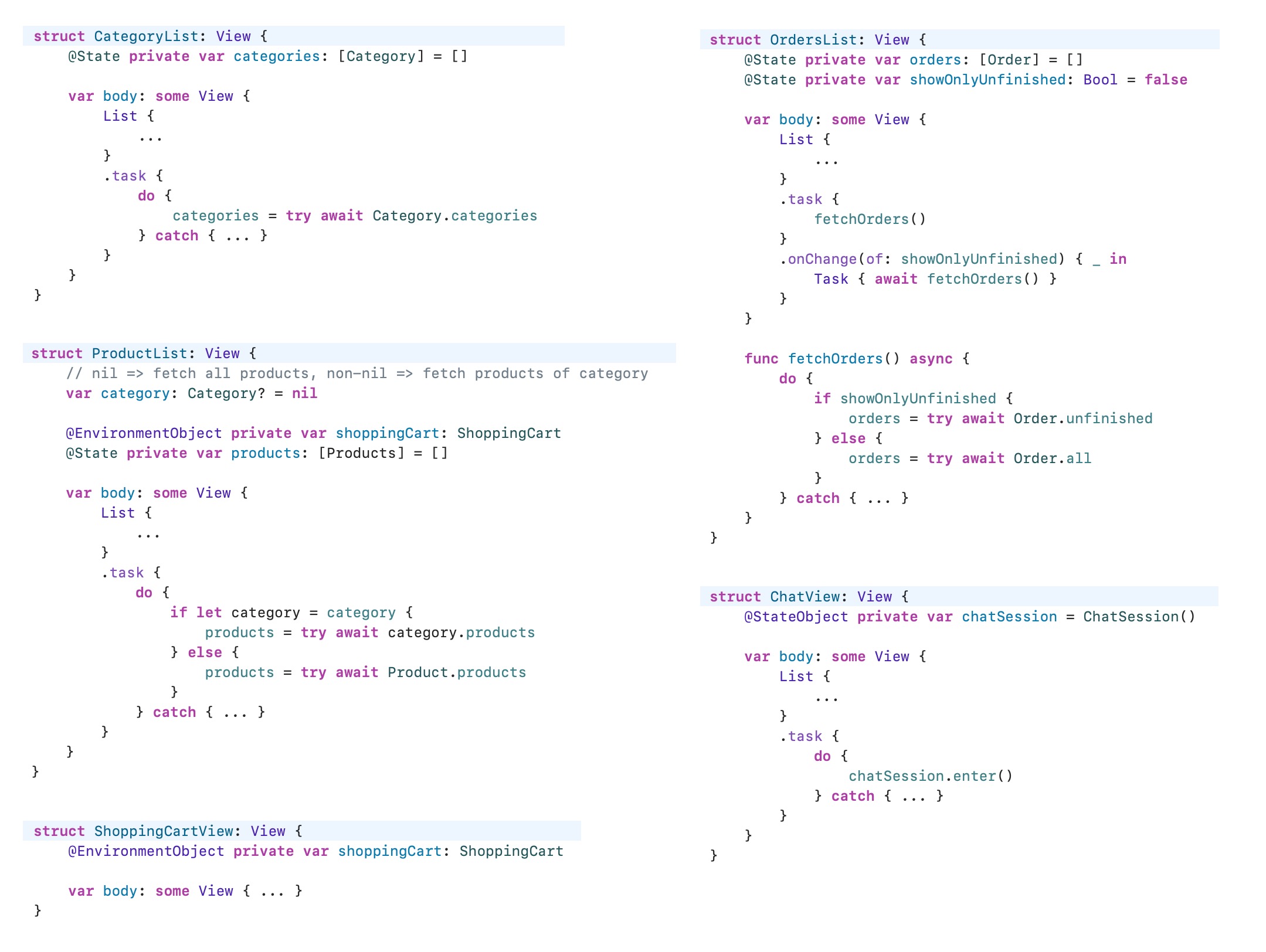

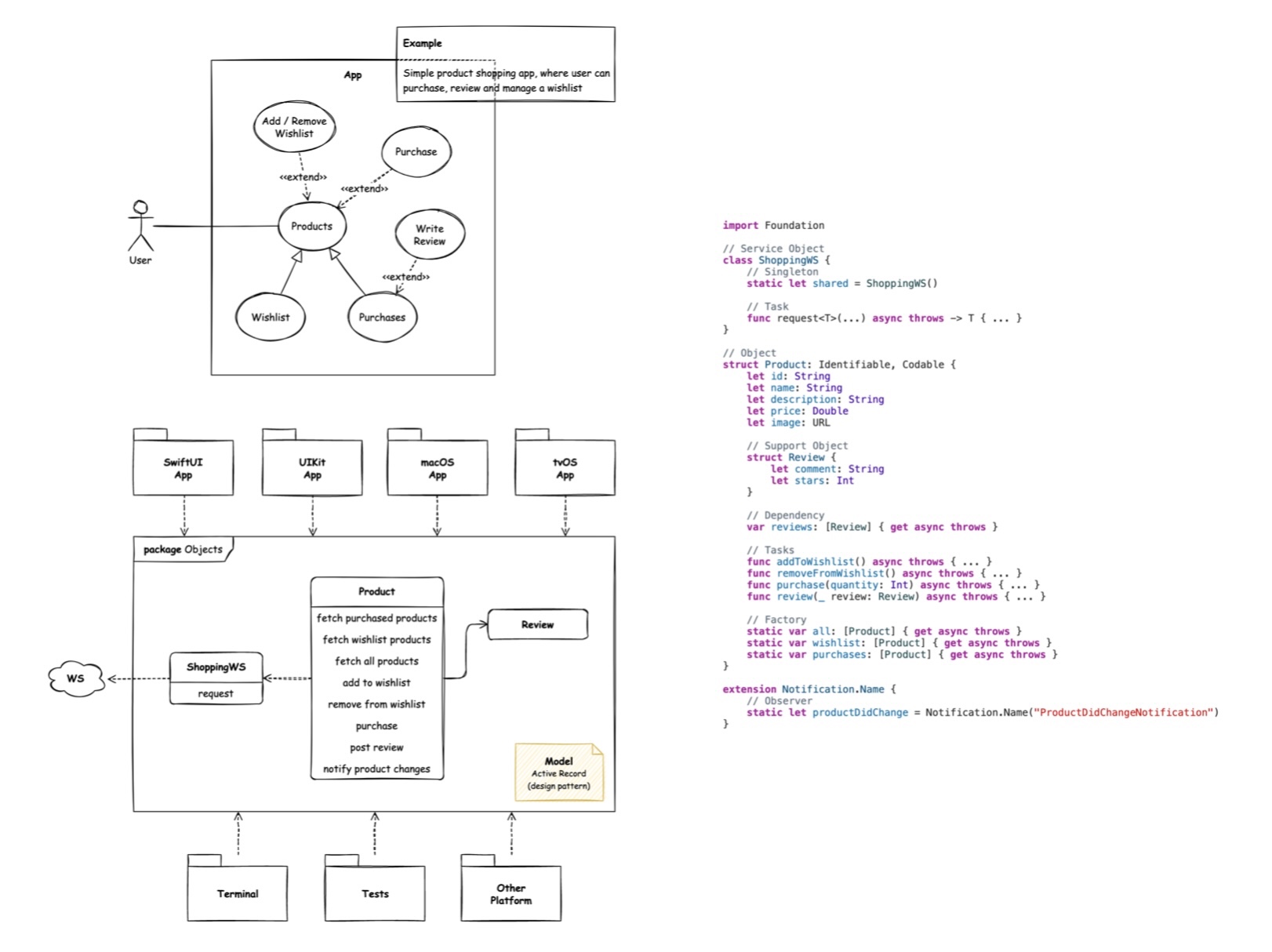

Shopping App

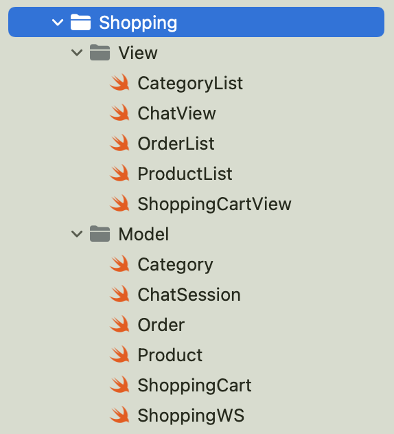

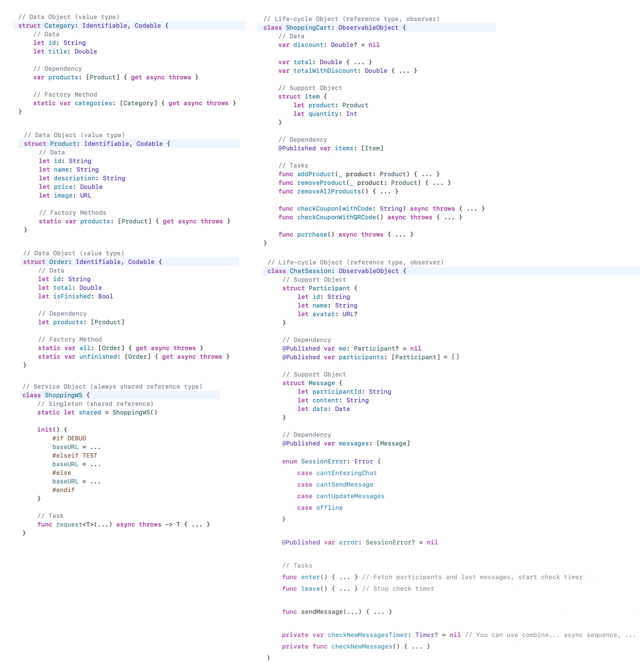

The Model Layer
KISS - Simple design become more easy to do, more easy to maintain / scale, more easy to find & fix bugs, more easy to test.
You can use in UIKit, SwiftUI, iOS, tvOS, macOS, Terminal, Unit Tests, …hey! You can make a Swift Package and share with other apps. It works like magic!
In a big app you can have more models “Workout model” + Nutrition model”, “LiveTV model” + “VideoOnDemand model” + “Network & Subscription model”, …
You can use the “TEST” (like DEBUG) flag for mocks, in WebService provider level but also in your factory methods. Also you can extend the provider and override the request method… there are 1001 ways to mock… but remember don’t sacrifice the simplicity for testing.

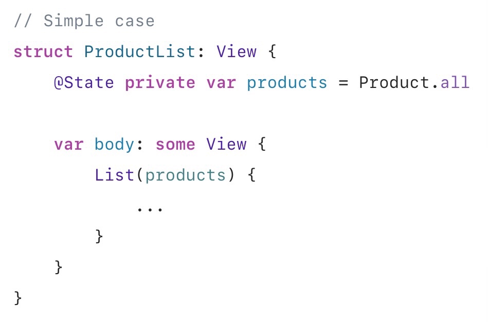

A view has a body and handle presentation logic.
SwiftUI automatically performs most of the work traditionally done by view controllers (and view models), but what about the other work like fetch states or pagination? SwiftUI is very good at composable / components and there are modifiers and property wrappers, just use your imagination and the power of the SwiftUI… yes you don’t need extra layers, in last resort make utility objects (e.g. FetchableObject) in your “Shared” folder. With Swift Concurrency everything becomes easy to use and to reuse.
@AsyncState private var products: [Product] = []
List { … }
.asyncState(…)
Example of fetch state property wrapper + modifier.

I understand your concerns but in case of SwiftUI (declarative) the “MVVM” (original from 2005) is not the correct approach. Maybe the problem is people calling ViewModel and MVVM.

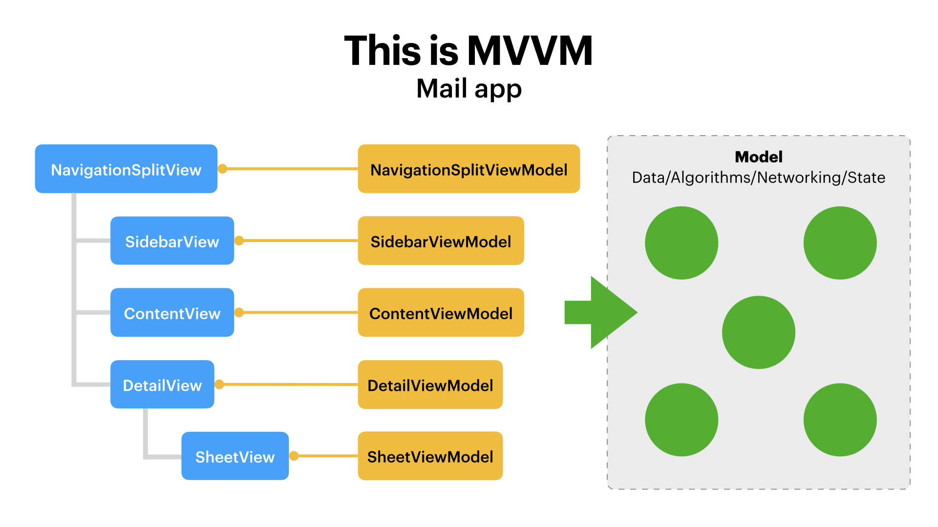

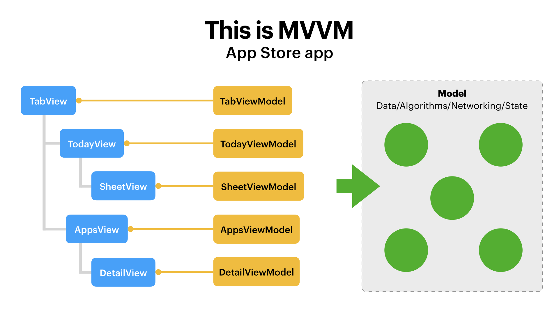

Let me explain, in MVVM almost every View most have a ViewModel, basically you have a middle layer (data binding). In SwiftUI (declarative) you don’t need that, in SwiftUI you can use the concept of “Store” to do the odd jobs. In fact this is a “model type” but we should avoid call ViewModel (and MVVM) because the conflict.

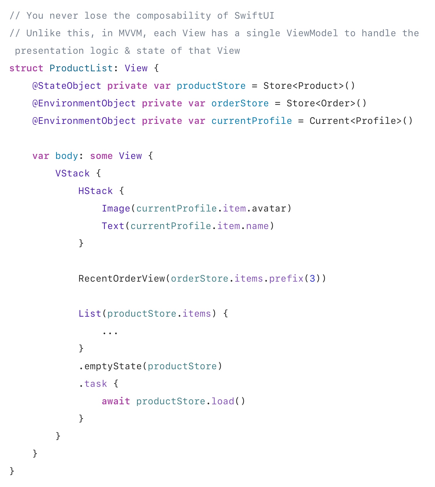

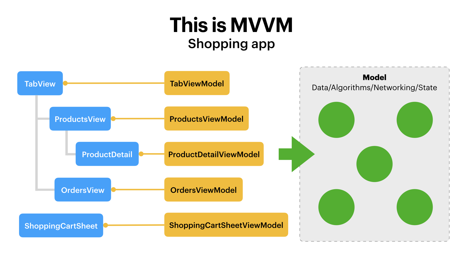

This is MVVM:
HomeView - HomeViewModel
ProductListView - ProductListViewModel
ProductDetailView - ProductDetailViewModel
ProfileView - ProfileViewModel

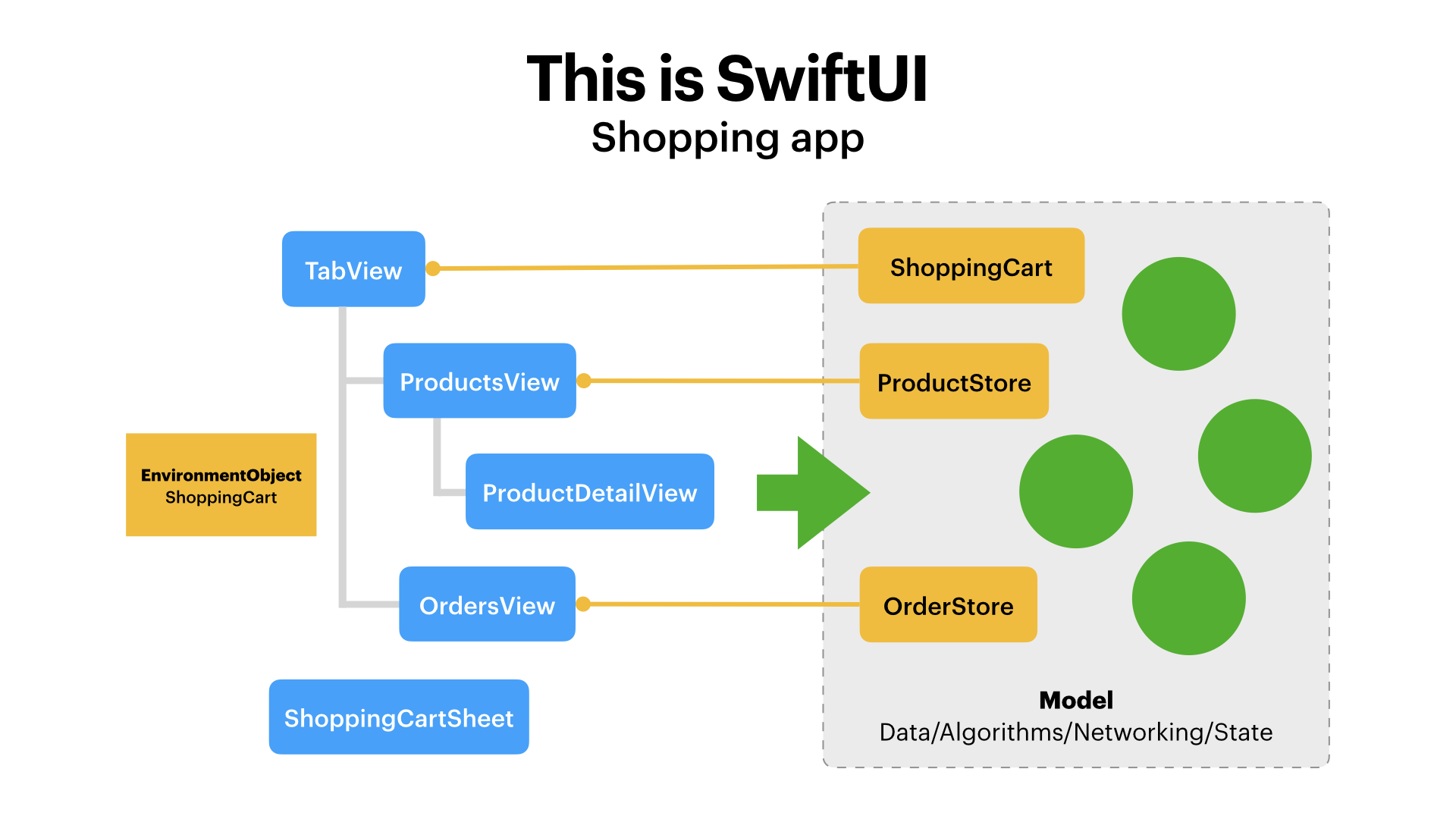

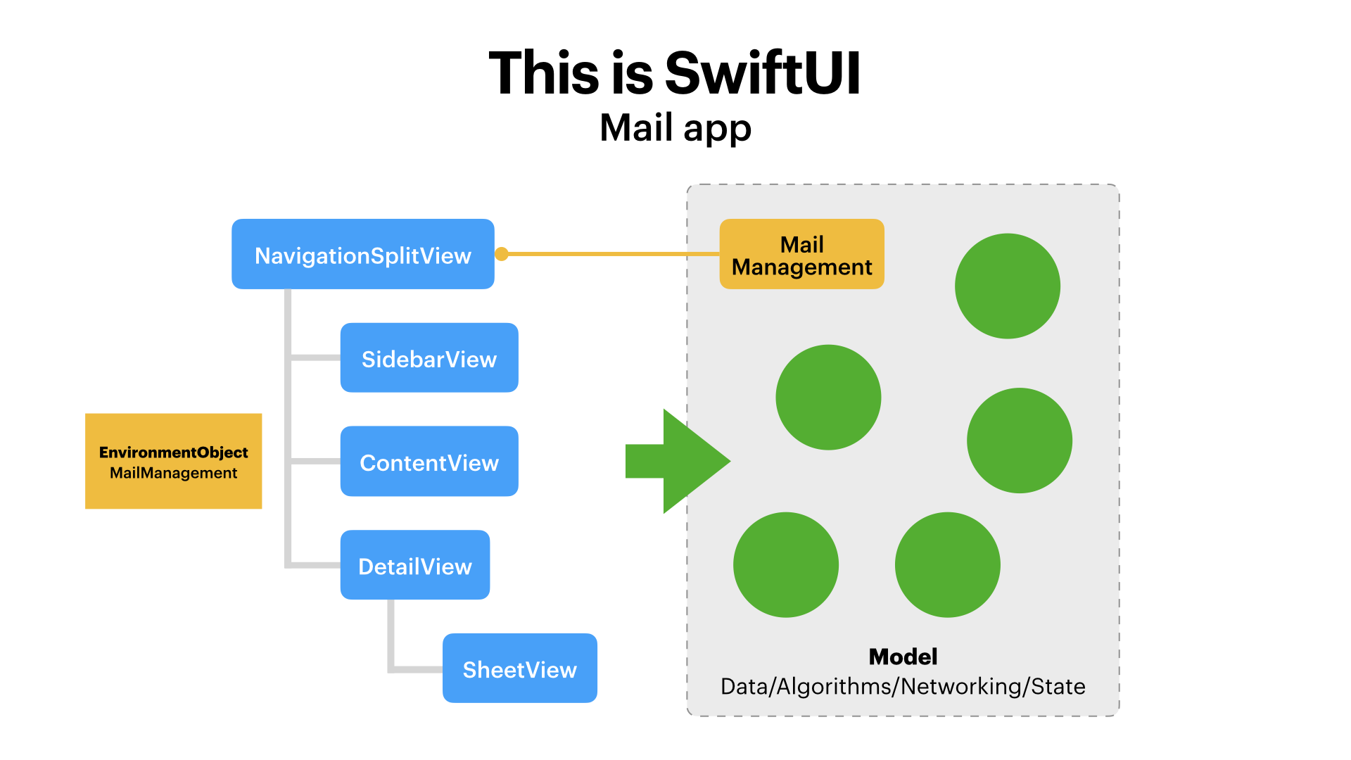

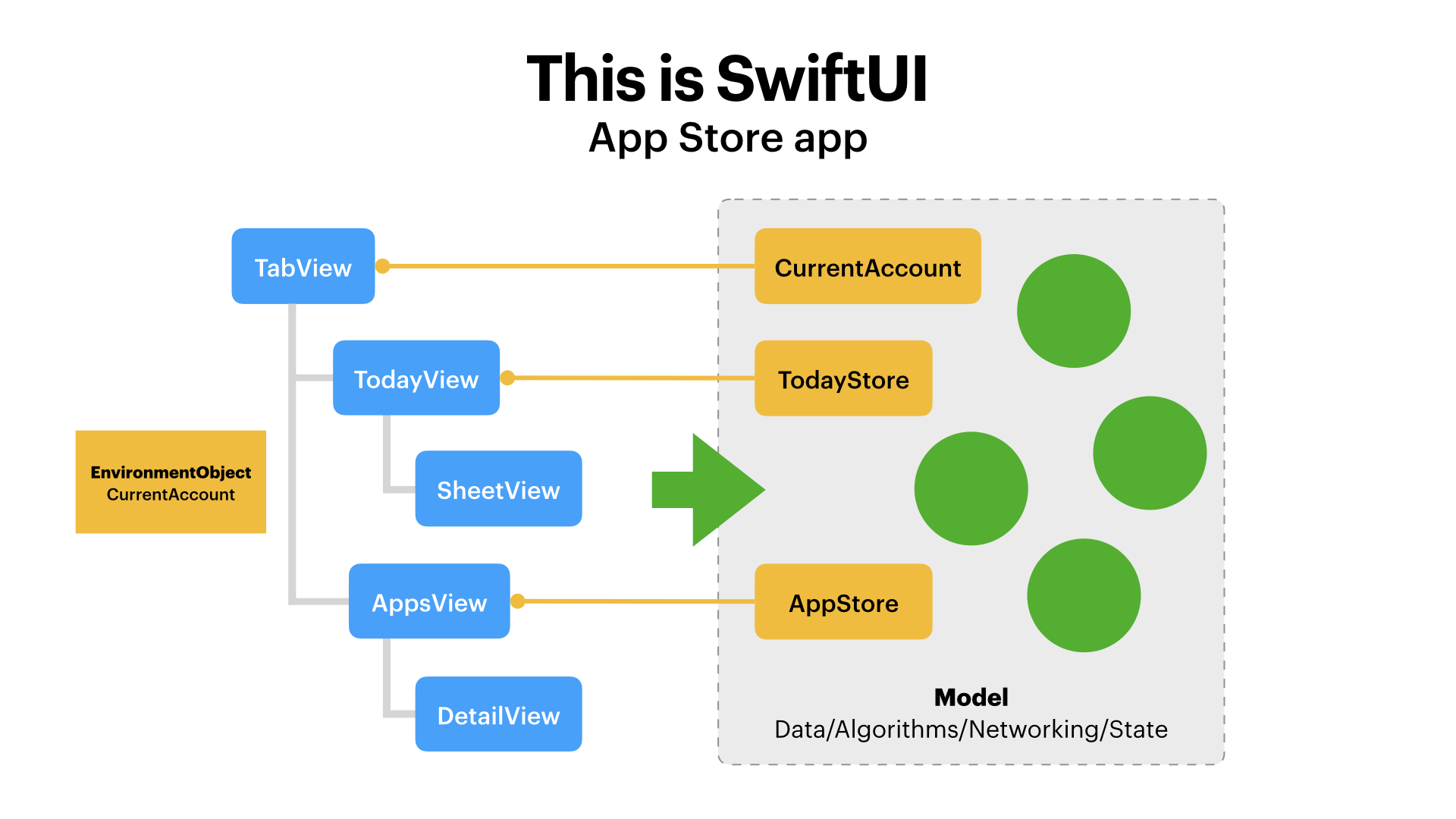

This is SwiftUI:
CurrentProfile (or in generic Current<Profile>)
ProductStore (or in generic Store<Product>)
AppState / NavigationState
HomeView
ProductListView
ProductDetailView
ProfileView

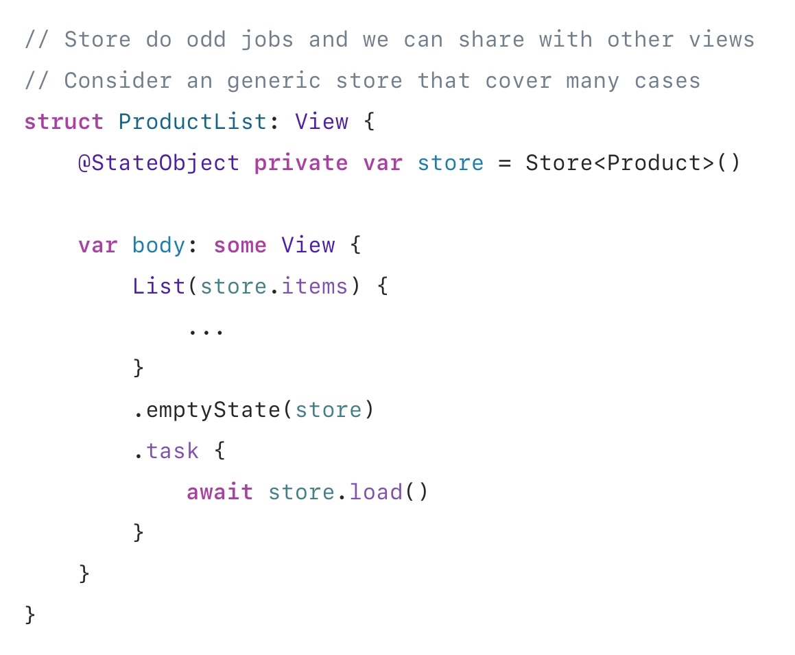

  1. Focus on the model (data + business logic)
  2. Create views that reflect the model
  3. If needed use a model type (e.g. Store) in your view layer to do odd jobs
But why I’m complain about the use of MVVM for SwiftUI? Because I worked for Microsoft platforms (community leader) and evangelist the MVVM from 2005.
SwiftUI is a modern UI framework and in the declarative world MVVM (original) feels unnecessary and very limited. The problem is people understand what MVVM architecture is in fact. Maybe they are just calling every non-view objects (e.g. store, state, current, …) ViewModels but this is not MVVM.

Mail app

Shopping app
