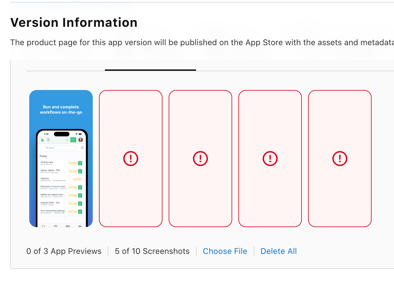

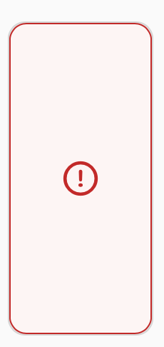

We have two sets of screenshot images for 5.5 and 6.5 displays of the iOS app which needs a new version. When I first uploaded the screenshot set for the 6.5 display, it looks all good. Then I uploaded another set for the 5.5 display and headed back to check 6.5 images. I found some of them reported errors IMAGE_TOOL_FAILURE.
Then I deleted all 6.5 screenshots, re-uploaded for the 6.5 display again. However, this time 5.5 had errors. It is like a loop. I tried tens of times.

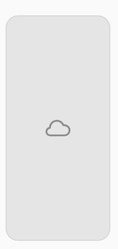

And, if I upload 6.5 first, it all looks good. And then I go to another tab, for example, the app information tab and then come back. I also find the images are marked as 'The file has been uploaded and is processing ' .

Same problem. I keep trying and eventually some of the screenshots appear to be accepted but others keep failing. Very frustrating.
Same problem here! Images that looked like they were successful randomly turn into red exclamation marks later. Images were saved with camera button from simulator. This is blocking us from submitting an important update.
