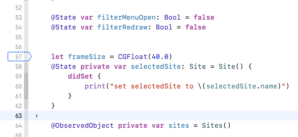

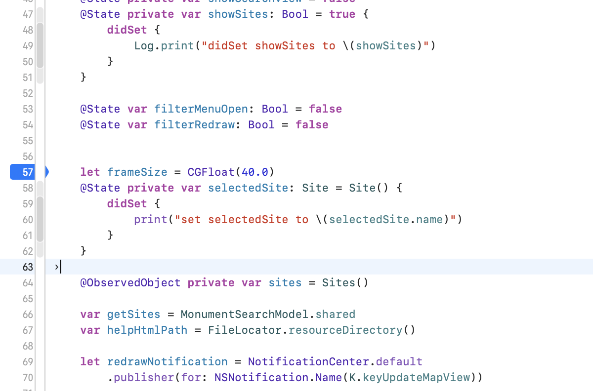

I think I can add screenshots only by answering (I'm no expert at these forums), so here goes: Screenshot of the code before starting the app in a simulator:
Once the app is running in the simulator:

I encountered the same problem, but luckily was able to hit a different breakpoint at a later point in the same flow. I moused over the outlined breakpoint and saw the following tool tip:
Xcode won't pause at this breakpoint because it has not been resolved.
Resolving it requires that:
  • The line at the breakpoint is compiled.
  • The compiler generates debug information that is not stripped out (check the Build Settings).
  • The library for the breakpoint is loaded.
