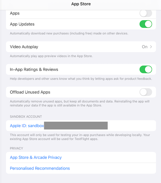

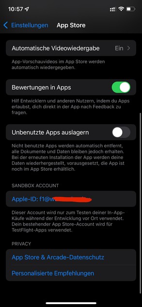

I'm using TestFlight to test an app with payment/subscription functionality. I created sandbox accounts in AppStore Connect accordingly to be able to test the subscriptions. I'm logged in with the sandbox account.

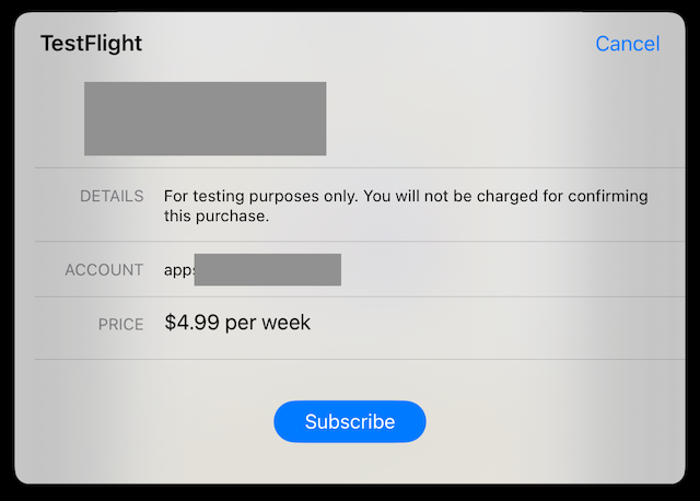

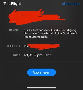

When I try to subscribe in the App the wrong account (this is my actual real AppleID) is used for the subscription although it is recognized that this is just a sandbox subscription. I tried: logging off/on into the sandbox account creating a totally new sandbox account trying to trigger the payment with no logged in sandbox account The result is always: in the payment popup it is stated that the purchase account will be my original AppleID and not a sandbox account. How can I switch the accounts? Is this a bug at Apple's side somehow?

TestFlight does not use Sandbox Apple ID’s created in App Store Connect, those are only used for apps locally distributed/signed. While TestFlight effectively uses sandbox behind the scenes, it just uses your regular Apple ID. Your production Apple ID is not charged nor will you see these transactions in your purchase history, invoices, etc. - prod and TestFlight are fully independent.

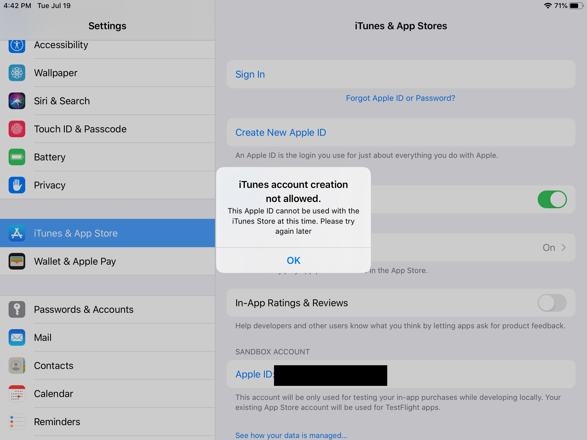

I've been experiencing the same issue. I've created multiple sandbox testers. However, when performing a purchase, it's using the apple id instead of the sandbox login. If I log out from the "iTunes & App Store" with my apple id and use the sandbox tester email, I get the "iTunes account creation not allowed" error.

Facing the same issue. App ignores my sandbox account during test in-app purchases and use my real appleId.
