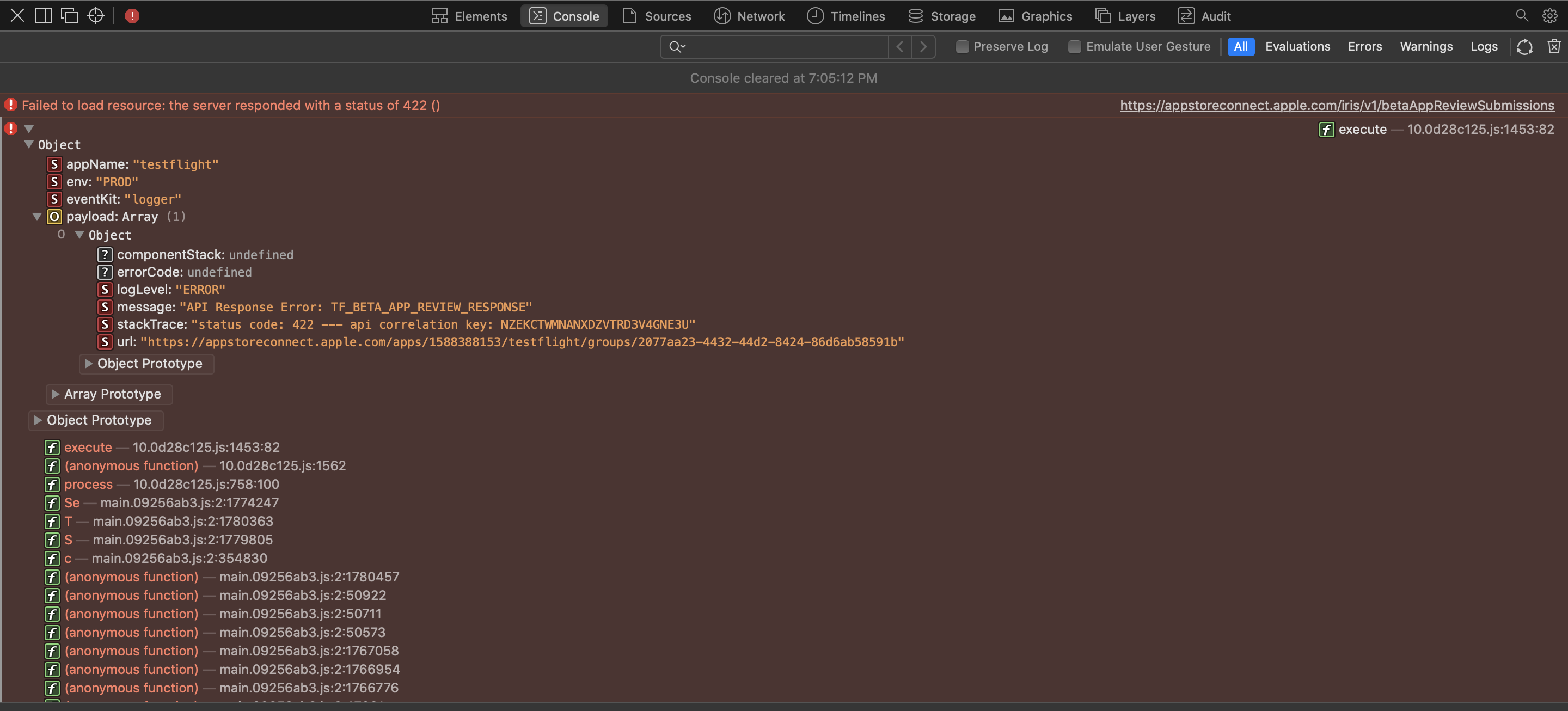

422 error when submit TestFlight Beta Review
When I submit the app to TestFlight beta review I get the error show on UI. (I filled all filed info in Beta Infomation)
There was an error processing your request. Please try again later
I was inspected Safari to see the detailed error and I got the below error.
Failed to load resource: the server responded with a status of 422 ()
and the detailed javascript error
componentStack: undefined
errorCode: undefined
message: "API Response Error: TF_BETA_APP_REVIEW_RESPONSE"
stackTrace: "status code: 422 --- api correlation key: NZEKCTWMNANXDZVTRD3V4GNE3U"
Anyone can tell me the problem and how to fix it. Many Thanks.
The image detail of error here.
I get the error response from api https://appstoreconnect.apple.com/iris/v1/betaAppReviewSubmissions
