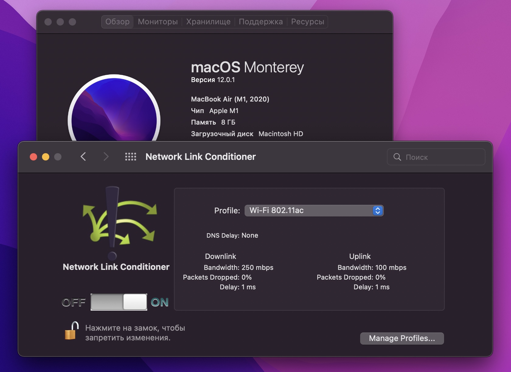

Also does not work on Monterey 12.0.1
Same here Monterey 12.0.1 / XCode 13.1 (13A1030d)
I have the same issue on Big Sur 11.6 with Xcode 13 and the workaround using the tool in "Additional Tools for Xcode 12.5" worked for me.
I have the same issue on Monterey 12.0.1 with Xcode 13.5 and the workaround using the tool in "Additional Tools for Xcode 12.5" worked for me!!!!!!
