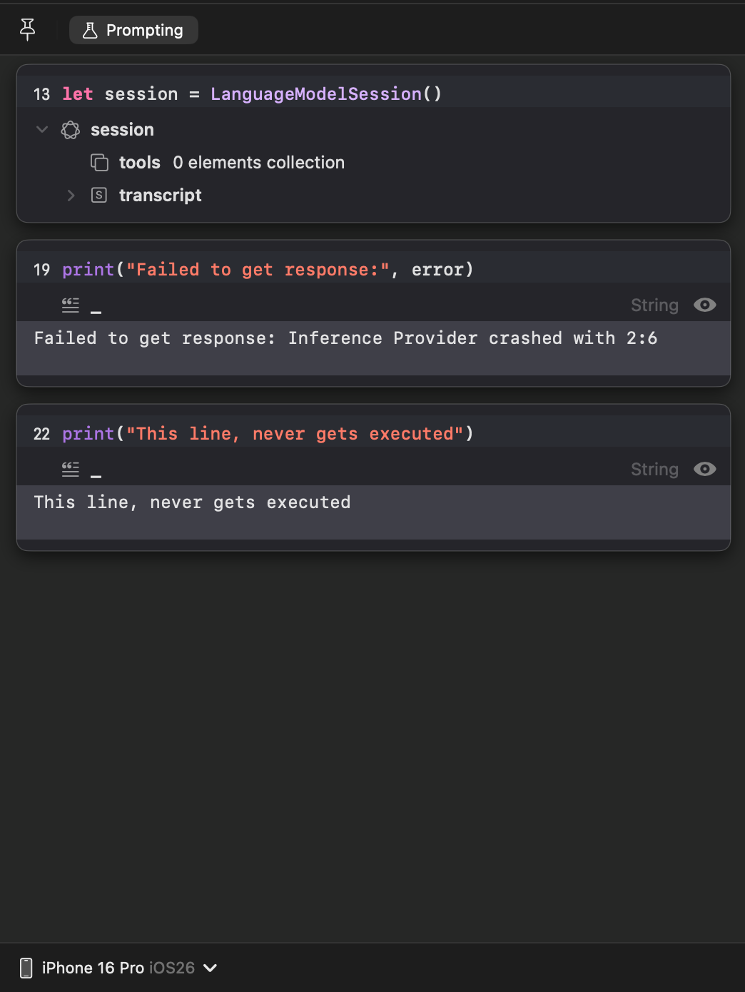

I created a new blank iOS project, set the deployment target to iOS 26, and ran the following minimal code using Foundation Models. However, I get no response at all in the output - not even an error. The app runs, but the model does not produce any output.
#Playground {
    let session = LanguageModelSession()
    let response = try await session.respond(to: "Tell me a story")
Then, I tried to catch an error with this code:
#Playground {
    do {
        print(response)
    } catch {
        print("Failed to get response:", error)
    print("This line, never gets executed")
And got these results:

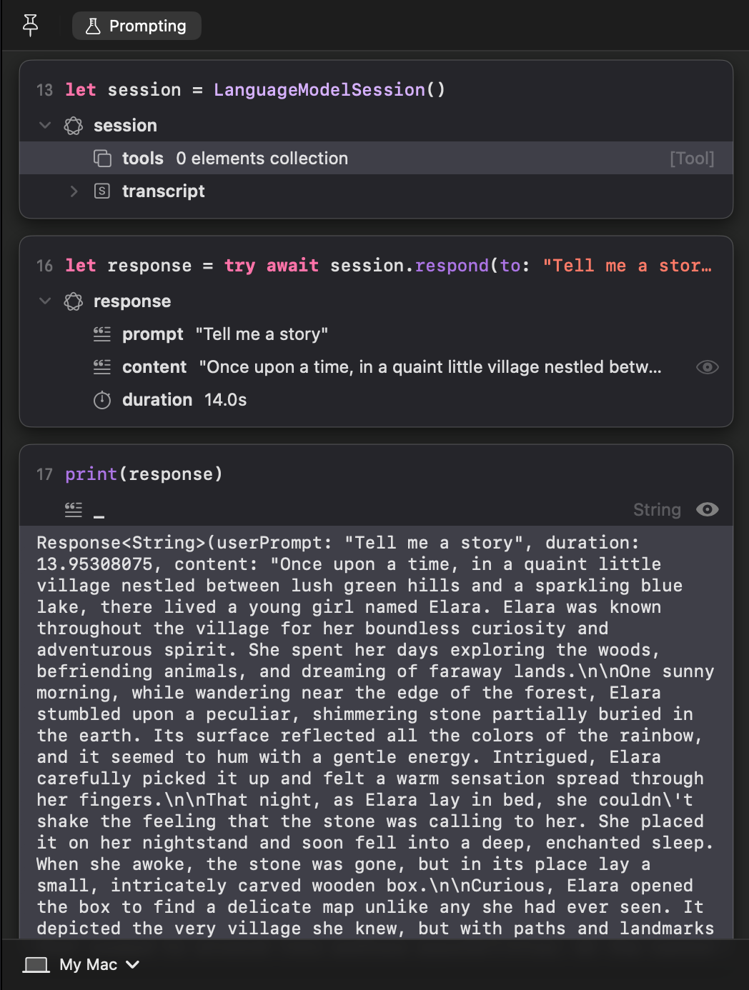

I tried running the Code Along sample project, and there the #Playground macro worked without issues. The only significant difference I noticed was the Canvas run destination:
  • In my original project, I was using iPhone 16 Pro (iOS 26) as the run target in Canvas. Apple Intelligence was enabled on the simulator, but no response was returned when executing the prompt.
  • In the sample project, the Canvas was running on My Mac.
I attempted to match that setup, but at first, my destination was My Mac (Designed for iPad), which still didn’t work. The macro finally executed properly once I switched to My Mac (AppKit).
So the question is ... it seems that for now, Foundation Models and the #Playground macro only run correctly when the canvas or destination is set to “My Mac (AppKit)”?

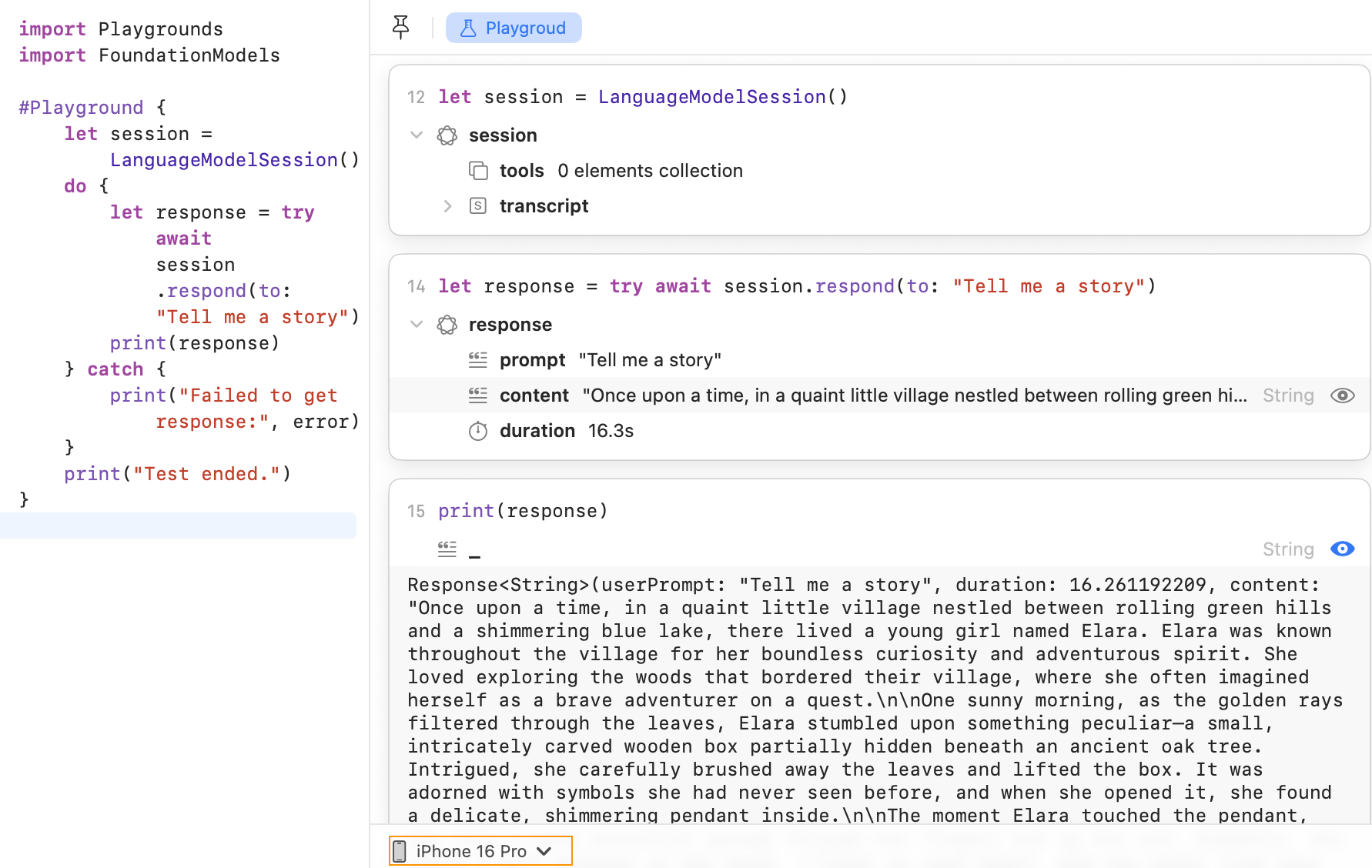

I'd like to be clear that the Foundation Models framework and #Playground do support iOS simulators, and I've confirmed that the code snippet provided above works with my following configuration, as shown in the attached screenshot:
  • MacBook Pro with Apple M4 chip.
  • macOS 26.0 Beta (25A5295e), Apple Intelligence is enabled and works.
  • Xcode 26.0 beta 2 (17A5241o)
  • The iOS simulator: iPhone 16 Pro (23A5276e)
I can't explain why the error happens on your side though. One common-seen unsupported configuration is macOS 15.x + iOS simulator, which is not your case as you confirmed that you ran macOS 26 Tahoe.
You can double check if your configuration has any difference from mine – I am on Beta 2, and your Mac with the M2 chip should work. If the the problem is still there, I’d suggest that you file a feedback report with a sysdiagnose, and share your report ID here. See this post for how to provide actionable feedback for the Foundation Models framework.
