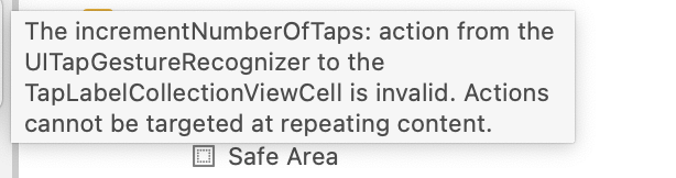

I connected a tap gesture recogniser to a label in storyboard by dragging a tap gesture recogniser object onto the label. When I connect the outlet to the gesture recogniser I get this error:
How can I connect the tap gesture recogniser in storyboard to my code?

You drag in the viewController, and try to apply to multiple objects (each cell's label: that's what "repeating content" means here). That cannot work as a gesture is attached to a unique object. So you need as many tapGestures as there are cells.
The simplest in your case would be to create the tap gesture in code, in the init of collectionCell.
Or try to declare the tapGesture in storyboard in the cell.

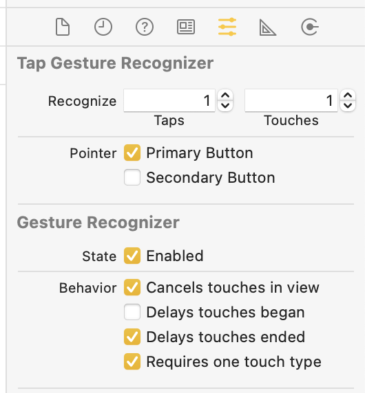

-> Could you show the attributes inspector of the tapGesture ?

It seems you have tried to connect the incrementNumberOfTaps action to the cell and not to the tapGesture.

Here is the image of the attributes inspector in storyboard for the tap gesture: I did not control drag the tap gesture to the label in storyboard, rather I dragged the tap gesture and placed it directly on top of the label.

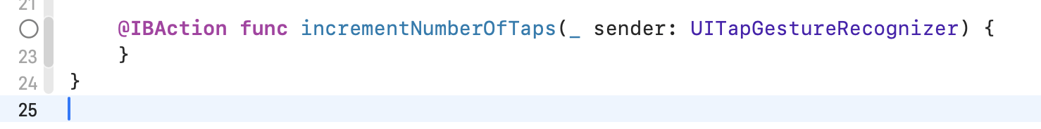

I control dragged from the tap gesture recogniser to the cell class where I dropped the label, and created the IBAction function called incrementNumberOfTaps when I did this:

    @IBAction func incrementNumberOfTaps(_ sender: UITapGestureRecognizer) {
The circle next to the @IBAction now appears empty.
