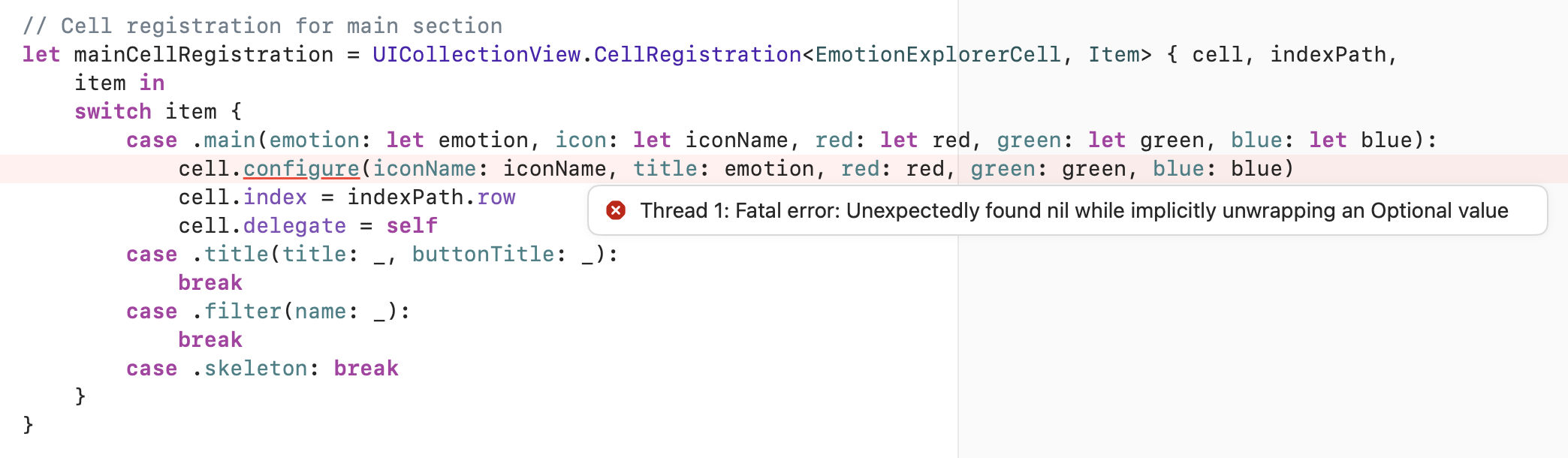

Upon checking if the delegate is nil, the delegate is not nil. However, when I reattempted to run the app I ran into this issue:
I am registering the cell using UICollectionView.CellRegistration in my view controller class and assigning cell.delegate = self inside this registration completion handler. My cell has a var delegate: EmotionExplorerCellDelegate? property, and inside the configure(iconName: String, title: String, red: CGFloat, green: CGFloat, blue: CGFloat) method in the cell is where I am calling delegate?.repromptLLMforIconName. Now it appears that my cell is nil inside my cell registration.

Could you also test with a log:
let mainCellRegistration = UICollectionView.CellRegistration<EmotionExplorerCell, Item> { cell, indexPath, item in
  print("cell", cell, indexPath, item) // <<-- ADD THIS
  switch item {
    case .main(emotion: let emotion, icon: let iconName, red: let red, green: let green, blue: let blue) :
      cell.configure(iconName: iconName, title: emotion, red: red, green: green, blue: blue)
      cell.index = indexPath.row
  case .title(title: -, buttonTitle:
