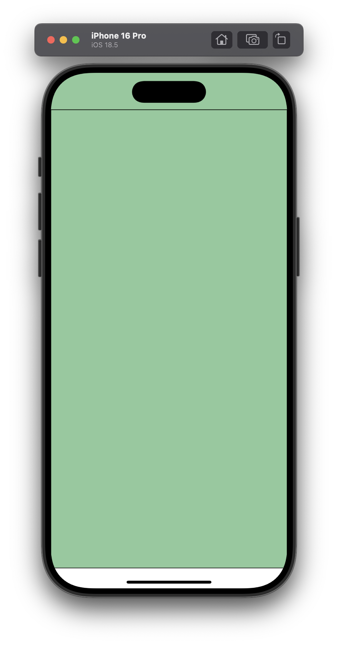

But there's a small gap in the bottom:

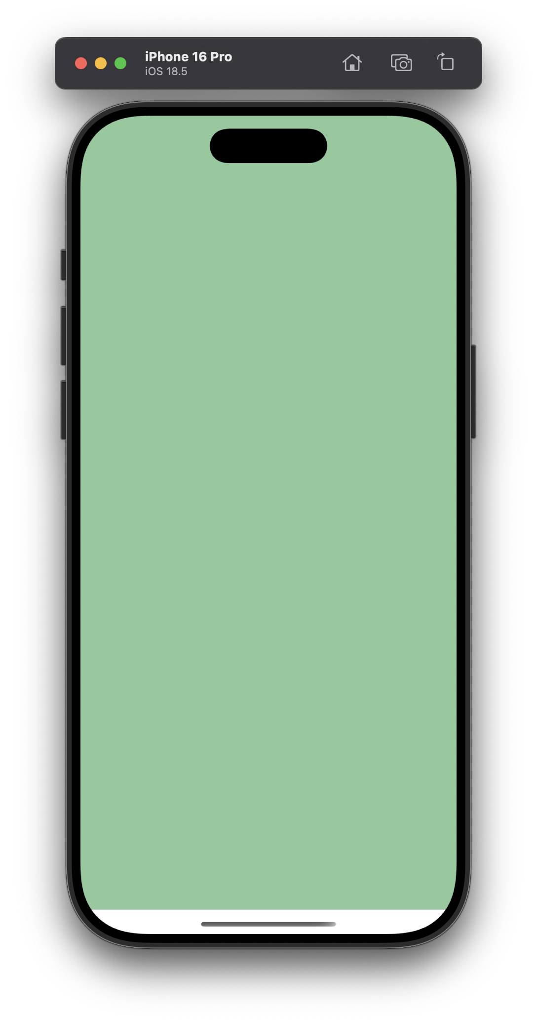

Swapping the order of scaledToFill and ignoresSafeArea fills this gap:
Image(.background)
    .resizable()
    .ignoresSafeArea()
    .scaledToFill()

Ignoring specific edges is more problematic:
struct ContentView: View {
        VStack {
        .statusBarHidden()
        .frame(maxWidth: .infinity, maxHeight: .infinity)
        .border(.black)
        .background {
            Image(.background)
                .resizable()
                .ignoresSafeArea(edges: .top)
                .scaledToFill()
My solution here was to use the Image as an overlay of a Rectangle.
Rectangle()
    .overlay {
        Image(.background)
            .resizable()
            .scaledToFill()
    .clipped()
Is there a better way to achieve this?

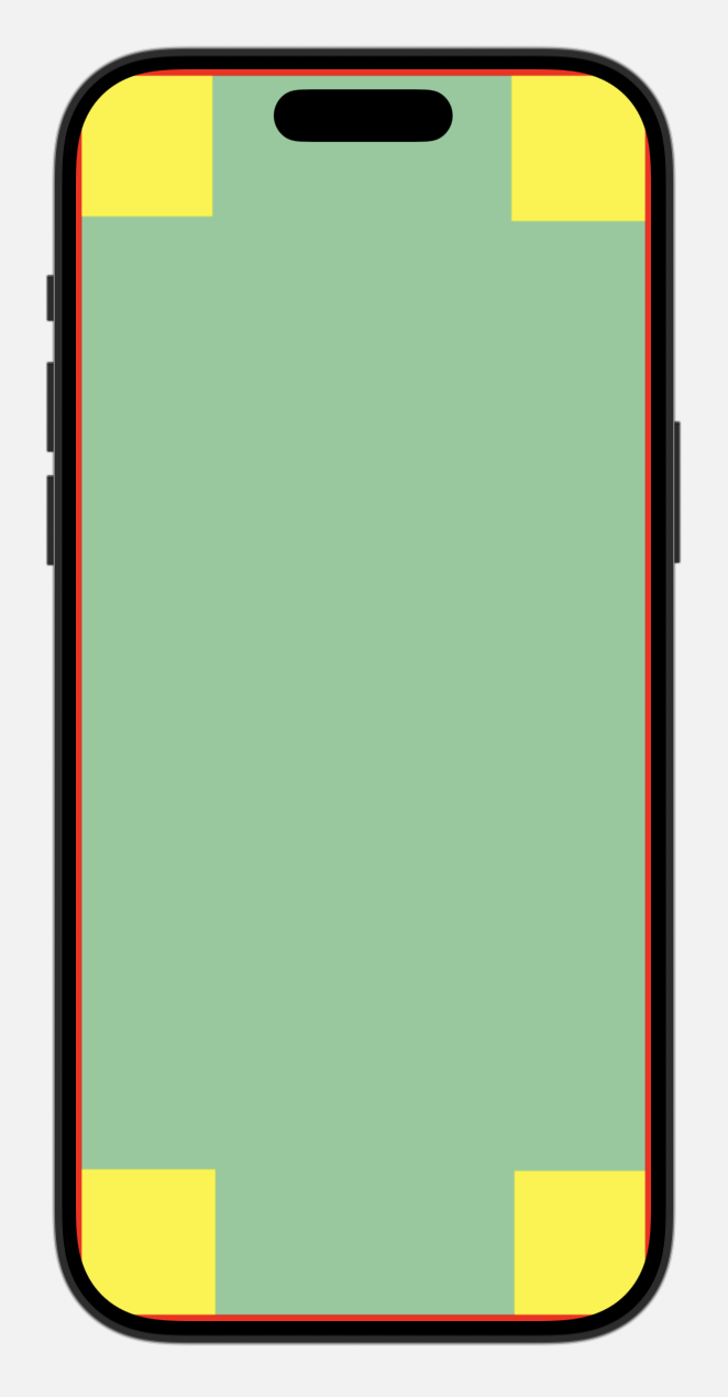

I took your image and added a red border and yellow squares in the corners so I could see where the image was stretched/resized and positioned. With the code above, you get this:
So you can see it was resized to fit inside the parent view, and doesn't ignore the safe areas.
For your needs, just remove the .scaledToFill() modifier, you don't need it:

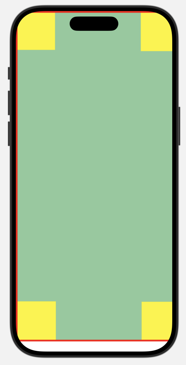

This yields:

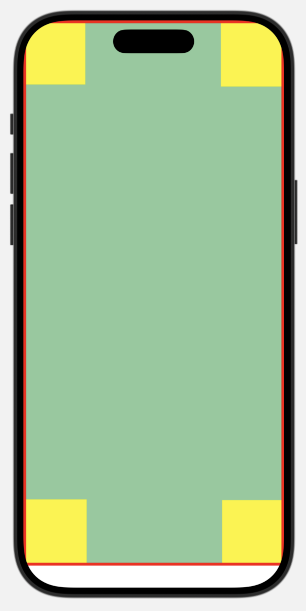

If your ultimate need is to get that last image with just the white bit at the bottom, the fix again is to remove the scaling:
Image(.background)
    .resizable()

I think my solid color image was a bad example because it works fine with just resizable() 😅 But a picture would be distorted without scaledToFill(). I've found another solution using an alignment value of background that is opposed to the ignored edges:
.background(alignment: .bottom) {
    Image(.background)
        .resizable()
        .scaledToFill()
Yeah, if it's not a solid colour it would need the scaling, but hopefully it makes sense to you now? The ordering of the modifiers is important.
