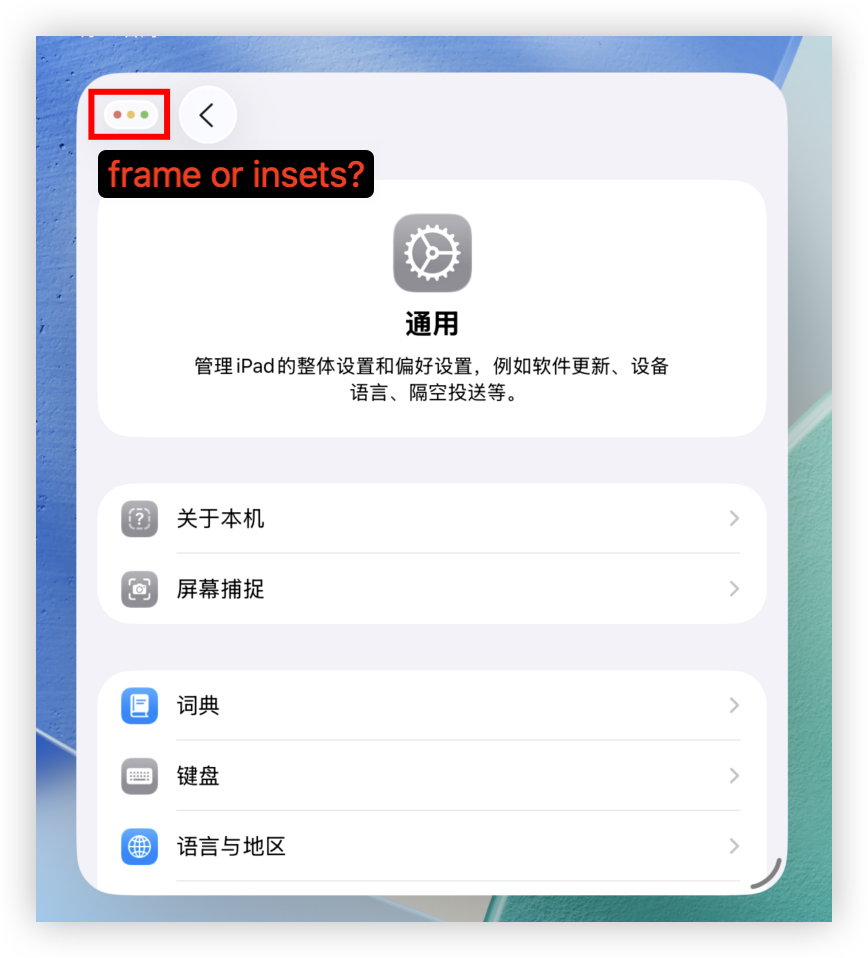

I have the same question. WWDC Sessions and the HIG mention "moving your controls" when the window control appears. It's great that this happens automatically when using a standard NavigationStack and standard toolbar, however for apps that are unable to use standard UI elements, the documentation currently makes it sound like there is some way to get this sizing programmatically.
Filed FB18559686

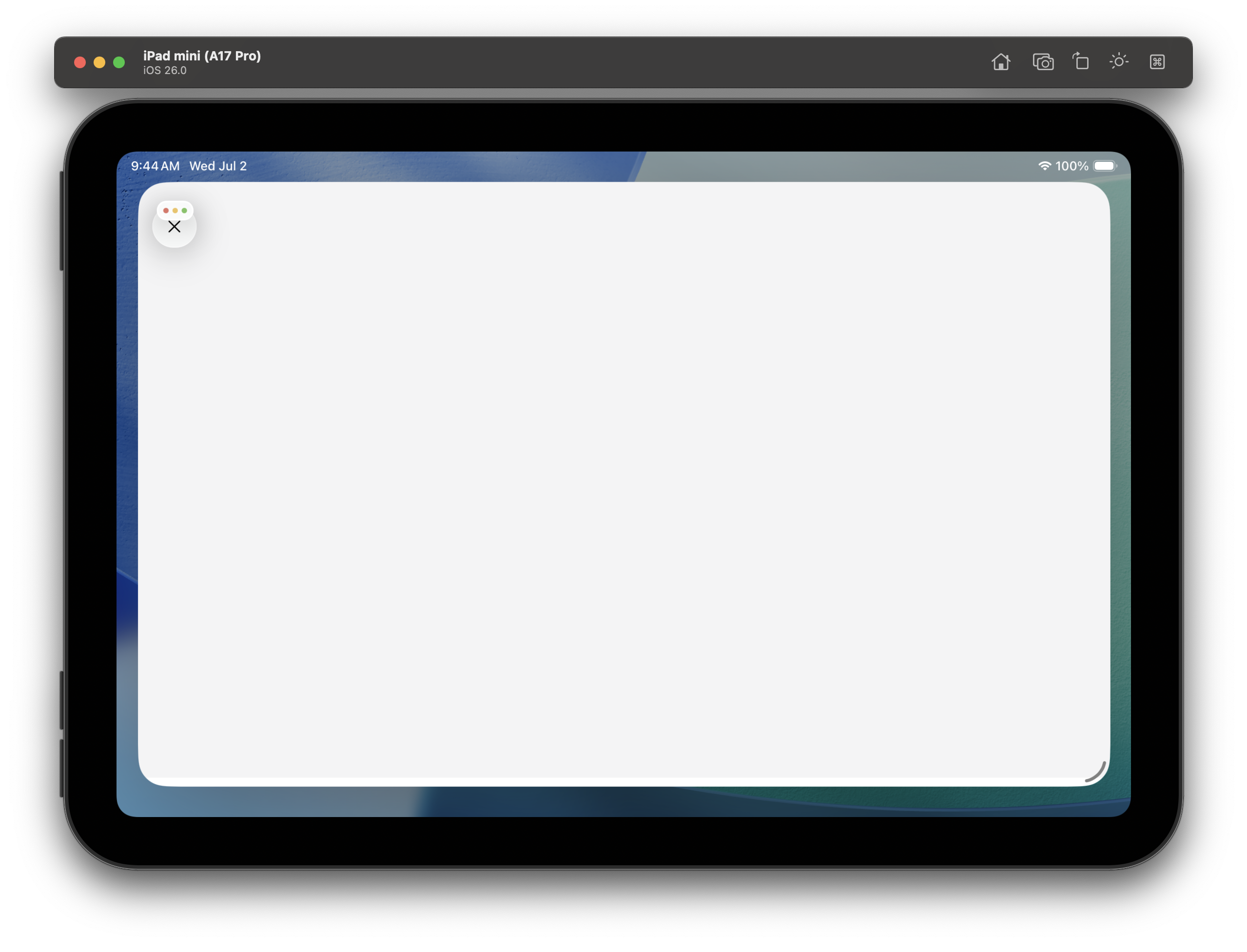

Screenshot of the issue:
Sample code to make this happen:
struct ContentView: View {
        VStack(spacing: 0) {
            HStack {
                // Trying to make this button respect window controls safe area
                Button(action: { }, label: {
                    Image(systemName: "xmark")
                .padding()
                .foregroundStyle(.primary)
                .glassEffect()
                Spacer()
            .padding()
            .background(.fill.quaternary)
            Rectangle()
                .foregroundStyle(.fill.quinary)
#Preview {
    ContentView()
