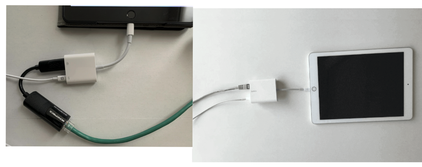

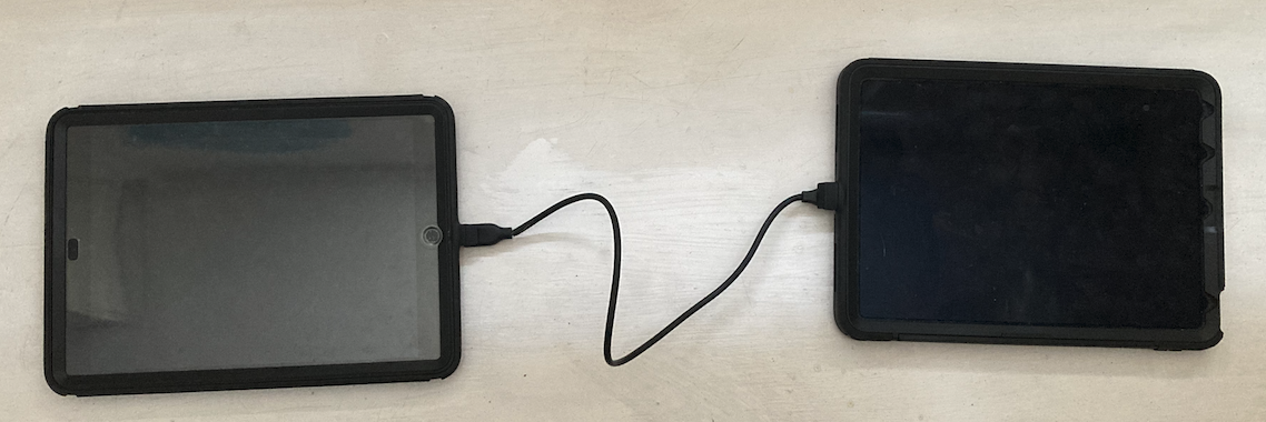

  2. If it's technically possible, I assume I would need to set requiredInterfaceType to wiredEthernet like you mentioned. After that, could the cable be a USB-C to USB-C as shown in the 1st attached pic? Or would it need to be an Ethernet cable as shown in the 2nd (contrived) attached pic?
No. USB-C doesn’t support an Ethernet-like protocol directly; you need those two Ethernet dongles.
