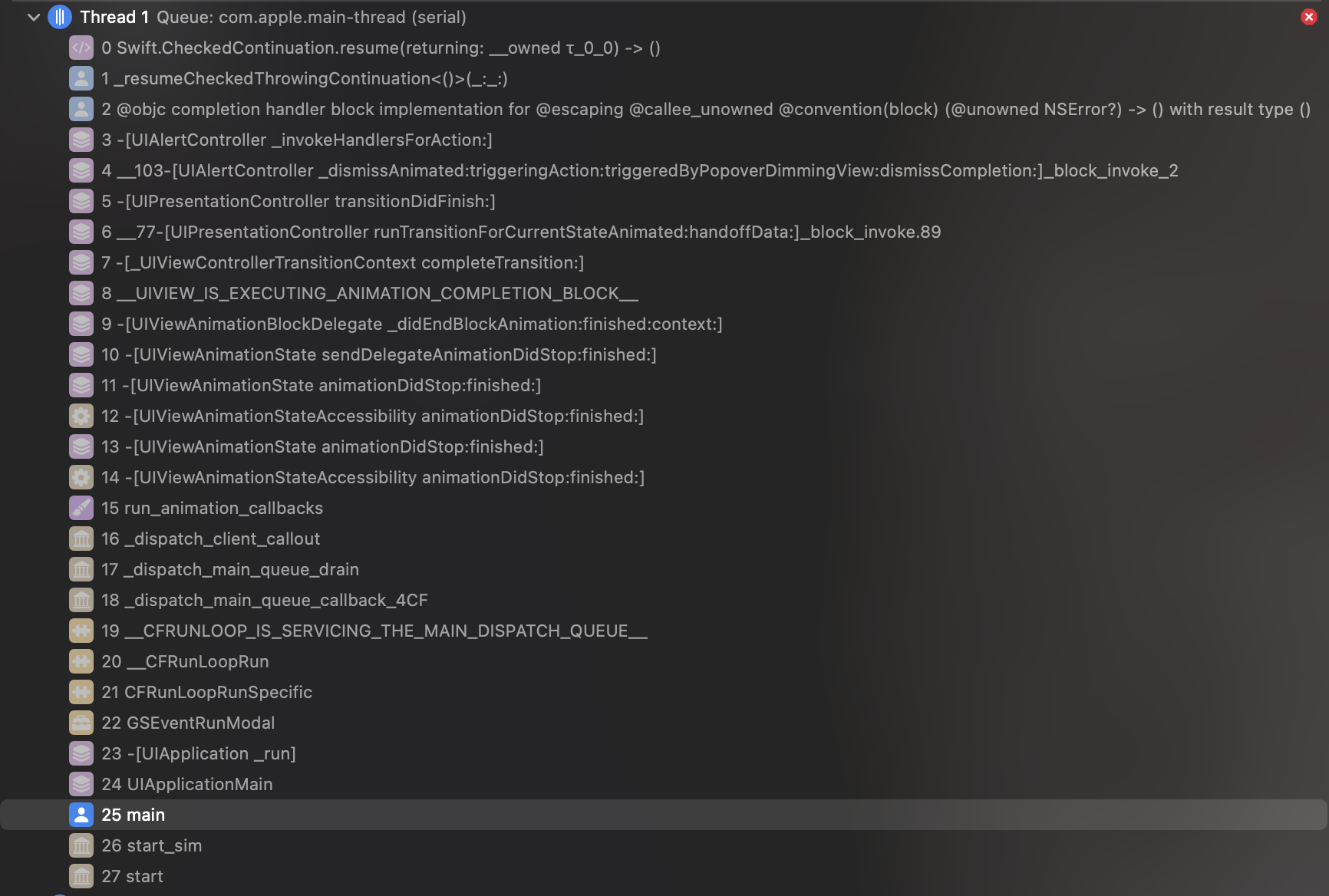

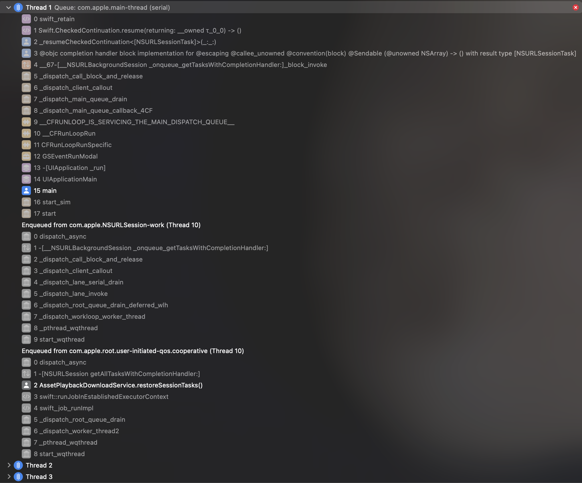

The async/await API crashes in Xcode 16.3 and later
We use several UIKit and AVFoundation APIs in our project, including:
Moreover, we use the Swift Concurrency versions for these APIs:
@MainActor
func setAlternateIconName(_ alternateIconName: String?) async throws
var allTasks: [URLSessionTask] { get async }
func loadMediaSelectionGroup(for mediaCharacteristic: AVMediaCharacteristic) async throws -> AVMediaSelectionGroup?
Everything worked well with these APIs in Xcode 16.2 and earlier, but starting from Xcode 16.3 (and in 16.4), they cause crashes. We've rewritten the APIs to use completion blocks instead of async/await, and this approach works.
Stack traces:
Also, I attached some screenshots from Xcode 16.4.
