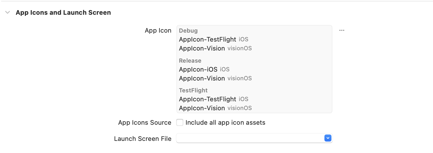

I have setup the App Icons here:

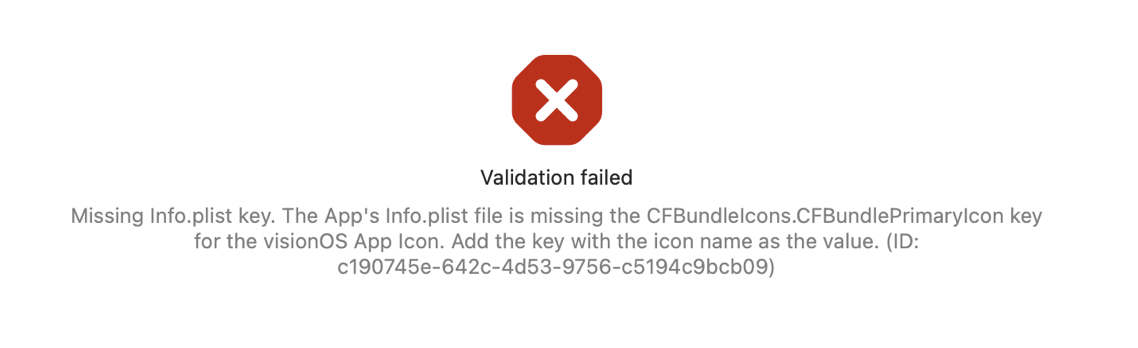

The validation error I first got was this, mentioning a plist entry (that has not been necessary in the past) is missing.

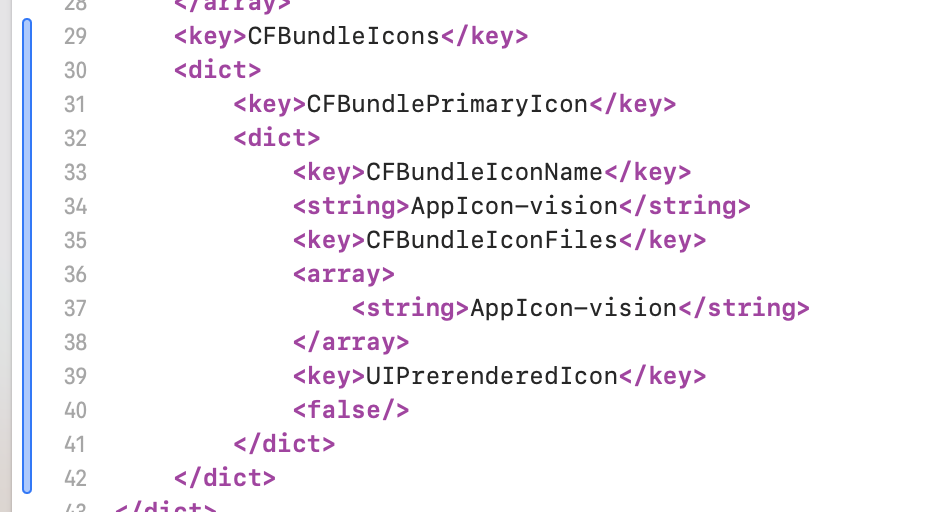

My info.plist now includes this, following the mentioned docs:

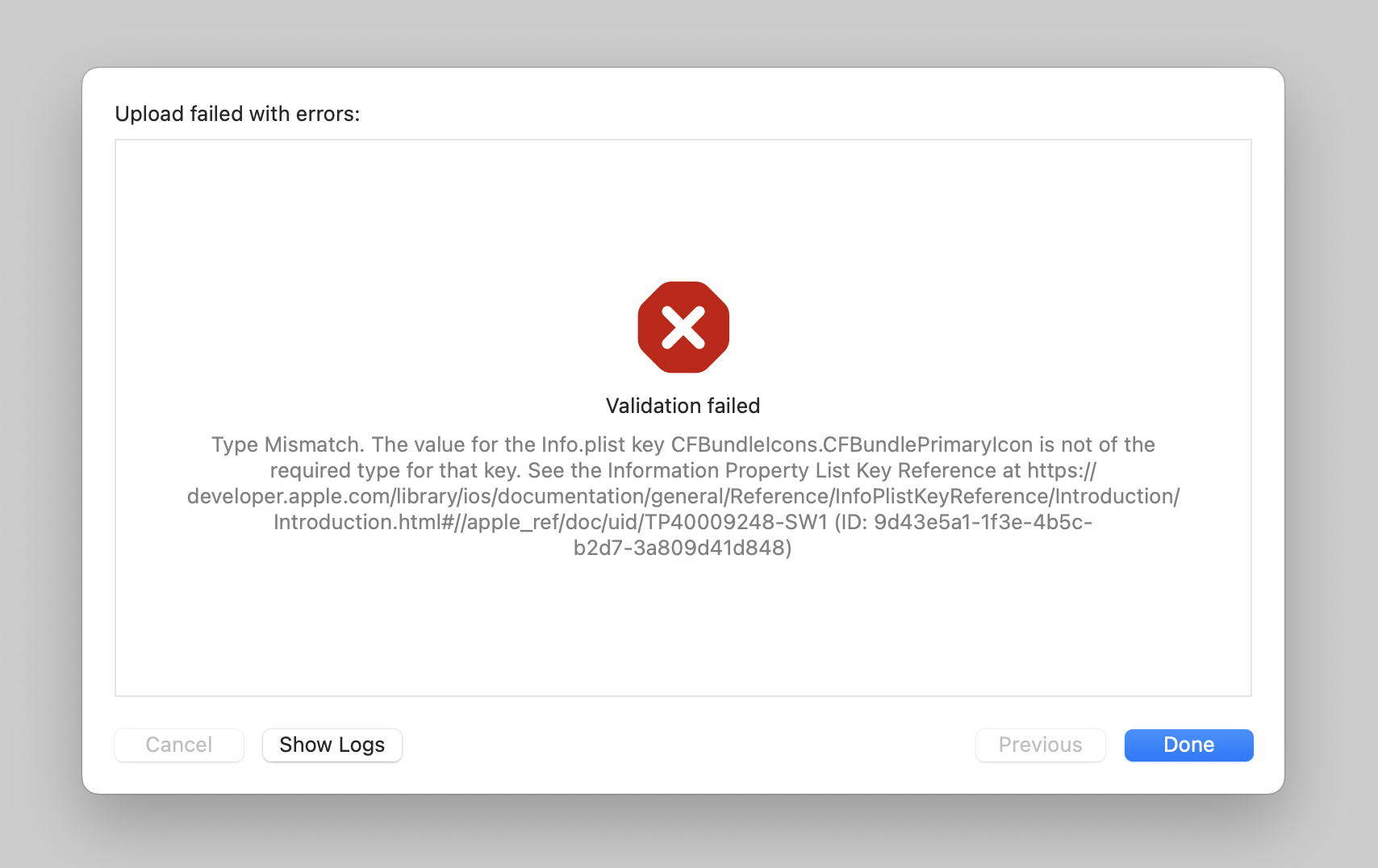

However, now I get a type missmatch error when validating — however the types are as described in the docs:

I've found the issue and it was quite simple, I did not need to add a .plist entry at all. The issue was that the name for the visionOS app icon asset specified in App Icon and launch screen used another name then the files in the asset catalog.
AppIcon-Vision and AppIcon-vision.
Leaving this here for reference. The only thing I can't understand is, I haven't changed any of those names, it just stopped working, but if you run into a similar issue, first think to check is spelling your your resource files!
