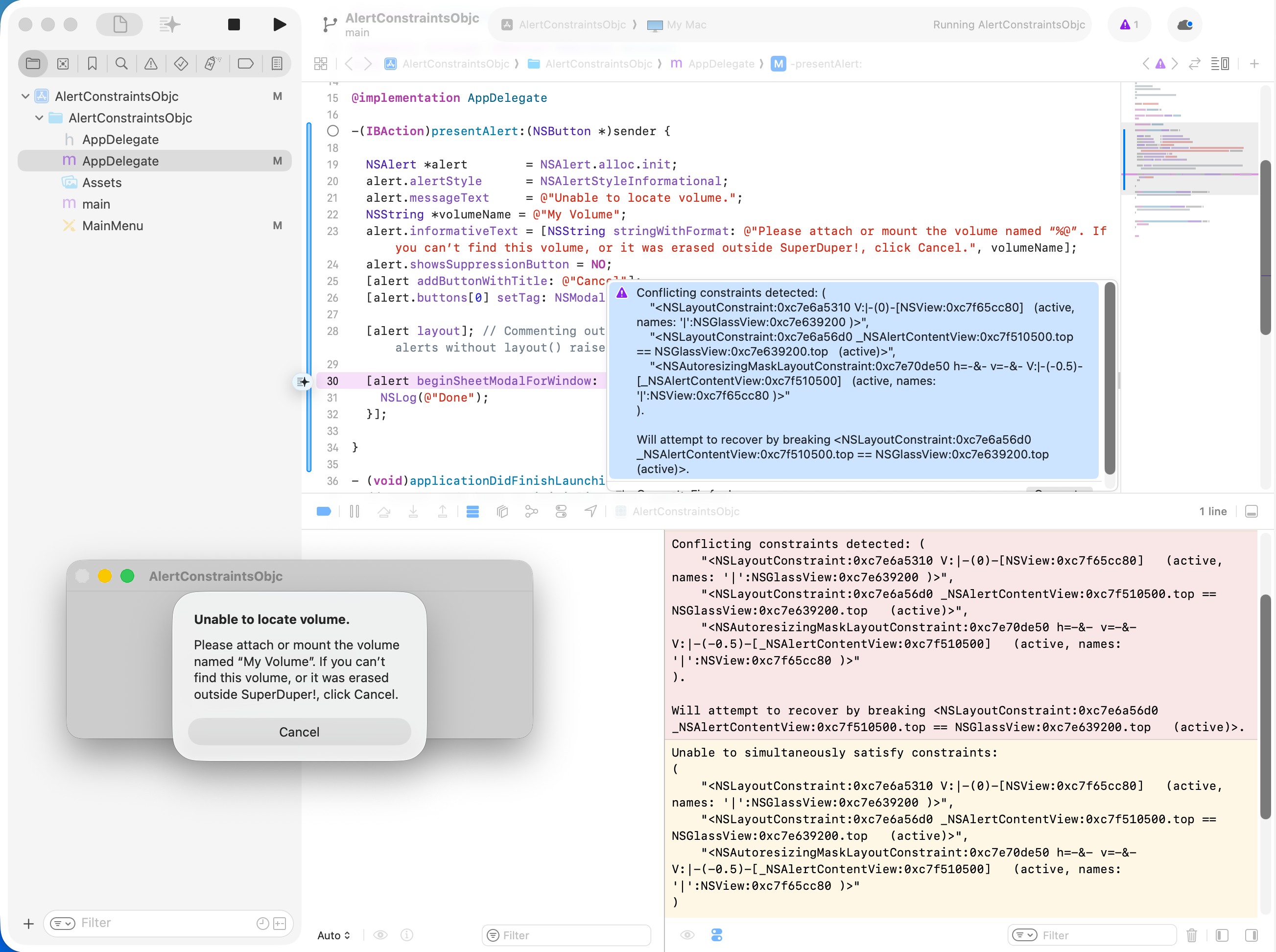

-(IBAction)presentAlert:(NSButton *)sender {
  NSAlert *alert        = NSAlert.alloc.init;
  alert.alertStyle      = NSAlertStyleInformational;
  alert.messageText     = @"Unable to locate volume.";
  NSString *volumeName = @"My Volume";
  alert.informativeText = [NSString stringWithFormat: @"Please attach or mount the volume named “%@”. If you can’t find this volume, or it was erased outside SuperDuper!, click Cancel.", volumeName];
  alert.showsSuppressionButton = NO;
  [alert addButtonWithTitle: @"Cancel"];
  [alert.buttons[0] setTag: NSModalResponseCancel];
  [alert layout]; // Commenting out this line of code will prevent the constraint exception but other alerts without layout() raise constraint violations
  [alert beginSheetModalForWindow: self.window completionHandler: ^(NSModalResponse returnCode) {
    NSLog(@"Done");
When [alert beginSheetModalForWindow: self.window...] is called, it raises the following conflicting constraint error.

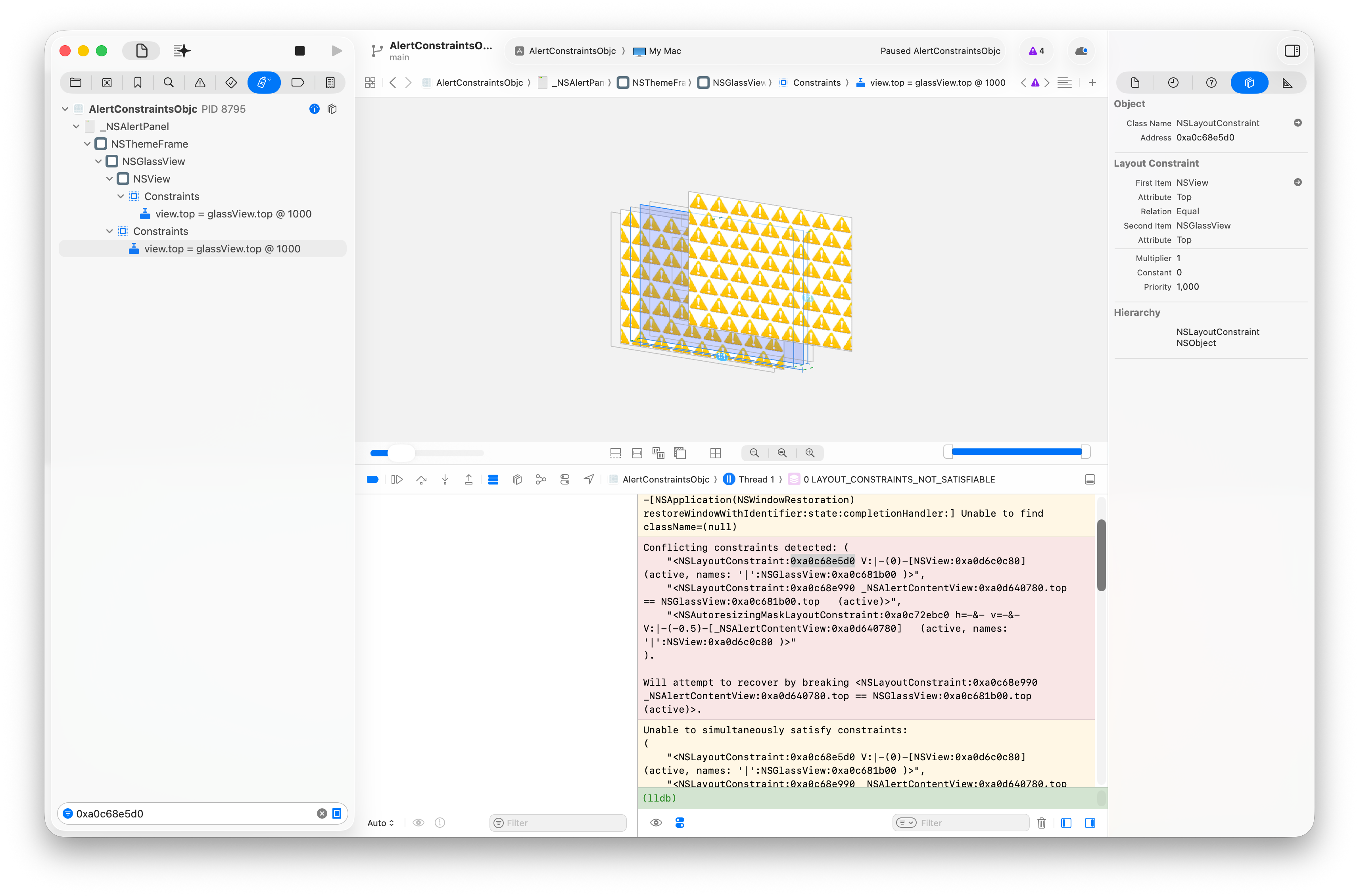

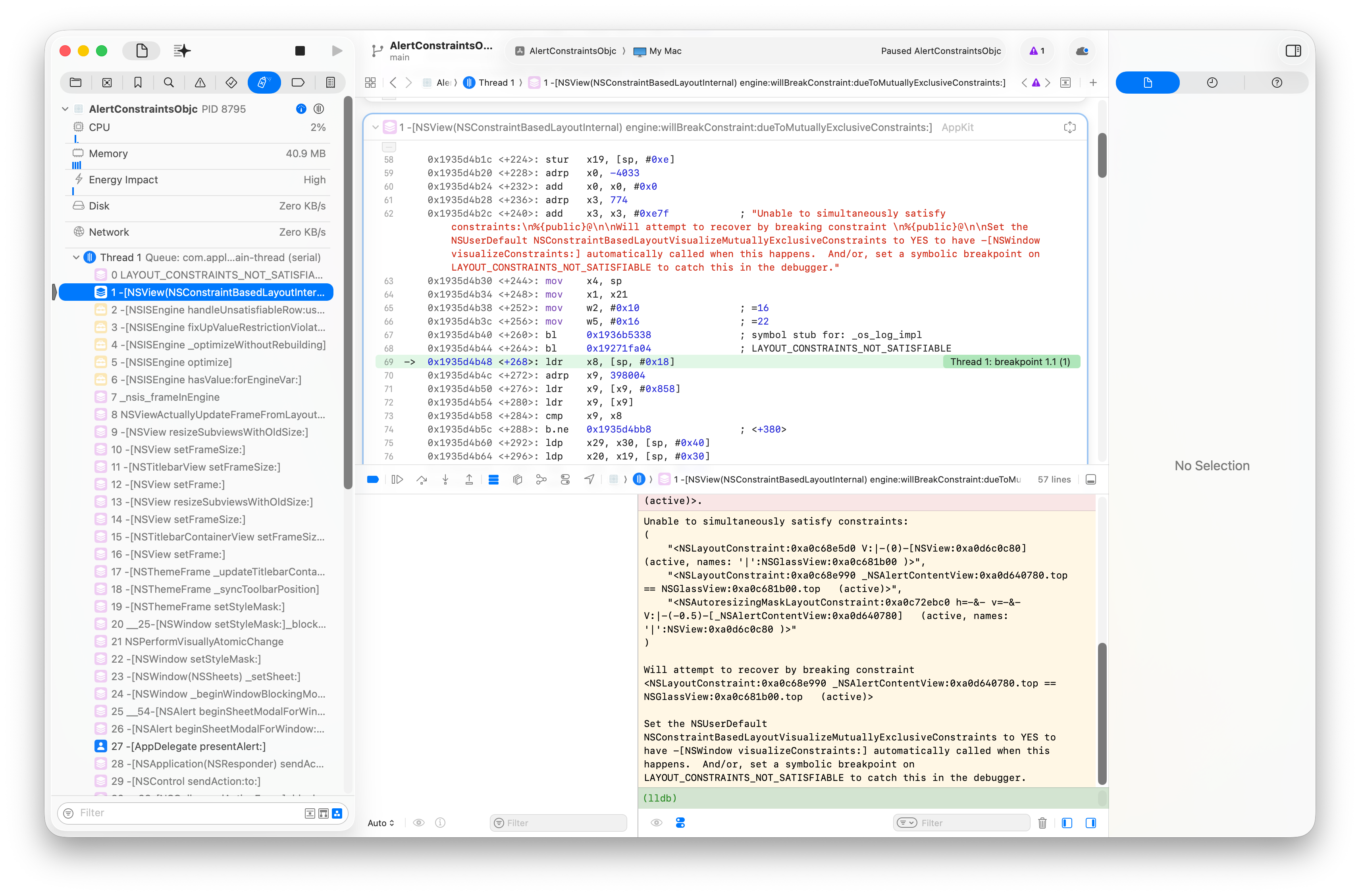

Setting a symbolic breakpoint on LAYOUT_CONSTRAINTS_NOT_SATISFIABLE shows that the constraint violation occurs within AppKit.
Furthermore, searching the view hierarchy for one of the violating constraints clearly shows that it is an auto layout constraint set by AppKit.
