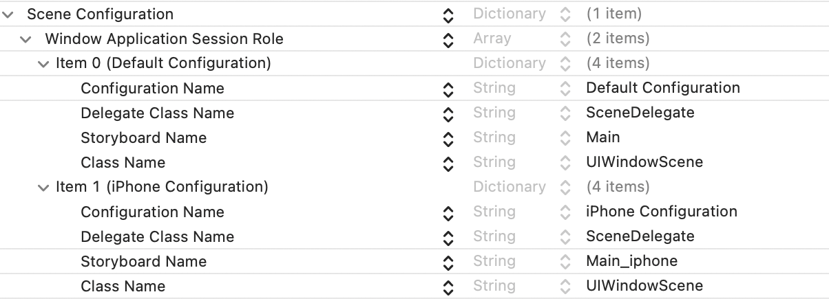

And I have two configurations in the plist:

Everything works fine, except when running the simulator for iPhone 16 Pro Max 18.2 where I get these errors:
AX Safe category class 'SLHighlightDisambiguationPillViewAccessibility' was not found!
Class CKBrowserSwitcherViewController overrides the -traitCollection getter, which is not supported. If you're trying to override traits, you must use the appropriate API. And no scene appears.
Update 2: I changed the Enable Multiple Windows to NO (I thought I might need it to be YES based on the thread here) and now AppDelegatge receives the configurationForConnectingSceneSession call and iPhone 16 Pro Max 18.2 works fine.
