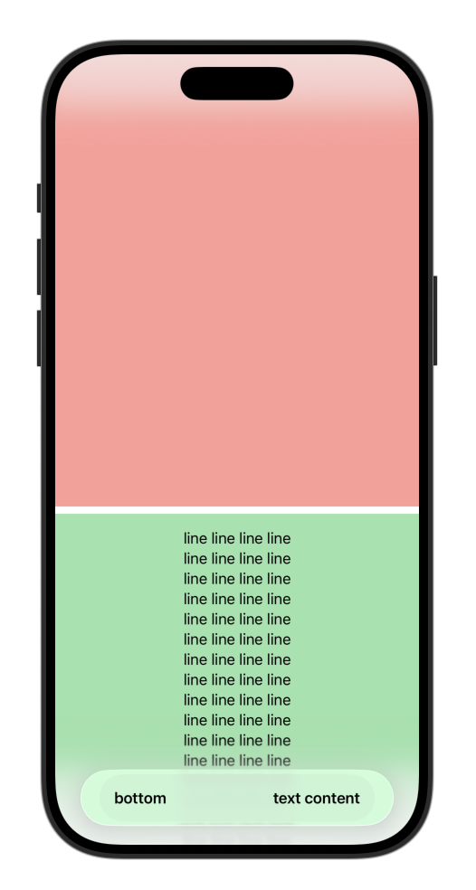

  • Screenshot 1: putting my custom view in a toolbar/ToolBarItem(placement: .bottomBar). This works only in NavigationStack, and it adds a glass pane that I do not want (I want to put a custom component there that already has correct glass pane)

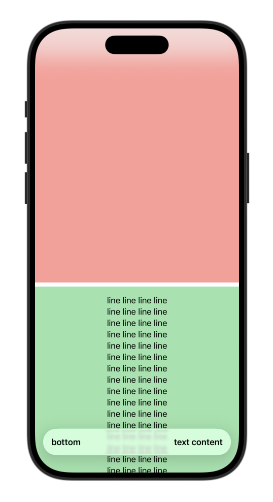

  • Screenshot 2: using safeAreaBar or safeAreaInset in any combination with NavigationStack and/or .scrollEdgeEffectStyle(.soft, for: .bottom). Shows my component correctly, but does not use fade-blur.

^ Screenshot 1
^ Screenshot 2
Test code:
struct ContentView2: View {
    NavigationStack {
      ScrollView(.vertical) {
        VStack {
          Color.red.frame(height: 500)
          Color.green.frame(height: 500)
      .ignoresSafeArea()
      .toolbar() {
        ToolbarItem(placement: .bottomBar) {
          HStack {
            Text("bottom")
            Spacer()
            Text("text content")
          .bold().padding()
          .glassEffect().padding(.horizontal)
Answered by BabyJ in 845632022
I believe the solution to this problem is to use the new safeAreaBar(edge:alignment:spacing:content:) view modifier, as suggested by its documentation and a comment made during the SwiftUI group lab.
However, I also believe that this modifier is currently broken (as of beta 2), because its behaviour seems to be no different to using safeAreaInset. I have filed feedback for this: FB18350439.
Could you try adding a Material to the background. That might get you close to what you need. for example:
NavigationStack {
    ItemsListView()
        .safeAreaBar(edge: .bottom) {
            BottomBarView()
                .background(.regularMaterial)
