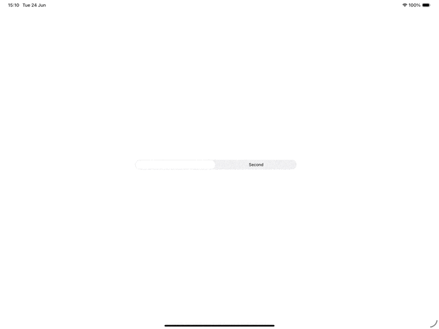

While testing my application on iOS beta 26, I am experiencing issues with the native UISegmentedControl component from UIKit. After implementing the control, I noticed that I am unable to switch to the second segment option—the selection remains fixed on the first segment regardless of user interaction. I have already reviewed the initial configuration of the control, the addition of the segments, and the implementation of the target-action, but the issue persists. I would like to understand what could be causing this behavior and if there are any specific adjustments or workarounds for iOS 26.
I created a minimal application containing only a UISegmentedControl to clearly demonstrate the issue.
