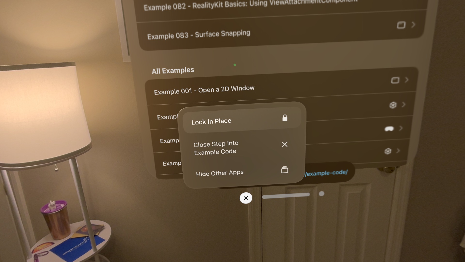

Can we access a "Locked in Place" value when a window has been locked without being snapped to a surface?
Starting in visionOS 26, users can snap windows to surfaces. These windows are locked in place and are later restored by visionOS. We can access the snapped data with surfaceSnappingInfo docs.
Users can also lock a free-floating (unsnapped) window from a context menu in the window controls.
Is there a way to tell when a window has been locked without being snapped to a surface?
