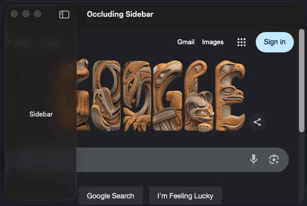

Now, the page content takes up the full width of the NavigationSplitView and the sidebar hovers over the page content with a translucent effect. This is in spite of setting .navigationSplitViewStyle(.balanced). Code below.
I believe this is a problem with the new WebView not respecting size hints from parent views in the hierarchy. This is because if I replace the WebView with a centered Text view, it shifts over correctly when the sidebar is opened.

Here is a screenshot of the WebView remaining in place after the sidebar opens on top of it.
Found a workaround by adding a Spacer to the left of the WebView. The Spacer seems to respond to the sidebar and push the WebView out from under the sidebar.
