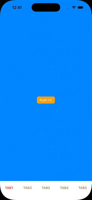

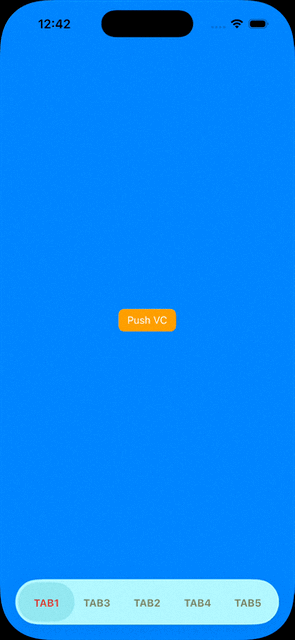

screen recording
Your screenshots are showing a tab bar. hidesBottomBarWhenPushed is for hiding a toolbar.
