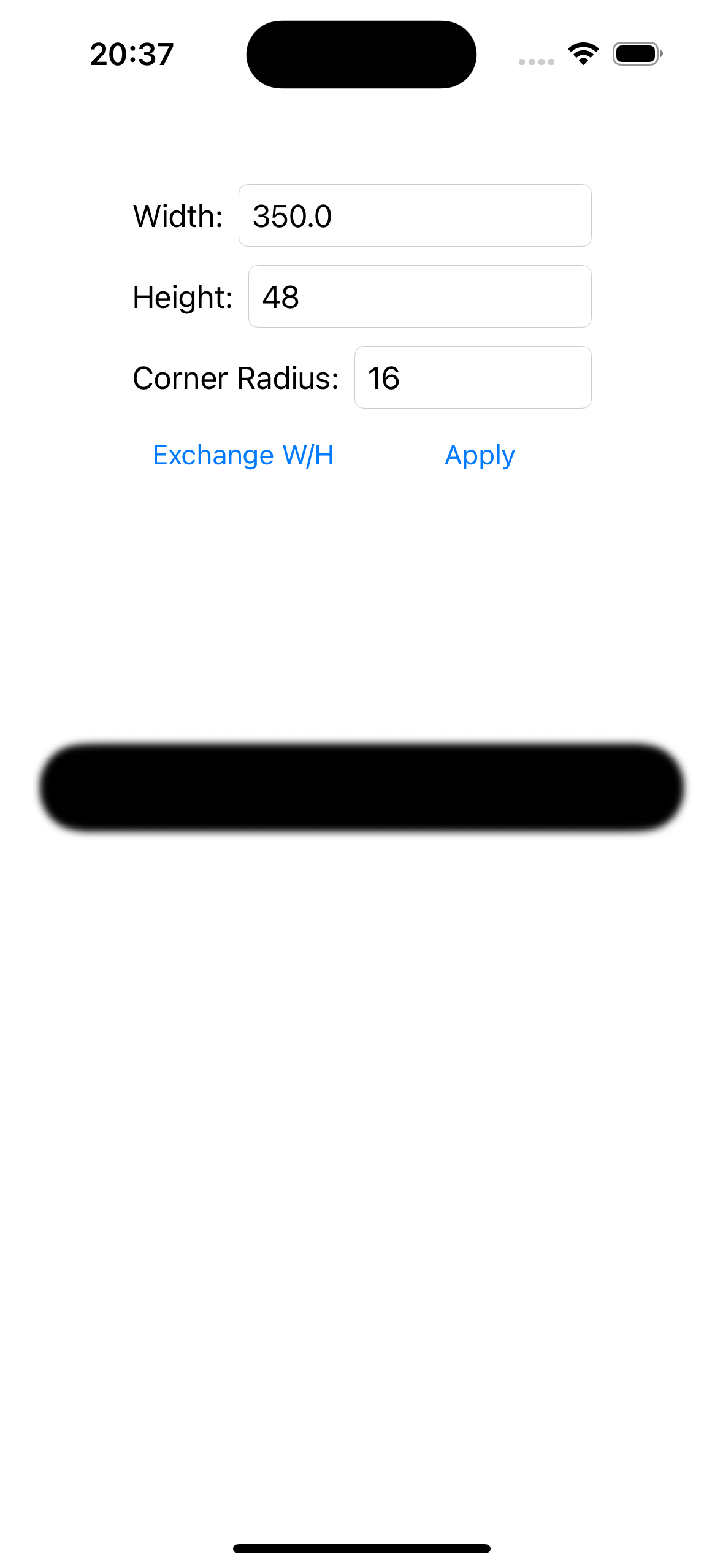

min.length == 48min.length == 49

Please note: My initial interpretation of the CGPath differences in the 'Evidence: CGPath Analysis' section below seems to have been based on a misunderstanding of the exact path changes.
To provide a more precise analysis and ensure clarity, I'm re-attaching the full po {shadowPath} output for both cases below.
Original Path Descriptions
Here are the original Path descriptions you provided, which were used for the analysis.
