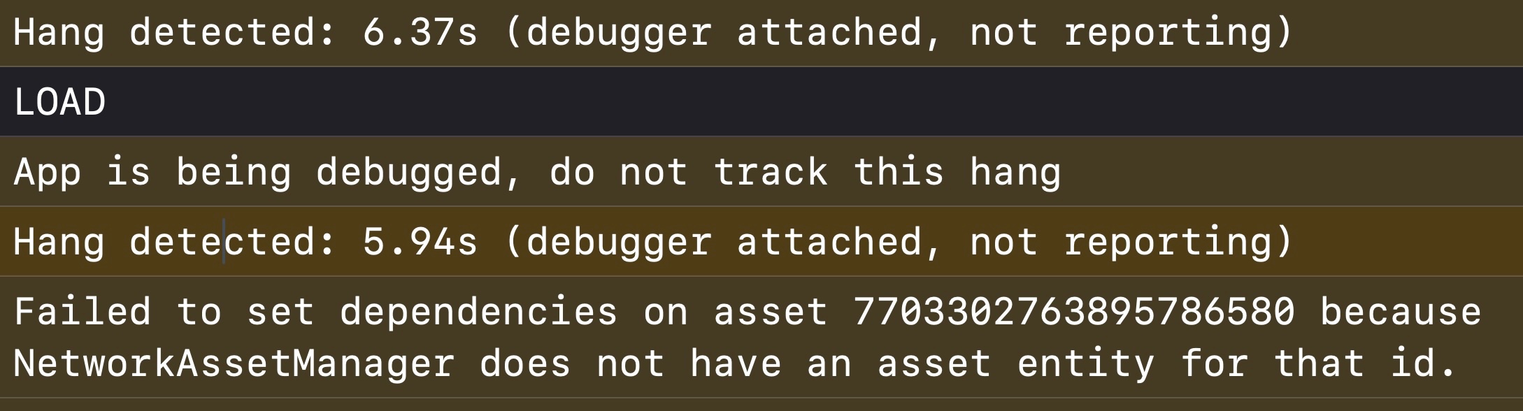

With Xcode 26, loading ressources with RealityKit is extremely slow.
Here my project takes almost 50 seconds to load. I also get multiple Hang detected messages in the console:
When I uncheck "Debug executable" in the schema, the same project loads in 2 seconds.
I'm using RealityKit asynchronous loading:

In case my message was not very clear, the issues occur when I run the app on the Vision Pro in Debug. In that case the app takes 50 seconds to load ressources versus 2 when I uncheck "Debug executable" in the scheme.
