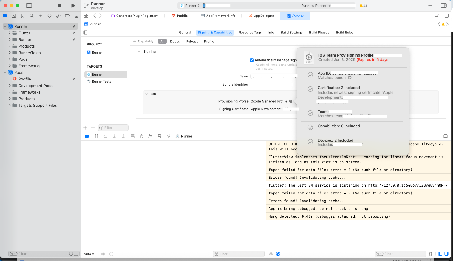

I've attached a screenshot of my Xcode signing settings and provisioning profile information for reference. Please note that sensitive values have been hidden.
