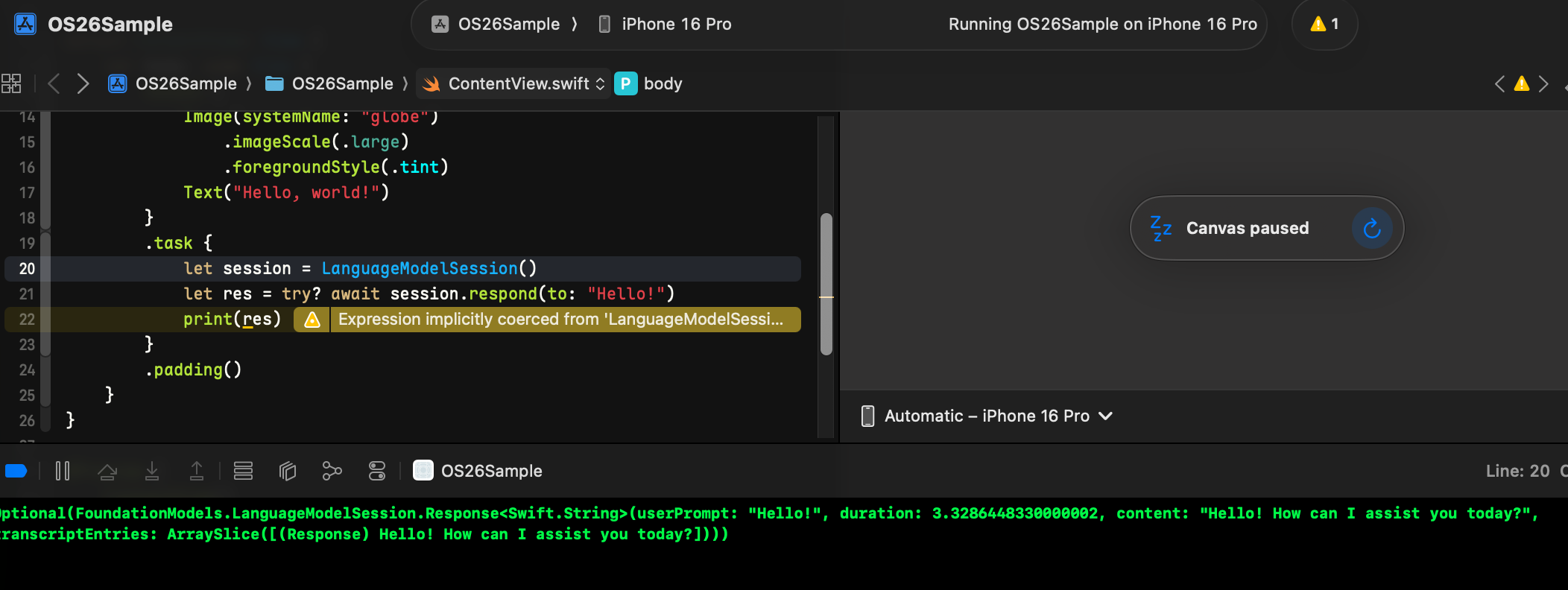

I can confirm that the iPhone simulator (with iOS 26 of course, as the whole FoundationModels framework is for 26.0+) running under an Apple Intelligent enabled macOS 26 supports it well.

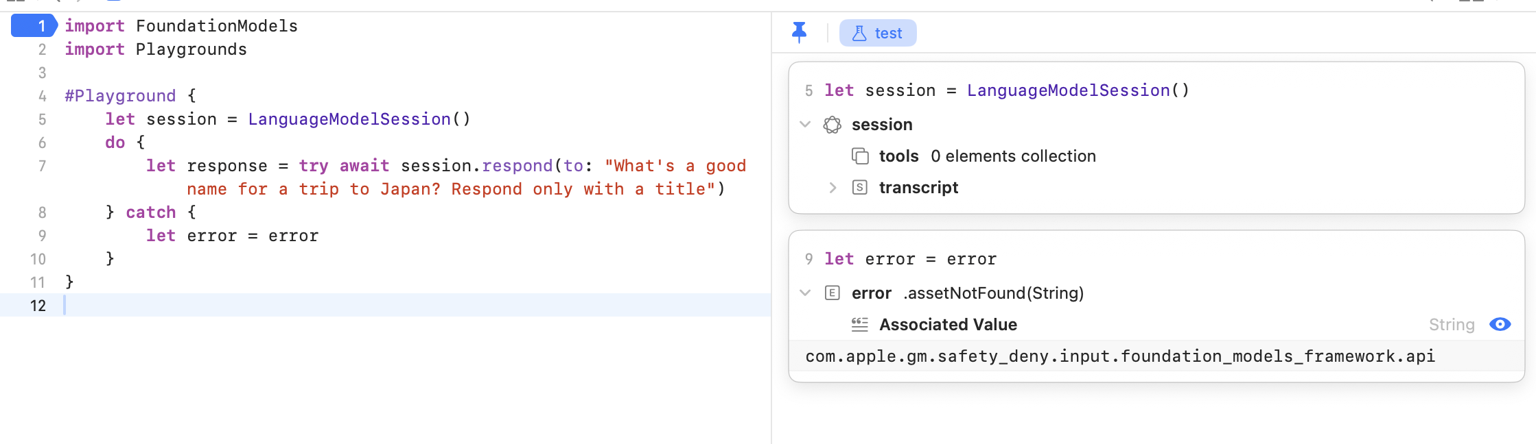

I am running MacOS Tahoe 26.0 (beta) and Xcode beta that dropped 2 days ago.
My Mac has a M2 Max chip. I run the following code in the playground:
import FoundationModels let session = LanguageModelSession() let response = try await session.respond(to: "Making homemade bread")
and I get the following in the error:
Playground execution failed:
error: execution stopped with unexpected state. error: Execution was interrupted. The process has been left at the point where it was interrupted, use "thread return -x" to return to the state before expression evaluation.
The results on the right say: Failed to find toy.
