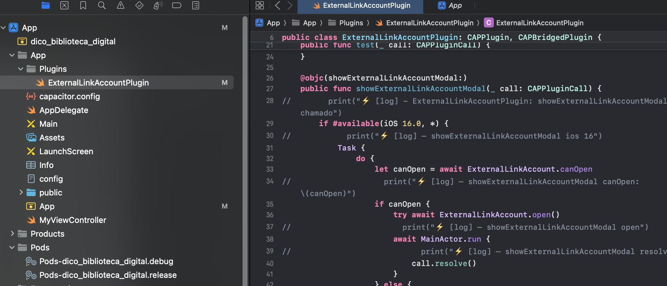

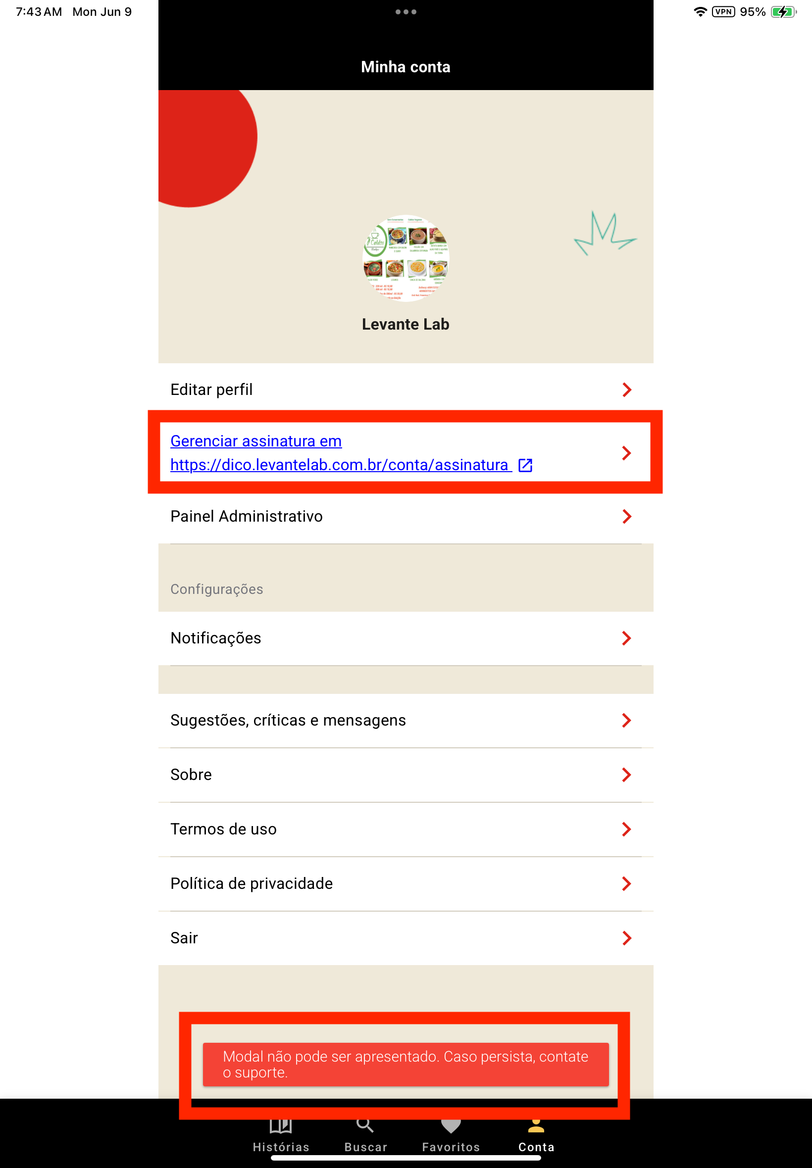

I have implemented the External Link Account API. When I click on "Gerenciar Assinatura em...", I use the External Link Account API to check if the modal is available (using ExternalLinkAccount.canOpen()). I always get "false".
my plugin in swift:
my app:

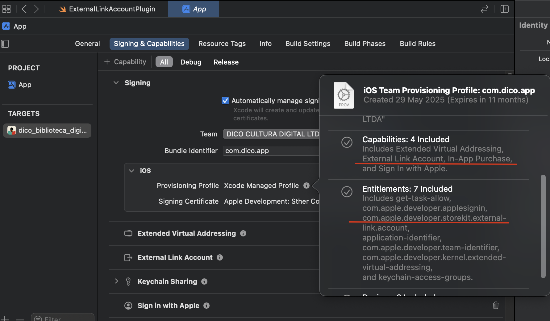

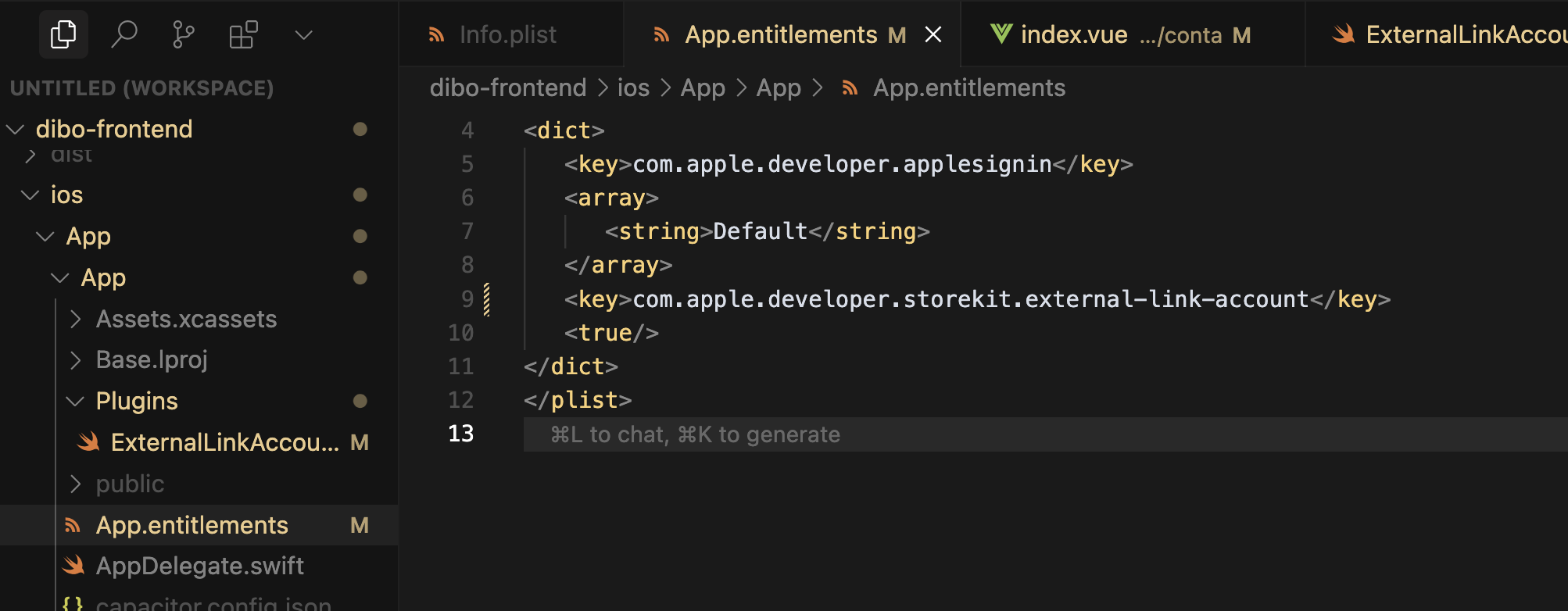

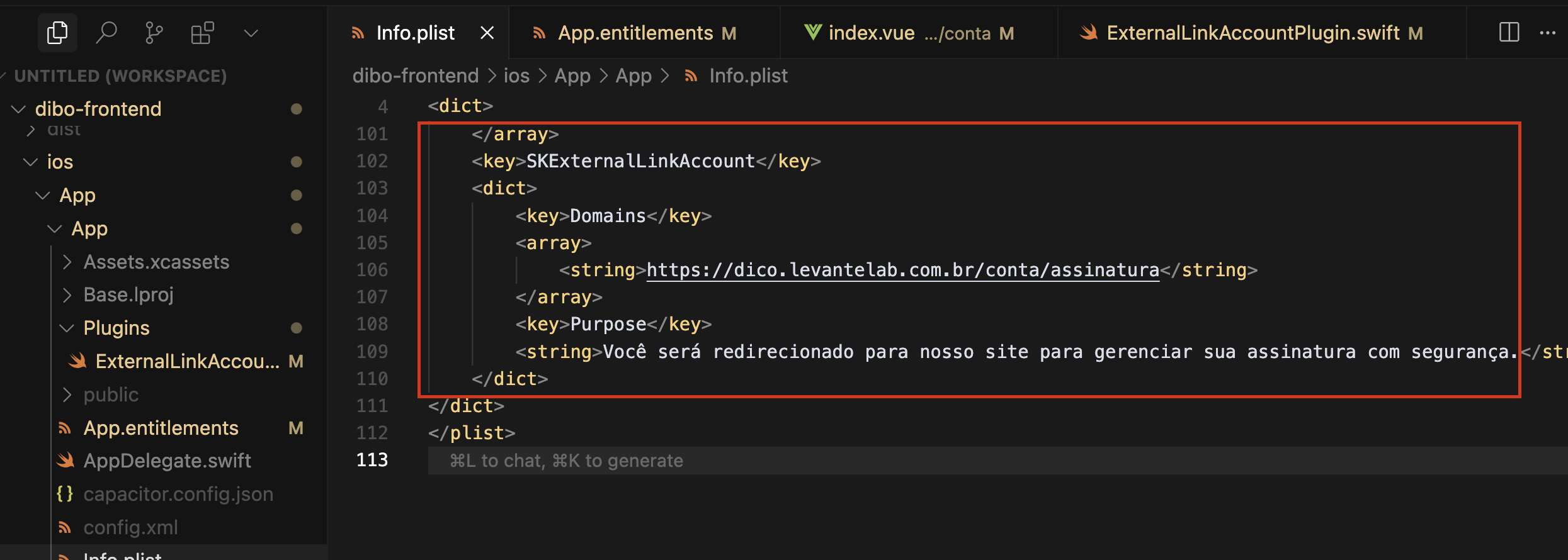

I believe this is due to the fact that I am in a development environment. My project is configured correctly in the following files: info.plist and App.entitlements. I also have the authorization in my profile visible in Xcode. I have attached screenshots for validation. The question is: should the External Link Account API work in a test environment? I am testing the build in Xcode with a physical iPhone with iOS 18.
file info.plist:
file App.entitlements:
xcode with authorization in my profile:

  1. The configuration of the SKExternalLinkAccount key is incorrect in your Info.plist. It should look as follows:
<key> SKExternalLinkAccount</key>
	<dict>
		<key>*</key>  <string>https://dico.levantelab.com.br/conta/assinatura</string>
	</dict>
For more information, see the discussion section of SKExternalLinkAccount.
  1. After fixing the configuration, try again. If the issue still occurs, file a Feedback report using Feedback Assistant.
