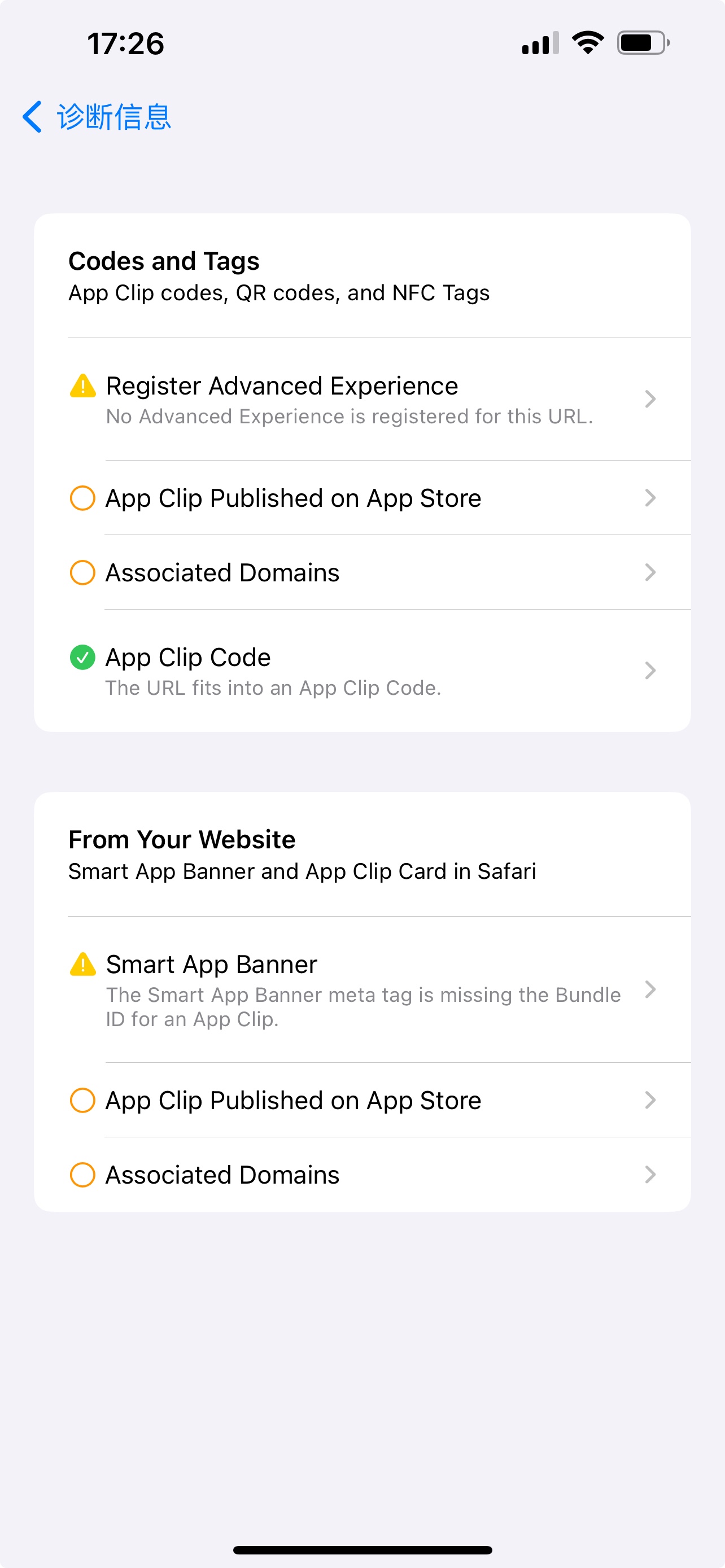

  1. When scanning a QR code pointing to outs domain on an iPhone The App Clip card does not appear.
2.Using the Developer > App Clip Experiences > Diagnostics tool on iPhone, entering the domain returns: "No Advanced Experience is registered for this URL."
I’m very confused about why the device behavior doesn’t match the configuration status in App Store Connect. Any insight or suggestions would be greatly appreciated!
Turns out the issue was just a delay. The Advanced App Clip Experience started working a few days after I set it up.
